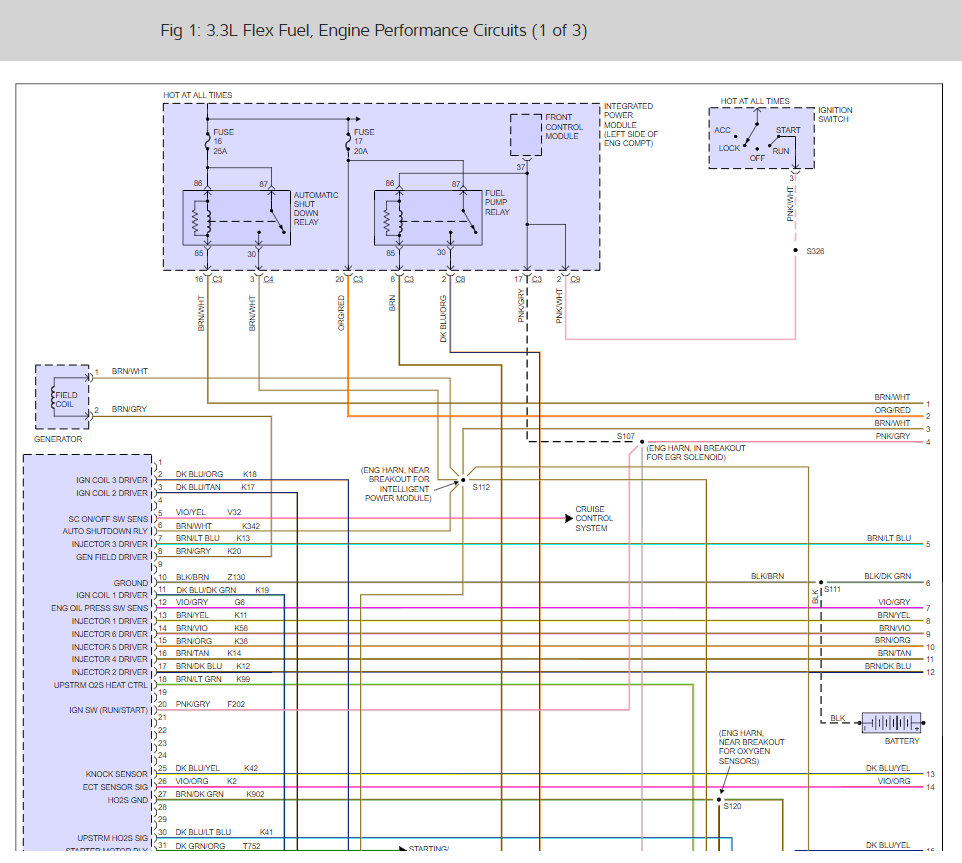

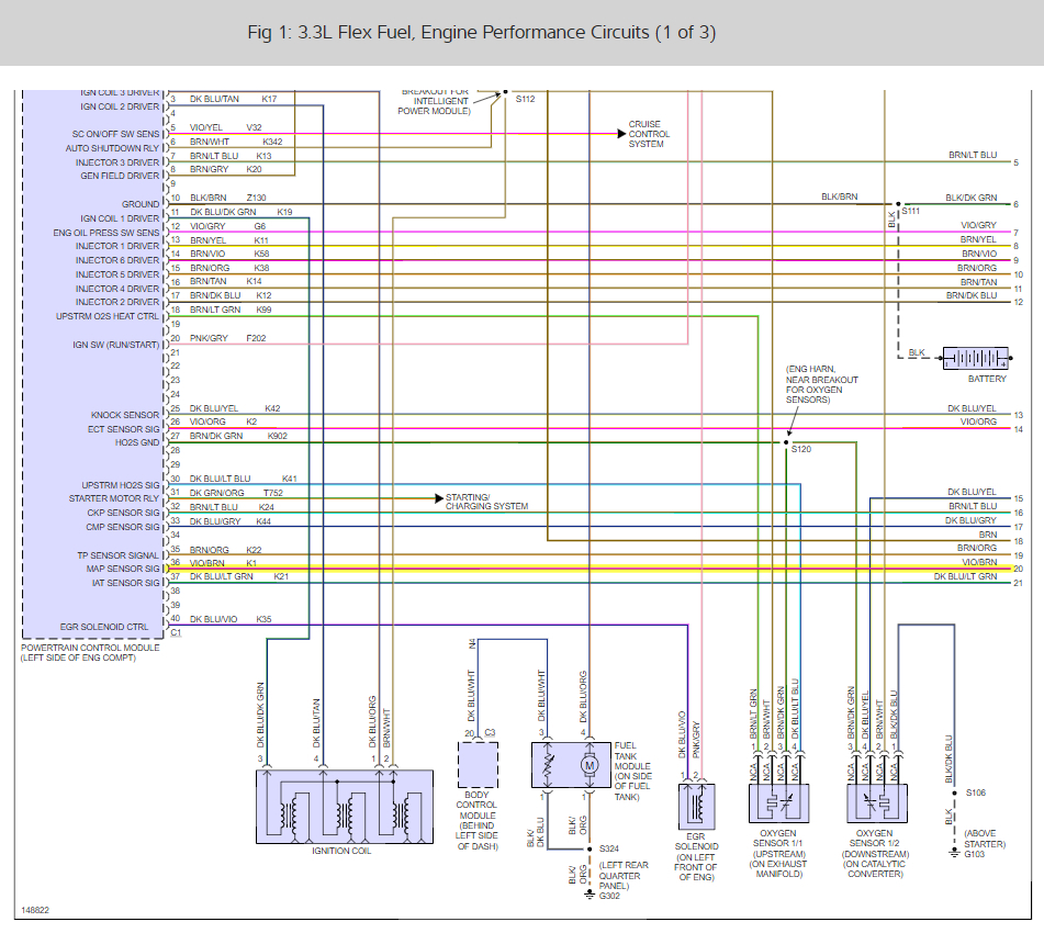

I went to leave for work, she started fine got to the corner two hundred feet from my drive way. Once the light changed i tried to go and she had stalled out. Pushed her back to the house. When i turn the key sounds like she is trying to start but no spark. Fuel pump is good , injectors good, battery good, starter is good, spark plugs good. Replaced the ignition coil and the cam shaft sensor, still doing the same thing. Only thing showing up on code scan is the IATS. Any ideas would really help.

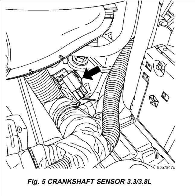

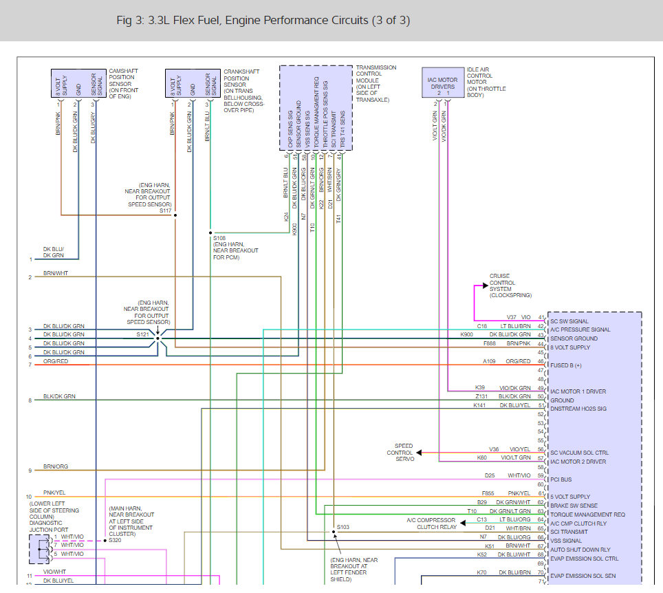

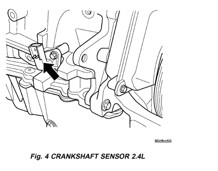

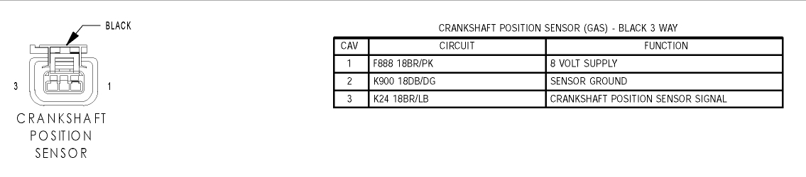

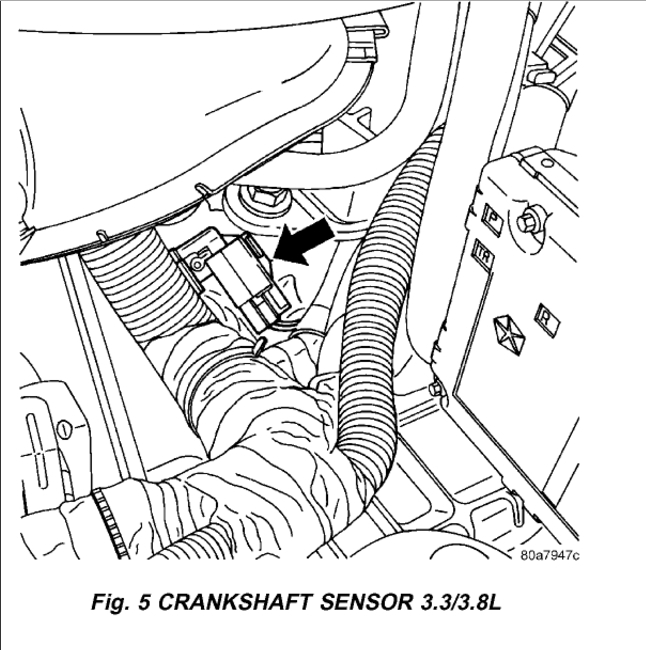

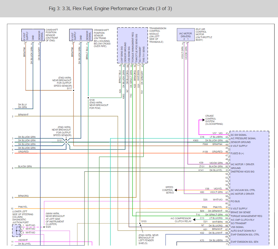

It sounds like you have a crankshaft angle sensor going out which may or may not set a trouble code.

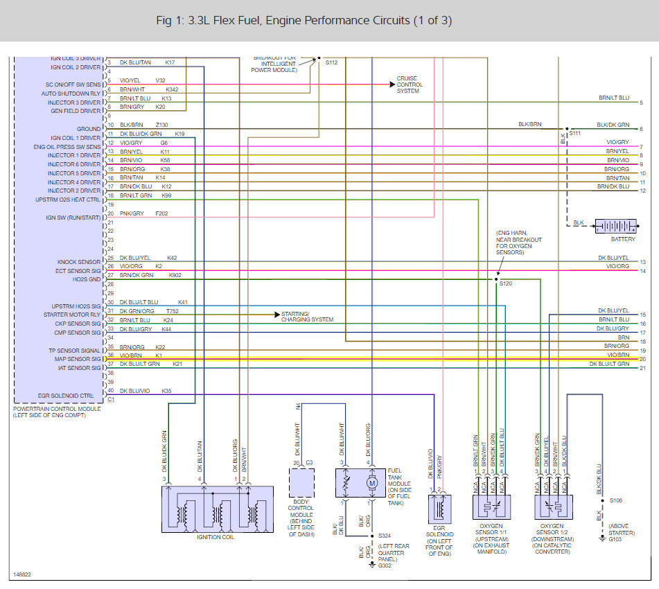

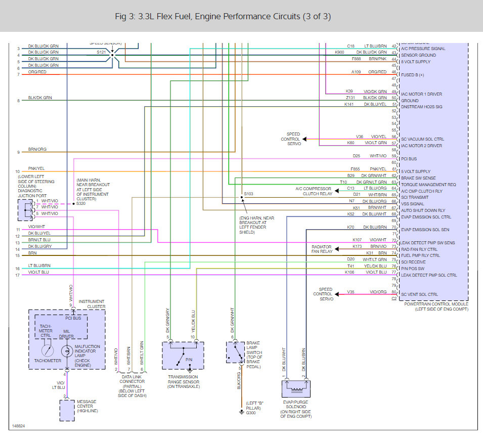

These sensors will make the engine stall without warning. Here are a could guides and some diagrams (Below) that will help you see whats going on.
and
https://www.2carpros.com/articles/engine-stalls
and

Replaced the crankshaft sensor... Still same sound of it trying to turn over but no spark. Real head ache of an issue.

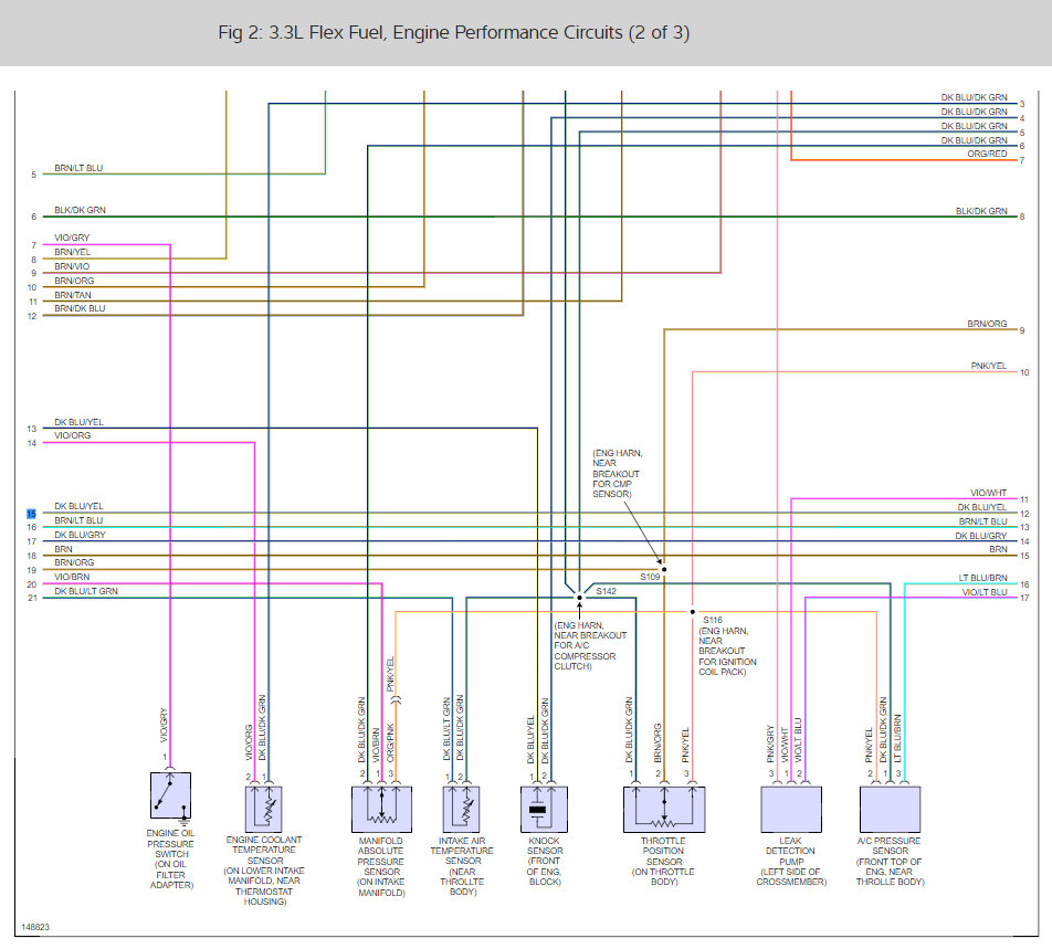

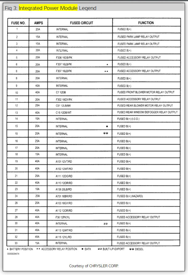

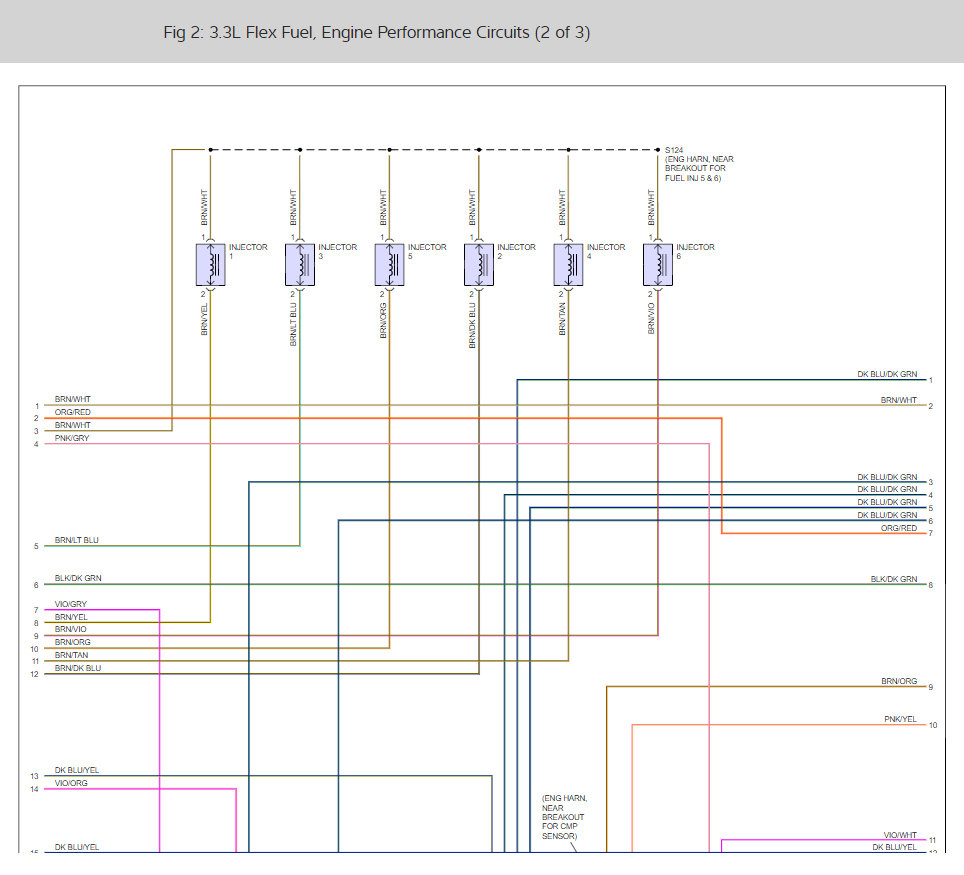

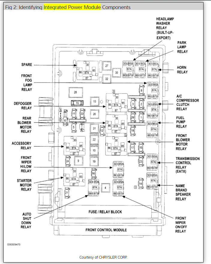

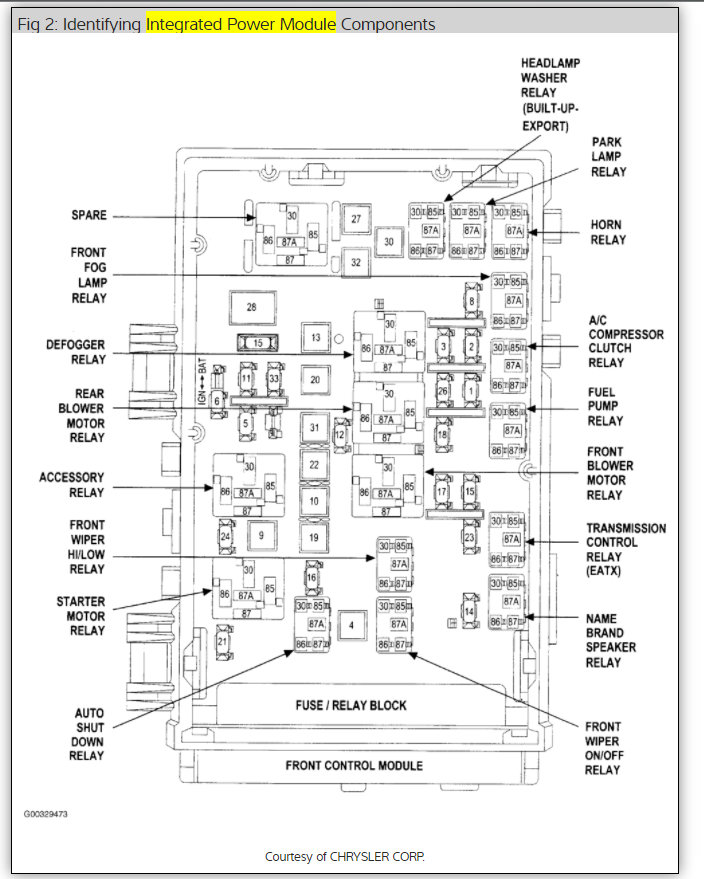

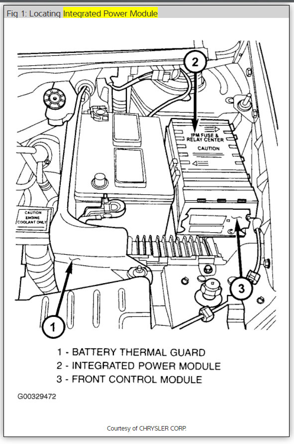

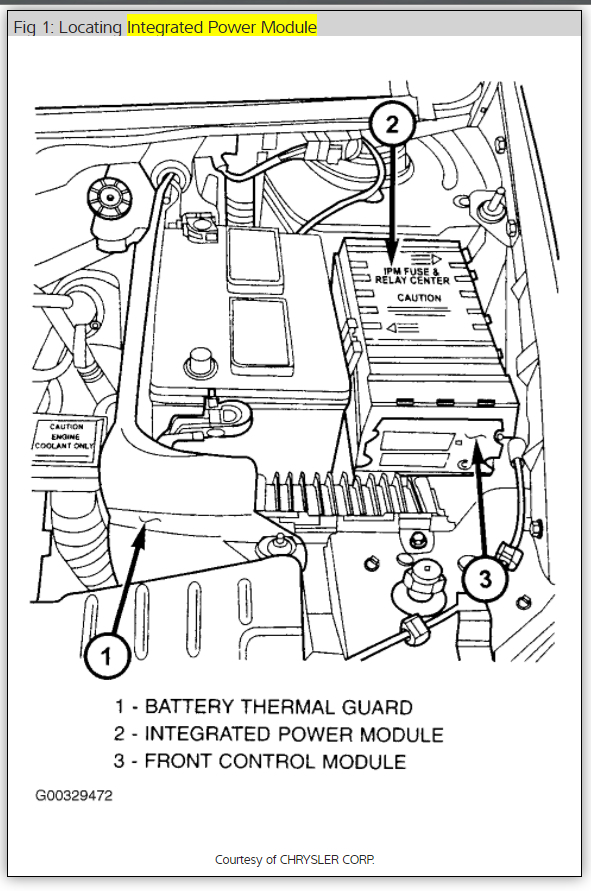

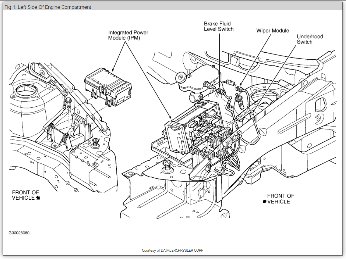

I am thinking the auto shut down relay can cause this problem. Here is a guide and some diagrams so you can do some testing.
and'
Sep 26, 2017 at 3:27 AM
