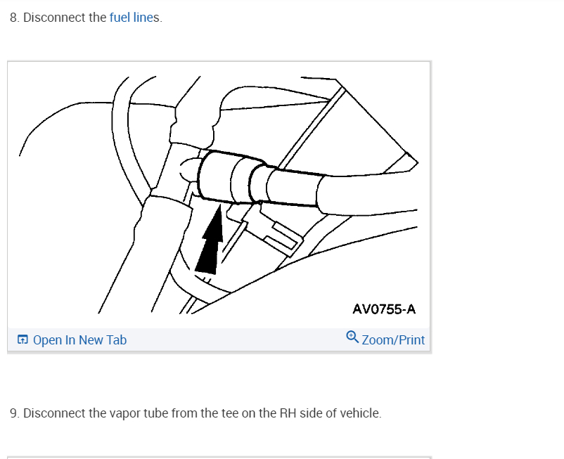

Okay, so we've replaced crank sensor, fuel filter, was going to replace fuel pump but it works I can hear it but not priming, and then I go out turn the wheel slightly to the left and it will start right up and then after 2 hours go out and it will turn over but not start. help
Dec 29, 2022 at 1:23 PM
  • 55,224 POSTS

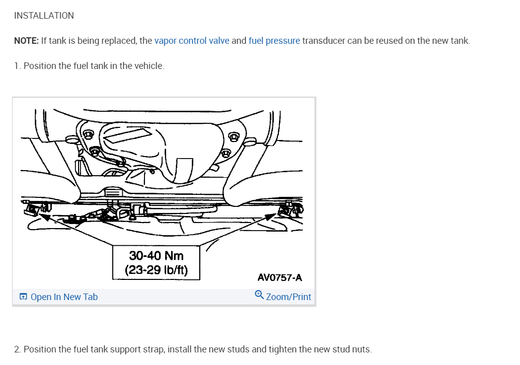

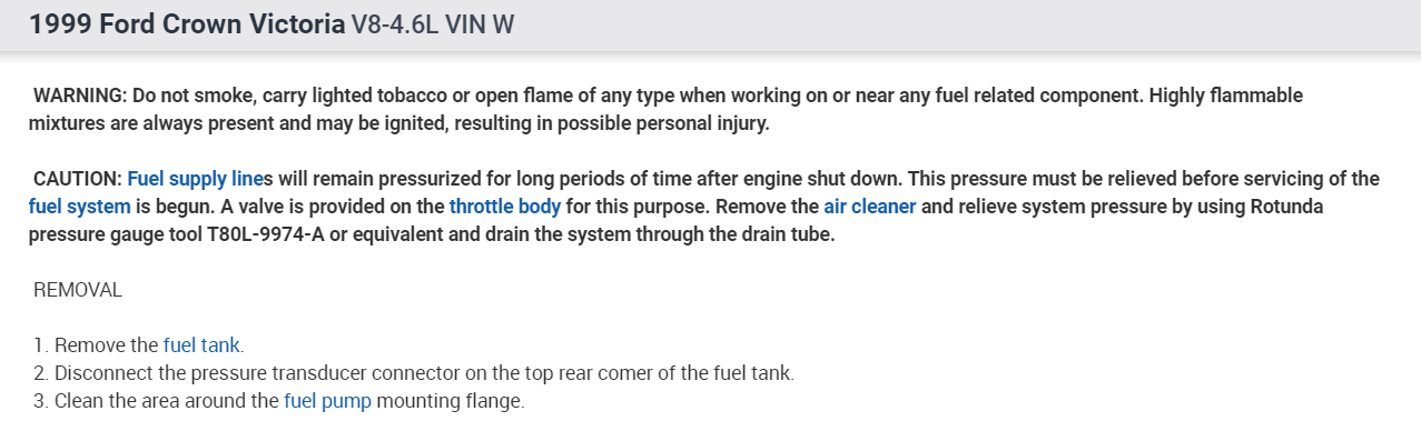

If the fuel pump has no pressure the engine will not start. This guide will show you how to check the pressure and you can rent a fuel gauge from the auto parts store for free or cheap and this guide will help you step by step.
Engine Running Fuel Pressure 210-310 kPa
Key On, Engine Off Fuel Pressure 240-310 kPa
This guide can help as well:
https://www.2carpros.com/articles/car-not-running-advanced

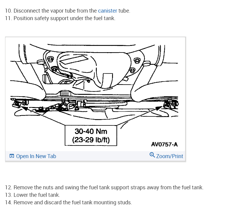

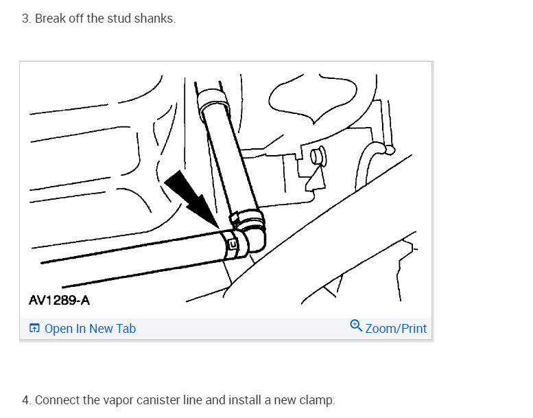

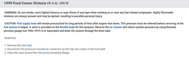

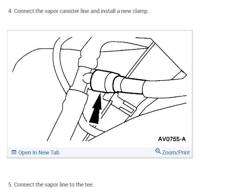

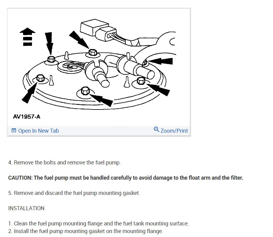

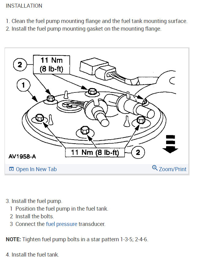

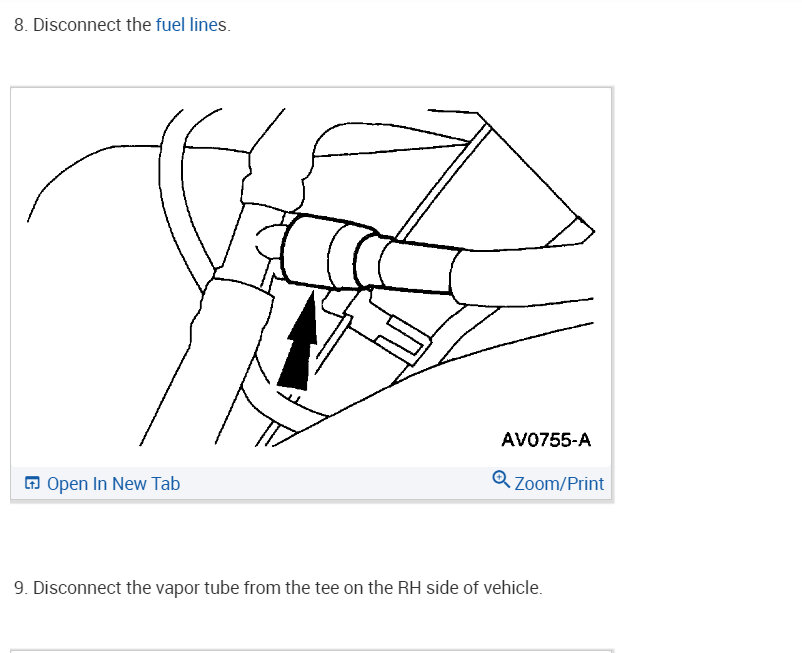

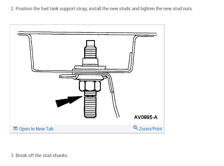

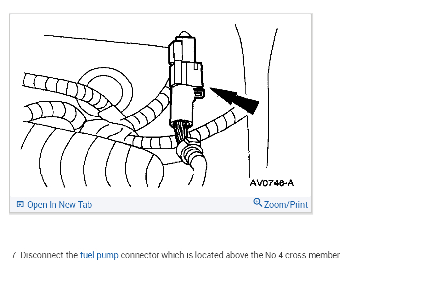

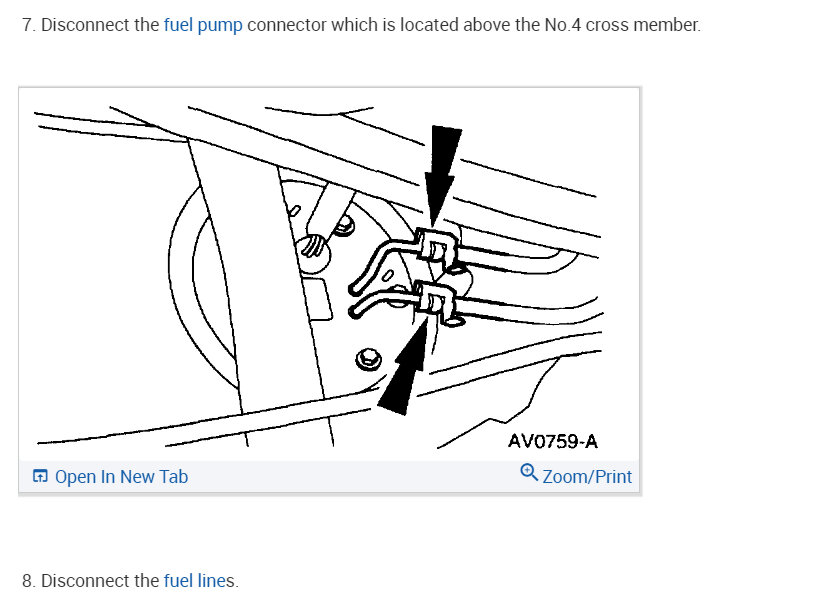

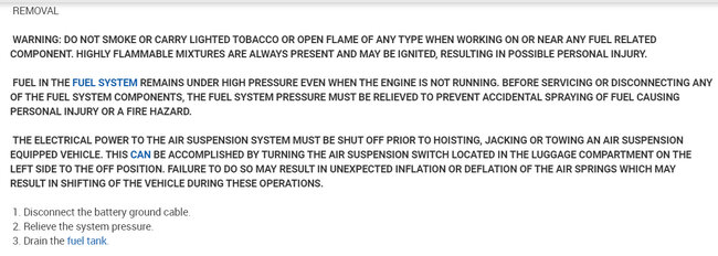

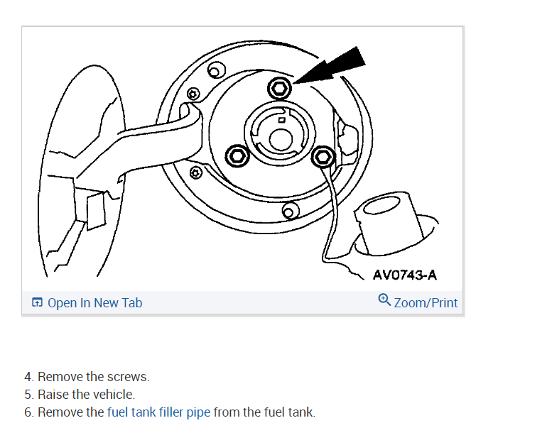

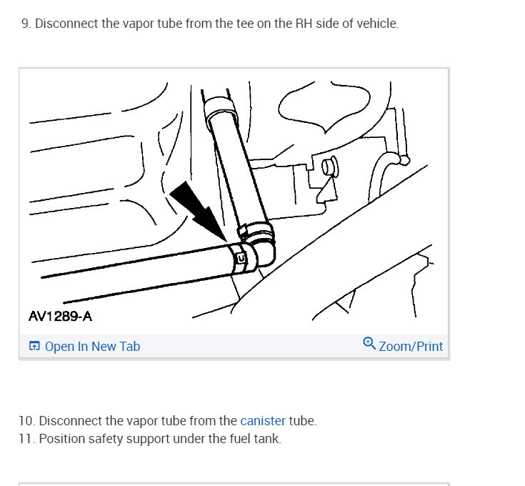

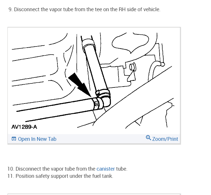

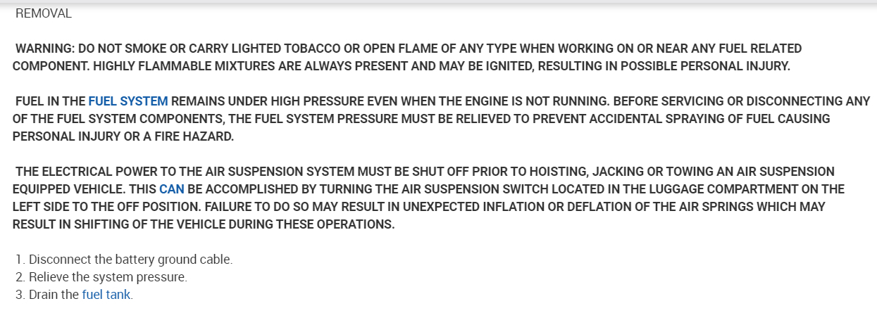

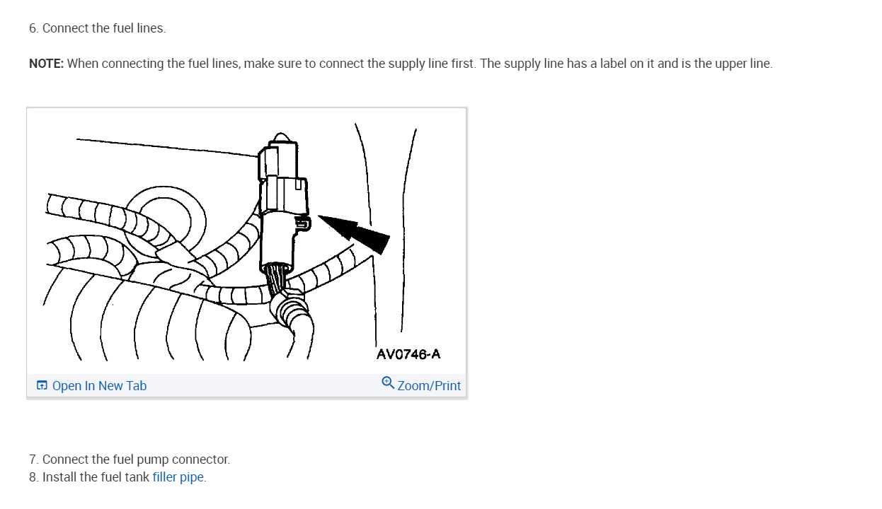

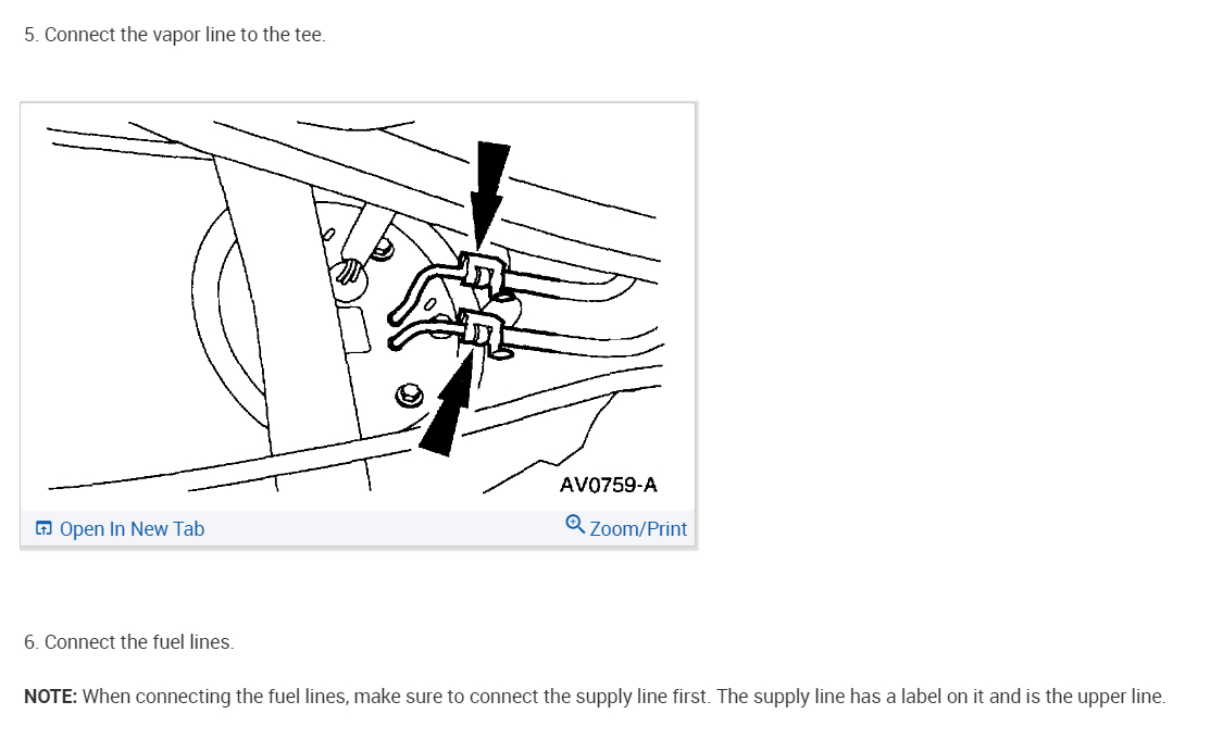

I have included how to change the fuel pump out in case you need it. You will need to drain the tank first, this video will help:
https://youtu.be/Q5MH2gnyFH0
Check out the images (below). Please let us know what you find. We are interested to see what it is.
