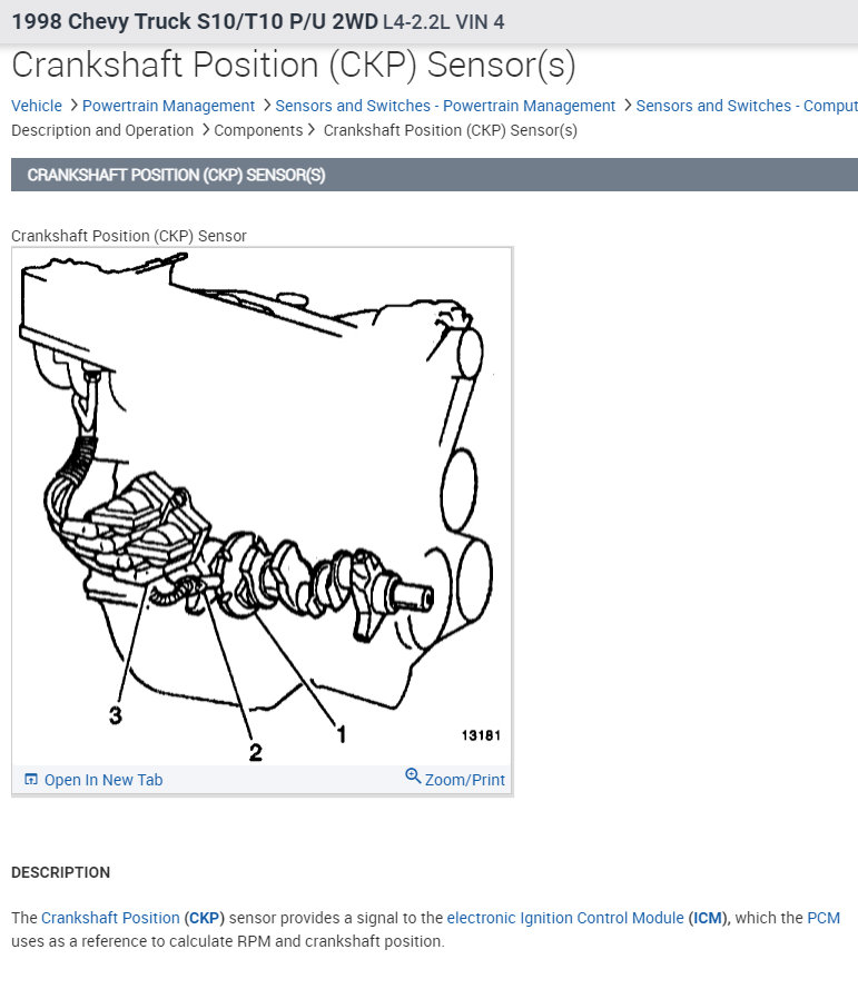

Truck would run a little warm and the temperature drop back down. it shut off while driving an hasn't started since. No oil in water or water in oil. what could it be?

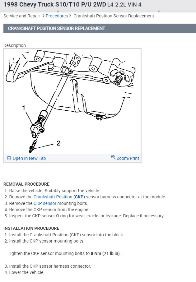

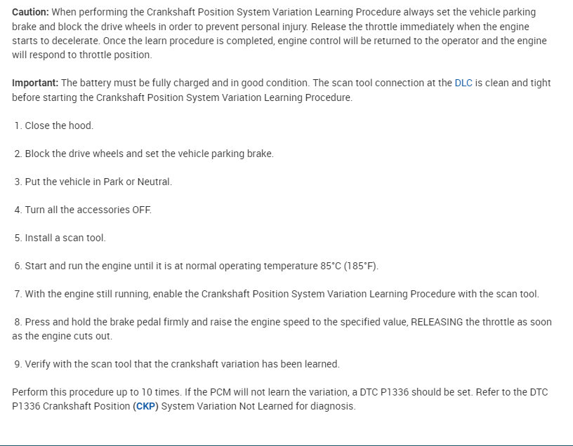

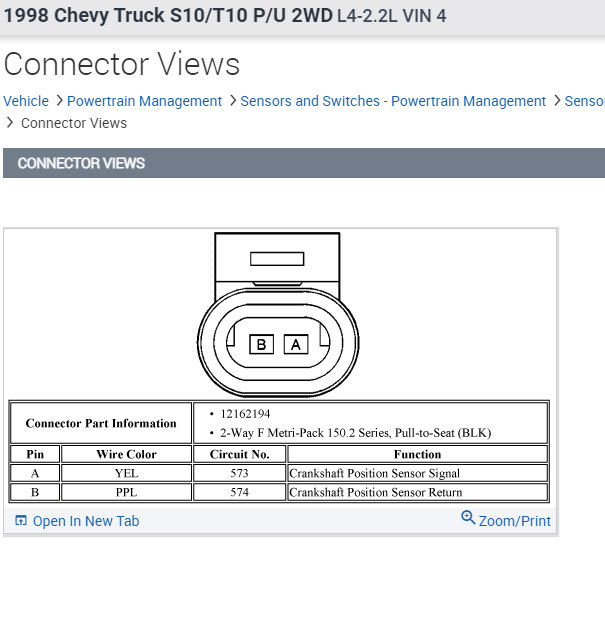

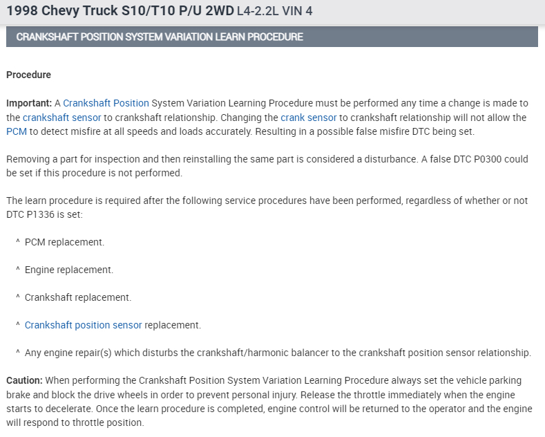

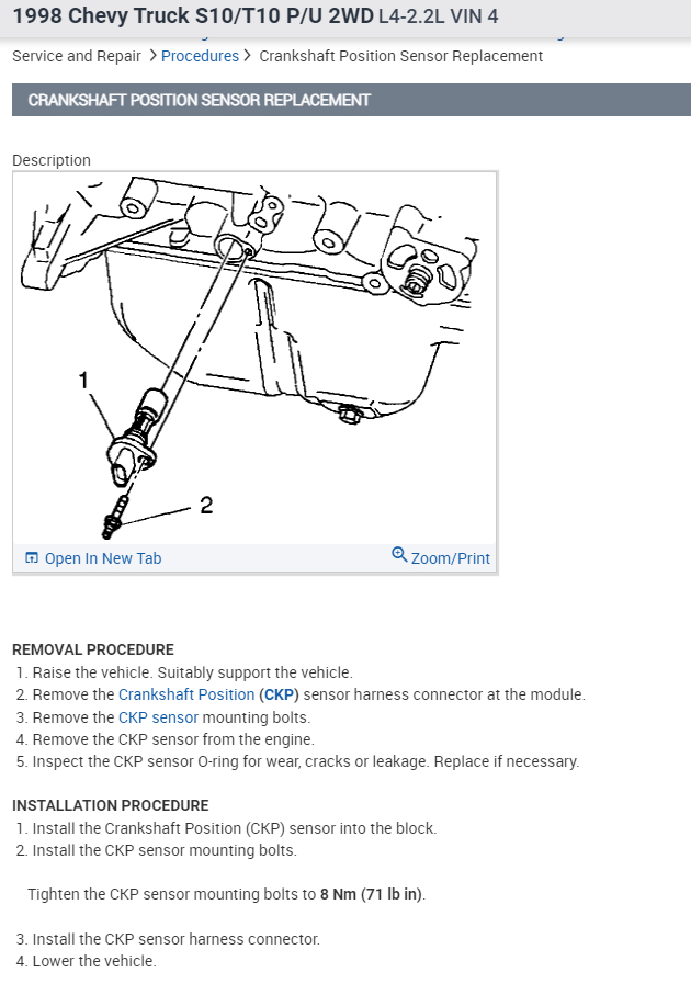

Typically, shutdown during driving points to a faulty crank position sensor. When the crank sensor malfunctions it will send error messages to the ECM and that will trigger an engine shut down. After the stall you may or may not be able to start the engine. The crank sensor is located on the right-hand side of the engine, below the coil packs. The crank sensor does require to be programmed when replaced.
Is your check ending light illuminated? If so, retrieving the codes can help with the diagnostics.
