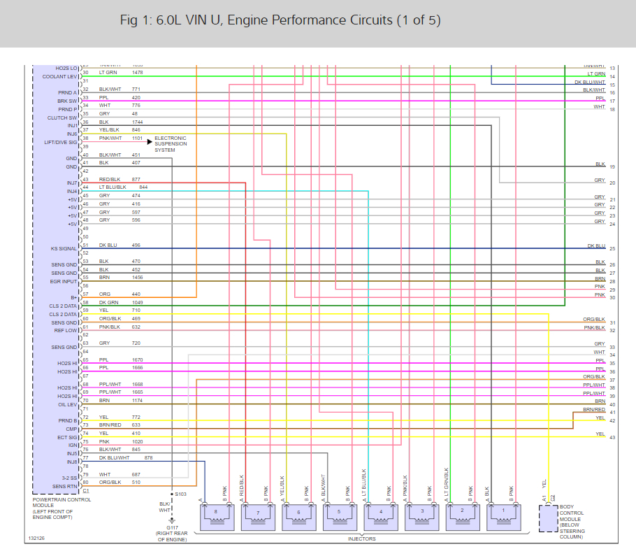

It will turn over like it is going to start, but does not. Three days ago I pulled out my driveway put it it in drive pushed gas petrol and acted as if I ran out of gas and shut off. Hasn't started since. I have checked spark plugs, changed coil, ignition control module, crank sensor, checked voltage. Still not starting. Tested distributor, and button. Please help

I have done everything you said. Still nothing. No spark no start. Replaced ICM, distributor cap button mass Air flow spark plugs wires.tested everything.

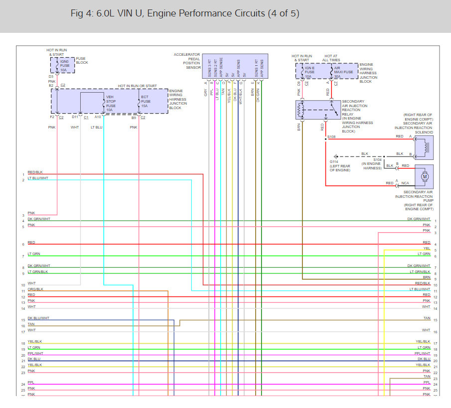

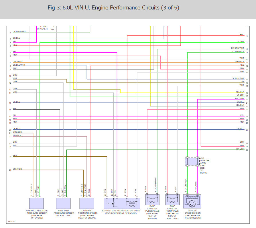

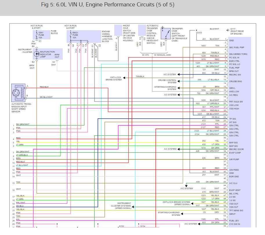

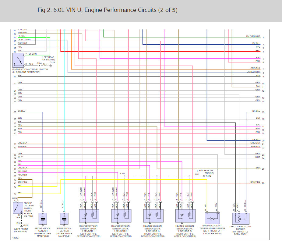

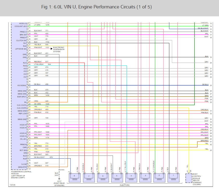

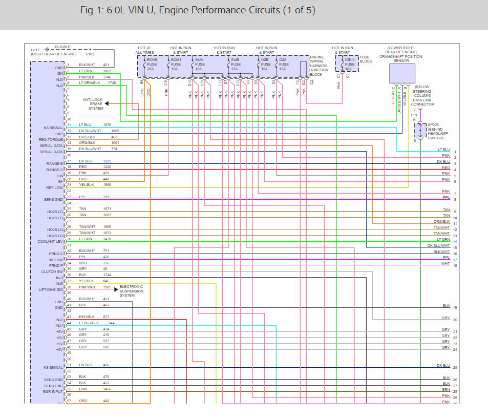

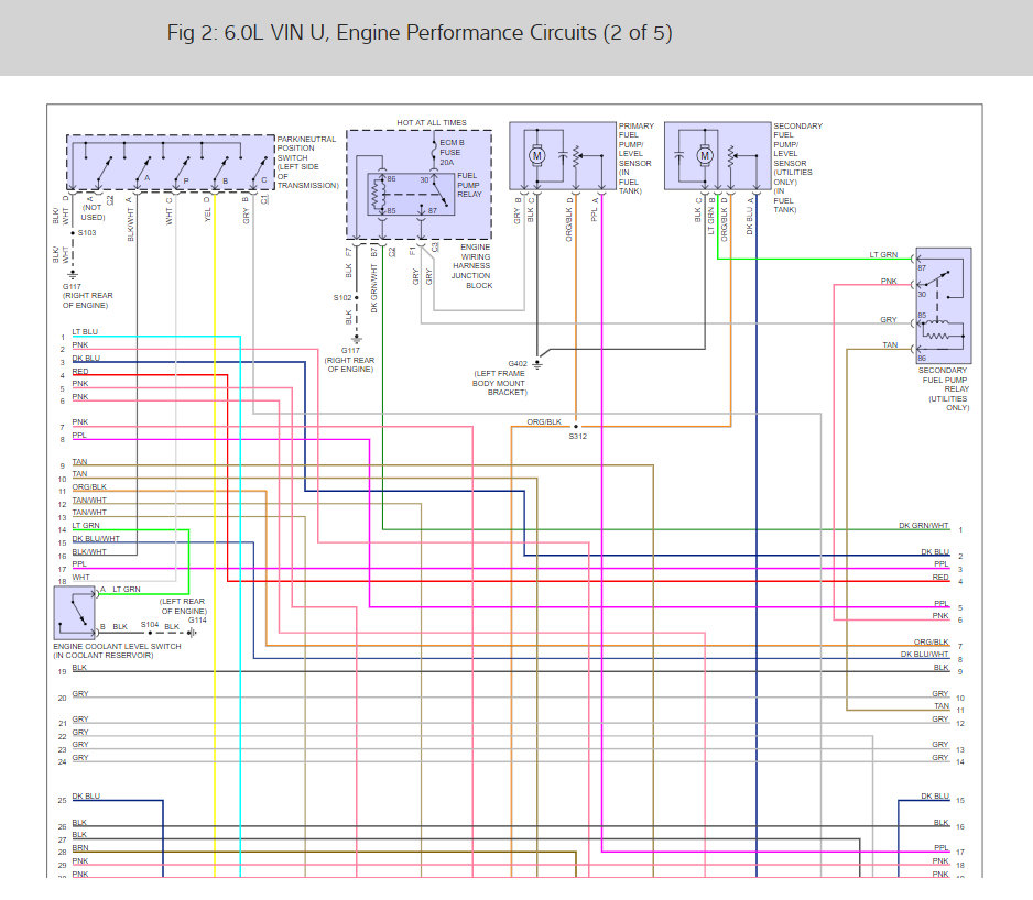

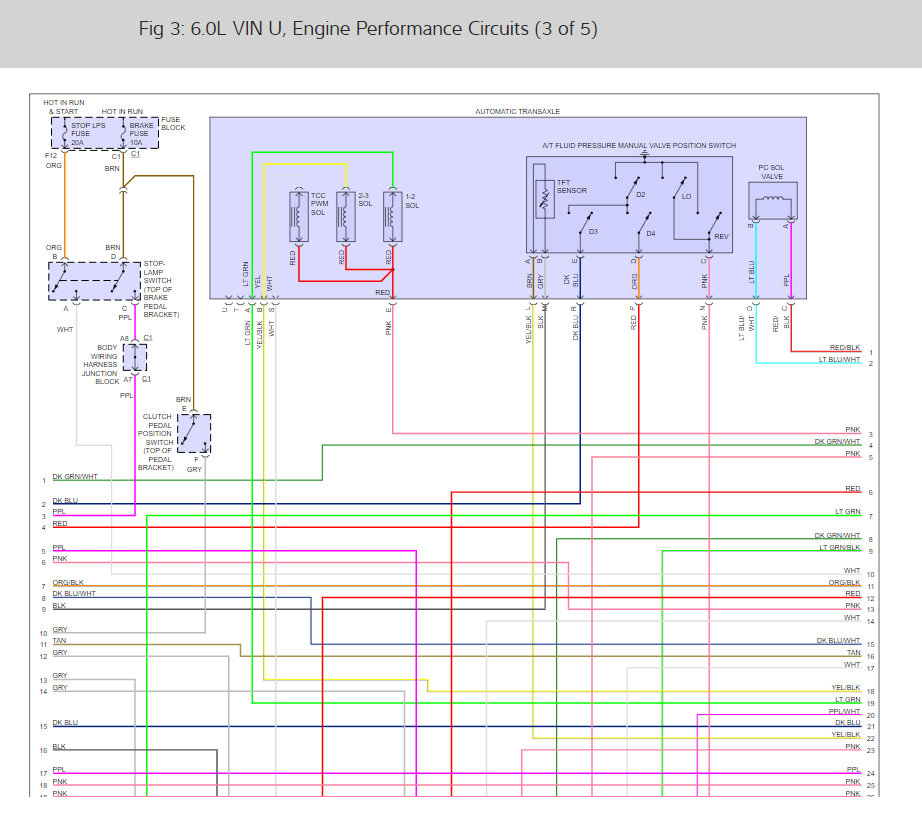

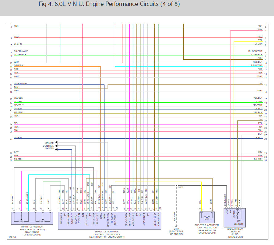

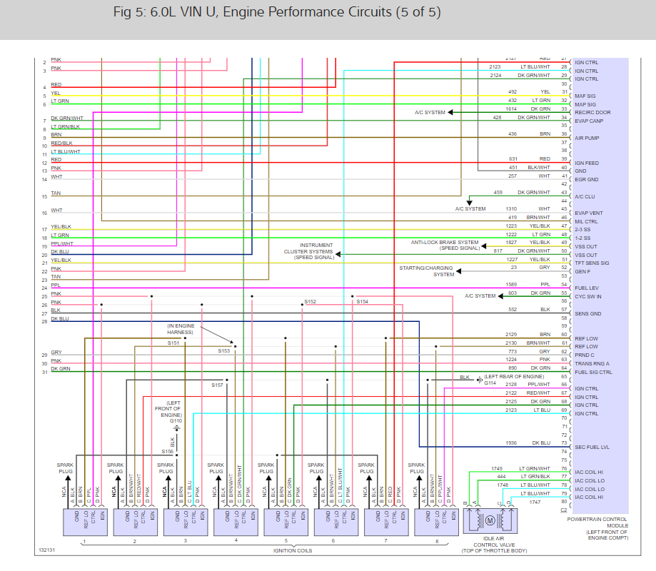

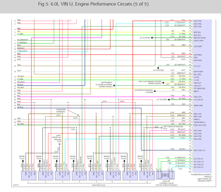

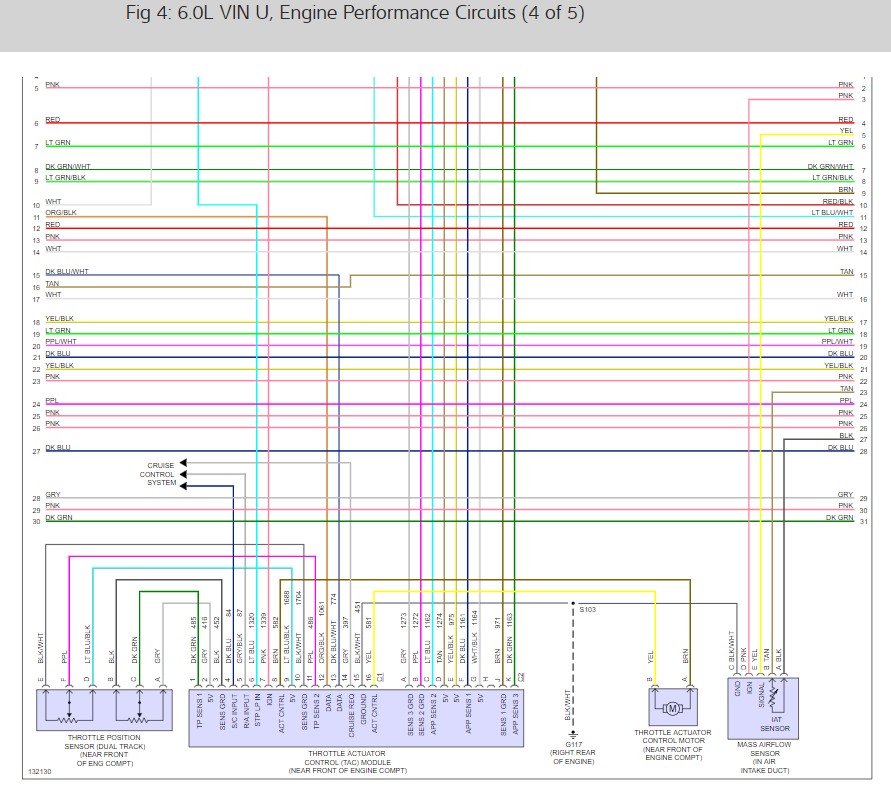

The ICM and PCM work together you might have a bad PCM. Here is a guide so you can check the wiring with the engine wiring diagrams below:
Jun 5, 2021 at 7:48 AM
JEANSIMMONS993
  • 14 POSTS
the pink wire is showing continuity to the ground from the PCM.
