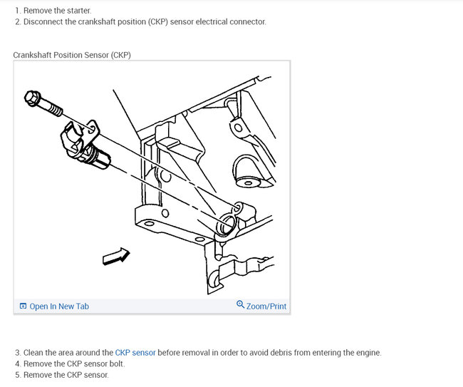

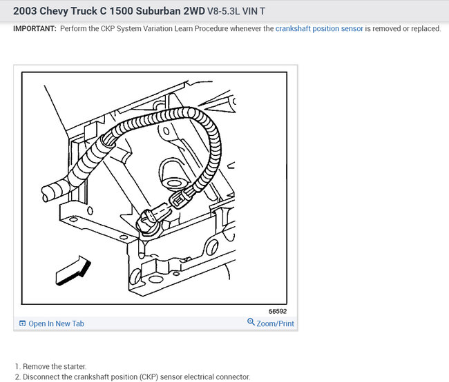

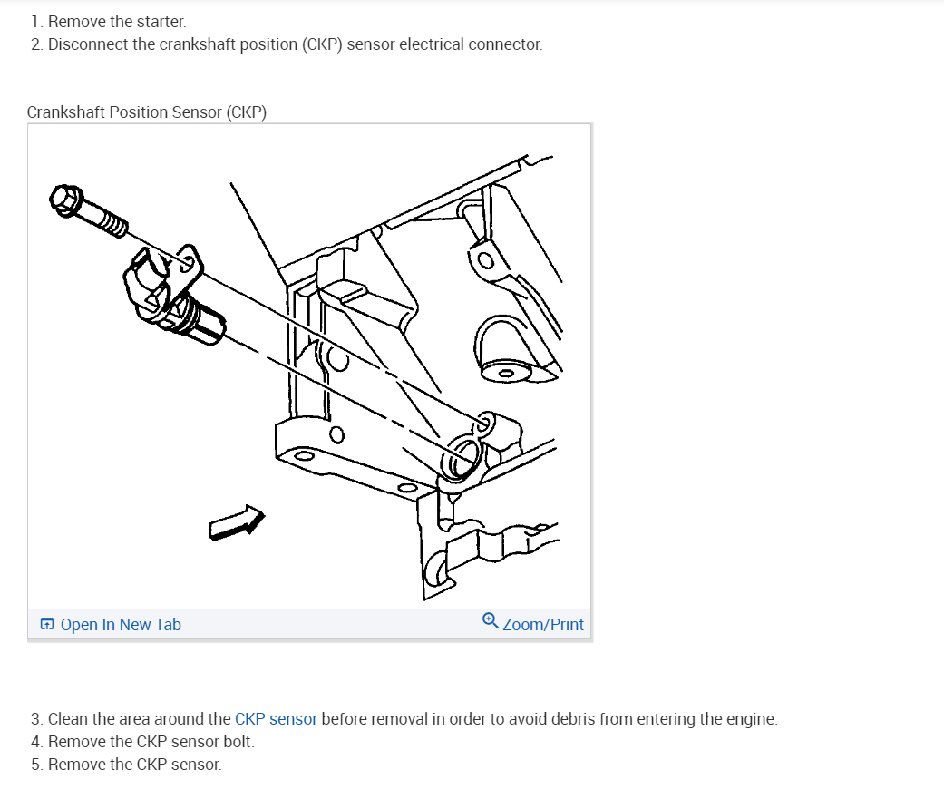

I replaced a starter and oil level sensor, and did an oil change and now it won't start only turns over.
May 12, 2023 at 1:36 PM
  • 55,721 POSTS
The crankshaft angle sensor is near the starter. Can you check the wiring connection at the sensor please? Here is the location of the sensor so you can check it out. Check out the images (below). Let us know what happens and please upload pictures or videos of the problem so we can see what's going on.
May 13, 2023 at 4:44 AM
ROBERT6121975
hey, Ken, i checked the crankshaft sensor and i found that the plug was in but one of the wires was not even connected. so, i replaced that plug connector and the connector to the oil level sensor and now it starts but it's reading a code p0300 random/multiple cylinder misfire as well as a p0200 injector circuit/open.
May 15, 2023 at 1:29 PM
ROBERT6121975
Right after i messaged you the last message the codes popped up there's 10 of them #1 p0101 mass air flow #2 p0102 mass air flow a circut low #3 p0200 injector/open #4 p0300 random / multiple cylinder misfire #5 p1515 electric throttle system throttle position #6 p0101 mass airflow #7 p0102 #8p0200 injector circuit open #9 p0300 misfire #10 p1515 electronic throttle system throttle position.
