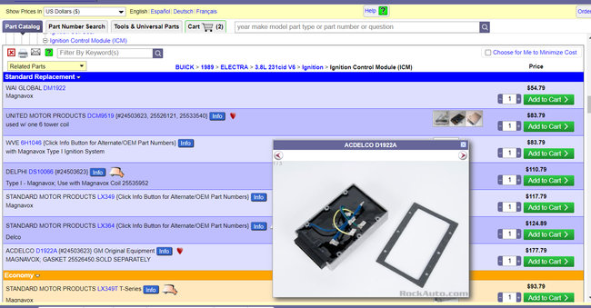

This was a common issue back in the day. The ignition control module was the common failure for this.
https://www.2carpros.com/articles/engine-stalls
Did the shop check the module? You can remove it and take it to a parts store and they can test off the car. It is a free service at the parts store. I would also replace the coil pack as well.

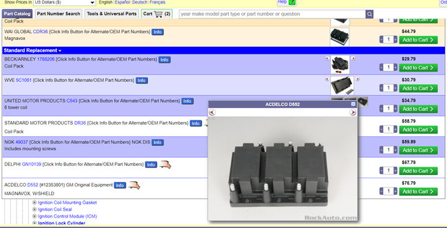

The only thing I do not see is the coils. They should have been part of the module.
Did they replace the coils with the module?
Jun 9, 2021 at 2:50 PM
CARTROUBLEBLUES
  • 5 POSTS
I don't believe so. I'll be sure to ask since the problem hasn't been fixed. If the coils aren't the problem, could there be anything other cause or reason?

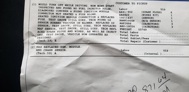

This what they did.
Jun 10, 2021 at 6:55 AM

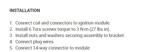

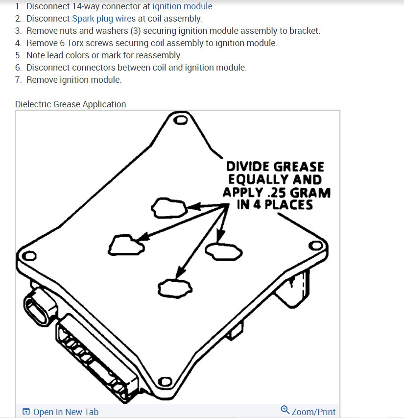

Who replaced the ignition module and crank sensor? There is no mention of them performing the repair.
Jun 10, 2021 at 9:30 AM
CARTROUBLEBLUES
  • 5 POSTS
The crank sensor and ignition control module were replaced at another shop but according to these guys the module wasn't sealed correctly. So they fixed that.
Jun 10, 2021 at 9:35 AM
That may have damaged the new module. I would have them test that module to be sure it is not damaged.
