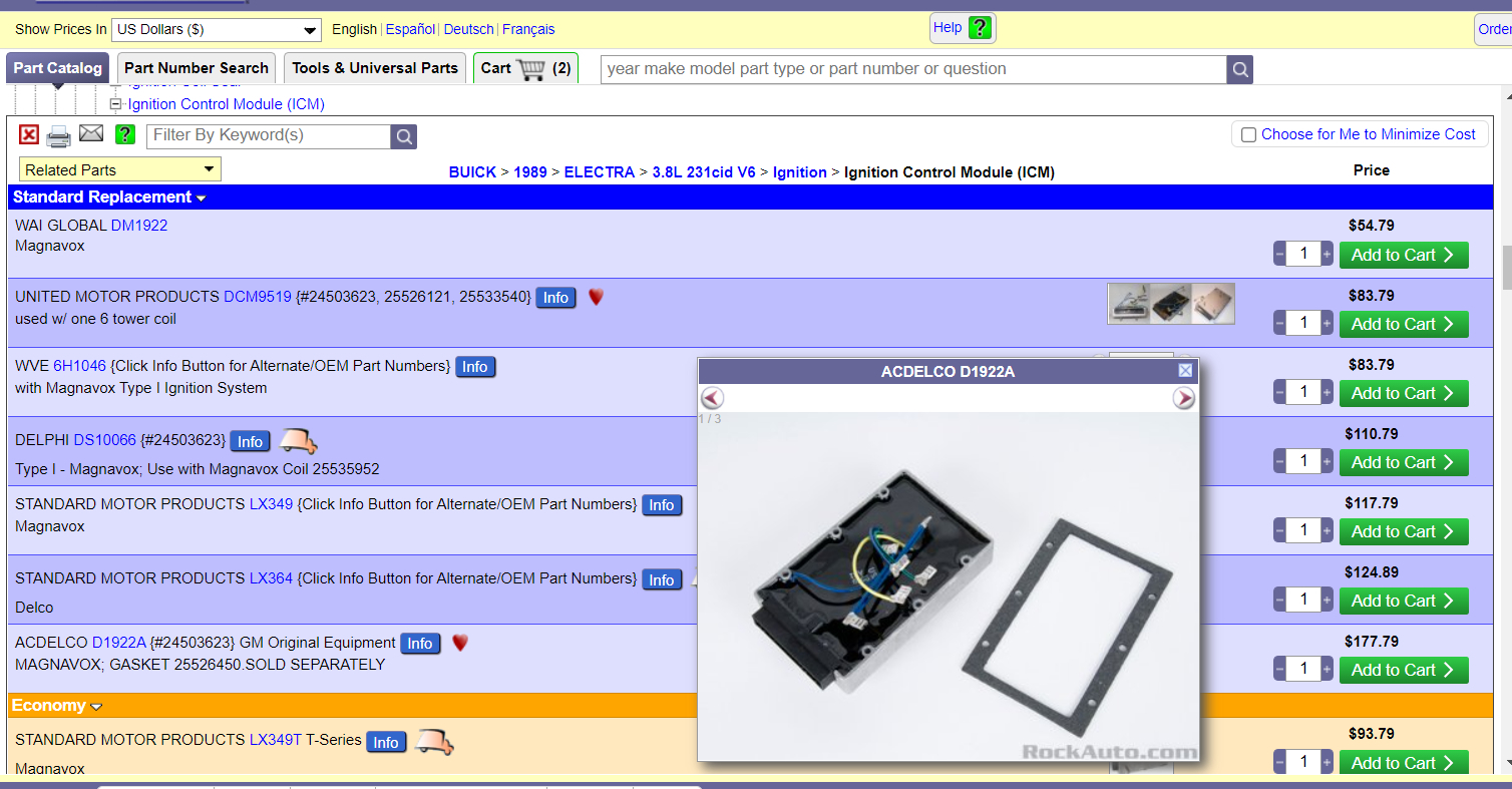

This was a common issue back in the day. The ignition control module was the common failure for this.
https://www.2carpros.com/articles/engine-stalls

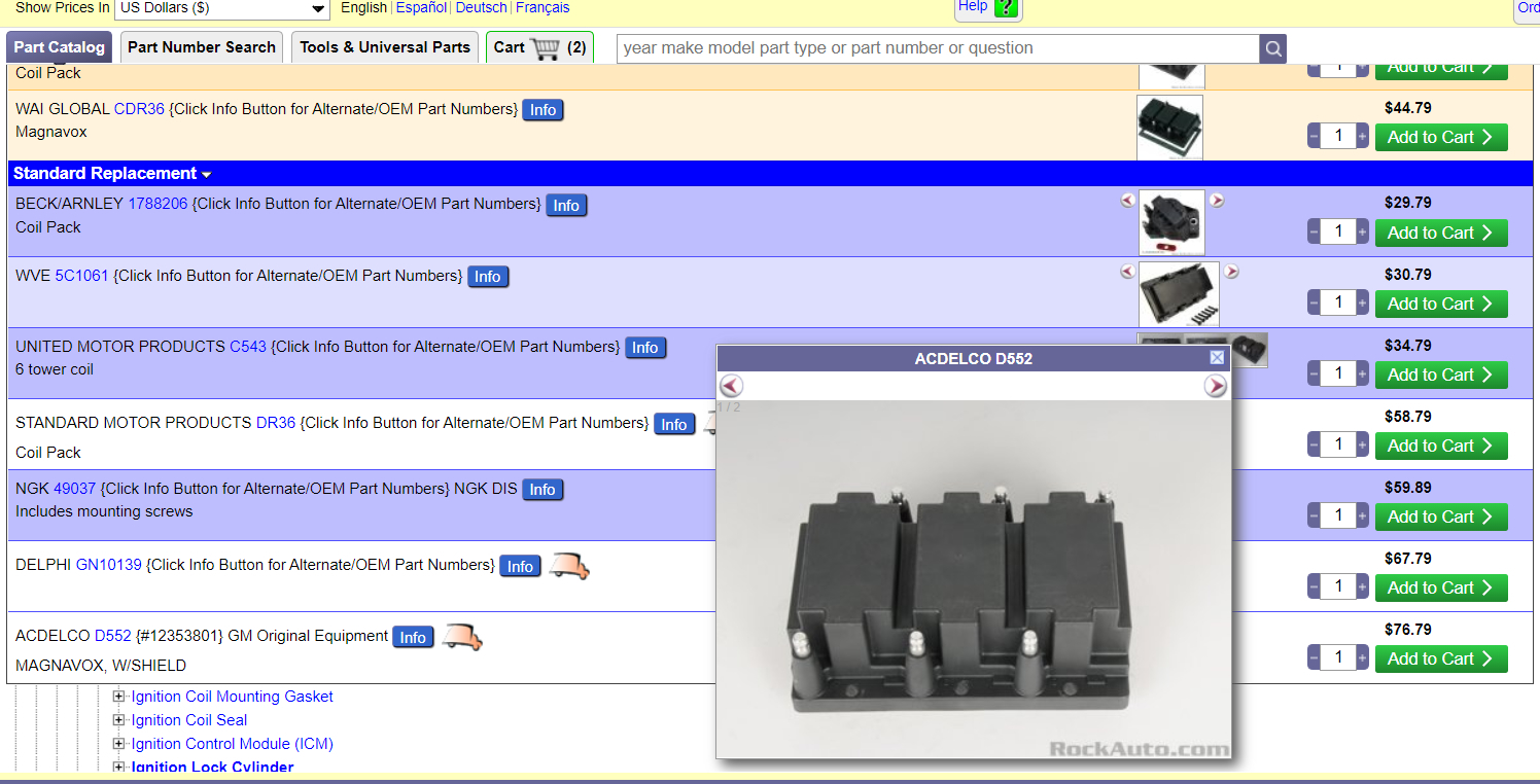

Did the shop check the module? You can remove it and take it to a parts store and they can test off the car. It is a free service at the parts store. I would also replace the coil pack as well.

The only thing I do not see is the coils. They should have been part of the module.
Did they replace the coils with the module?

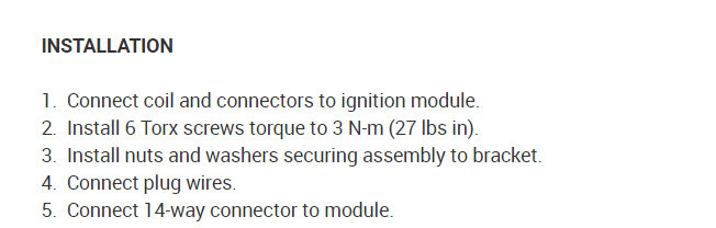

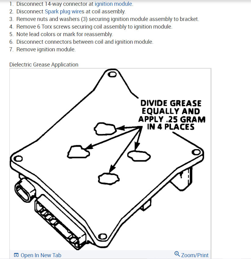

The crank sensor and ignition control module were replaced at another shop but according to these guys the module wasn't sealed correctly. So they fixed that.
Thursday, June 10th, 2021 AT 4:35 PM
  • 52,797 POSTS
That may have damaged the new module. I would have them test that module to be sure it is not damaged.
