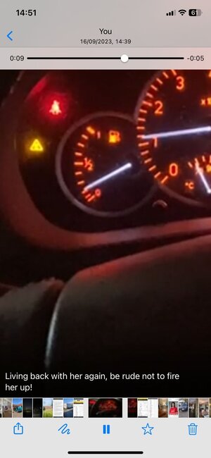

Hi Joe,
Thanks. I only have a small amount in the tank (see picture). Would I be ok putting larger amount of fuel on top of this? Or is it imperative that I drain it?

  • 110,194 POSTS
If you add fuel, it will take a while for the old fuel in the line to clear out, so it will be a delayed start. You may have to keep it running with starting fluid for a bit.
When fuel gets old, it will burn, but it won't allow the vehicle to run. It turns into almost a varnish.
The best thing to do is drain it and blow out the fuel lines and fuel rail. That way fresh fuel will be sent right away. I've also seen people here disconnect the fuel line at the fuel rail and cycle the key on and off to allow the pump to empty the tank. You could do that. Just make sure you have a gas container to empty it into. It will come out fast, but you will be emptying the fuel tank and fuel lines at the same time.
