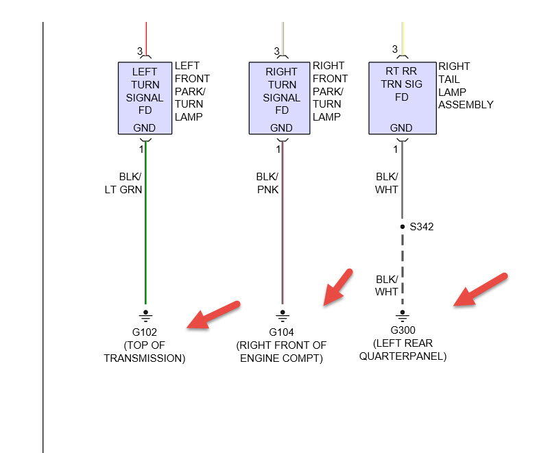

I have owned my car for a year and I have had to change my rear turn light four times already. It switches from the left side to the right side. I am wondering how I would go about fixing this? And if it is a wiring problem. And if it is an easy fix.

check the ground leading to both it may be one line and check for loose contacts inside socket as it could be that as well. it is at right rear quarter panel. then if it continues have a mechanic scan for codes as it may be a TPIM module problem as turn signal go through that.
