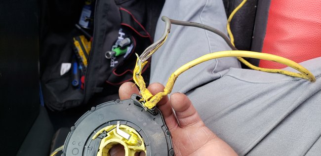

I am trying to figure out why everytime I make a left or right turn my speedometer, door locks, gear shift all the lights goes off while making turns. I recently replace the headlight switch because I thought that was the problem and no it wasn't. So once the lights blinks off I turn the switch from being on to off then back on and everything lights up until I make turns. Once all the light shut off my brake lights and blinkers still works fine. When driving straight I be good just when I turn.

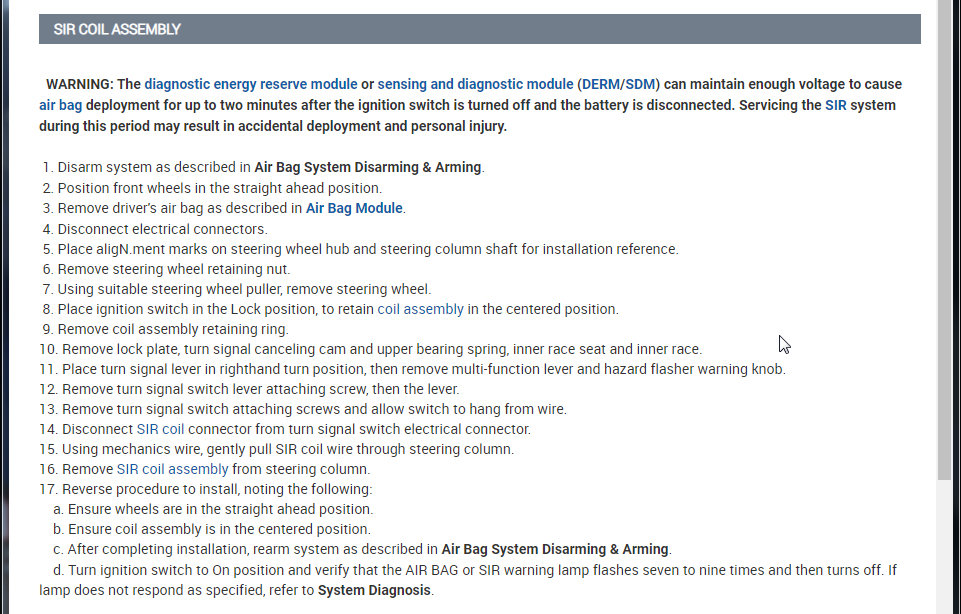

That is an odd issue. However, I suspect you either have a short in the harness that is getting rubbed when you turn the wheel or more likely you have an issue in the clockspring.
Here are some guides that talk about this:
https://www.2carpros.com/articles/symptoms-of-a-bad-airbag-clock-spring
https://www.2carpros.com/articles/steering-wheel-clock-spring-removal
If it were me, I would replace the clockspring and retest the issue.
I attached the info from the manual below on how to do this. Please let us know what questions you have. Thanks

LIONELL8732
  • 143 POSTS
Part was all bad.
Sunday, April 25th, 2021 AT 3:00 PM

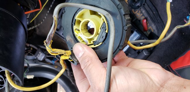

LIONELL8732
  • 143 POSTS
Another picture of the part.
Sunday, April 25th, 2021 AT 3:21 PM
  • 109,772 POSTS
Wow! Not a lot left to the wiring. Is the new one installed and working properly?

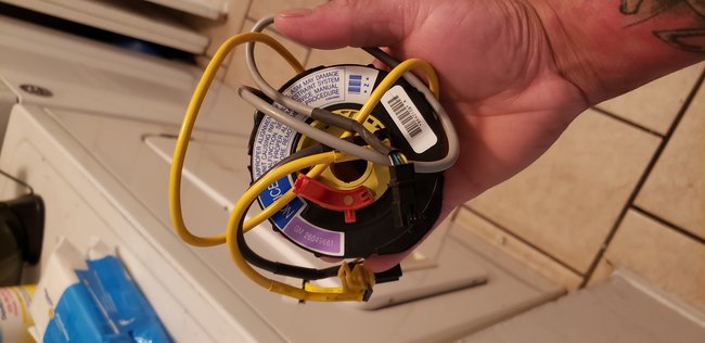

LIONELL8732
  • 143 POSTS
Yes, the new one is installed and is working properly. When I turn left and right no more problem with the lights turning off. I just want to say thanks for helping me get this issues solved.
