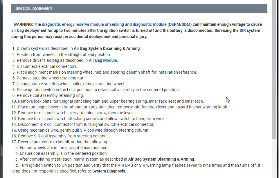

That is an odd issue. However, I suspect you either have a short in the harness that is getting rubbed when you turn the wheel or more likely you have an issue in the clockspring.
Here are some guides that talk about this:
https://www.2carpros.com/articles/symptoms-of-a-bad-airbag-clock-spring
https://www.2carpros.com/articles/steering-wheel-clock-spring-removal
If it were me, I would replace the clockspring and retest the issue.
I attached the info from the manual below on how to do this. Please let us know what questions you have. Thanks

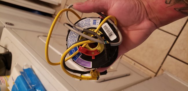

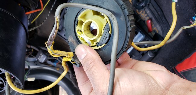

Part was all bad .

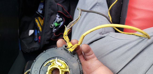

LIONELL8732
  • 150 POSTS
Another picture of the part.
Apr 25, 2021 at 8:21 AM
  • 110,244 POSTS
Wow!!! Not a lot left to the wiring. Is the new one installed and working properly?
Let us know.
Apr 25, 2021 at 12:05 PM
LIONELL8732
  • 150 POSTS
yes, the new one is installed and is working properly. when i turn left and right no more problem with the lights turning off. i just want to say thanks for helping me get this issues solved.
