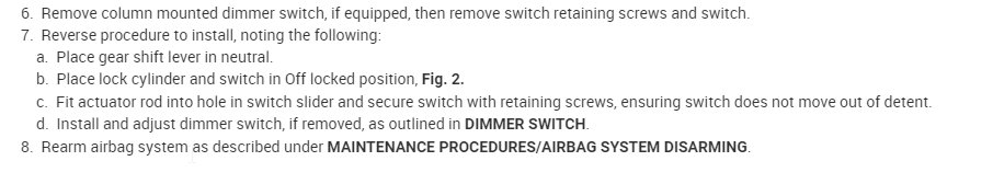

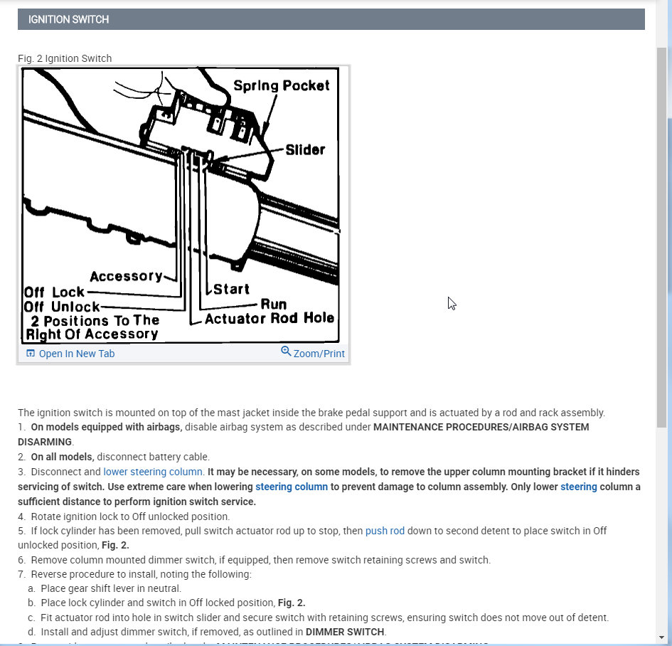

It may be best to start a new post with your specific vehicle and issue because this was from a few years ago. However, assuming your vehicle is the same as this post, here is the process for replacing the ignition switch.
