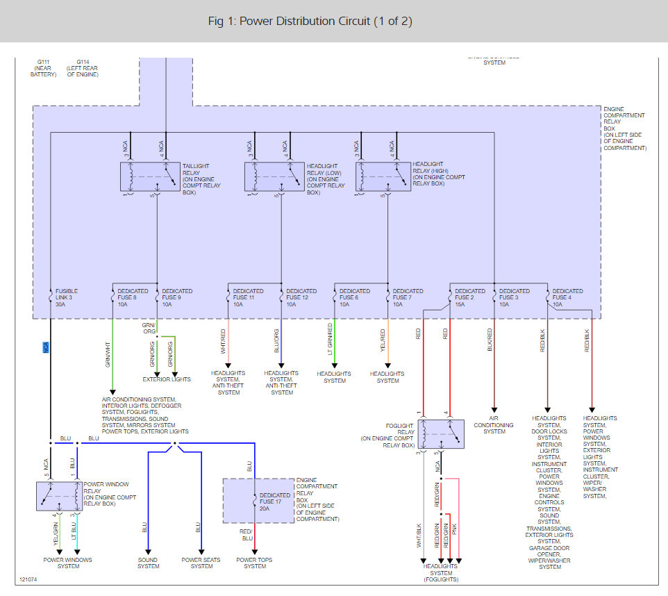

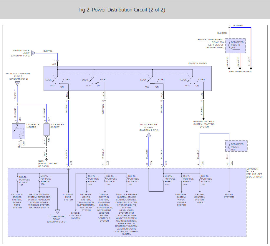

It sounds like the ignition switch when out. Here is a guide and a wiring diagram (below) to help you confirm the problem and get it fixed. Check for power coming out of the switch.
Please run this test and get back to us we are interested to see what it is.

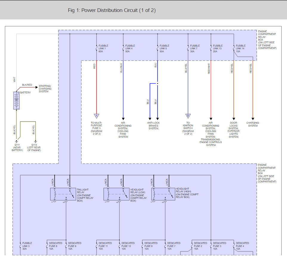

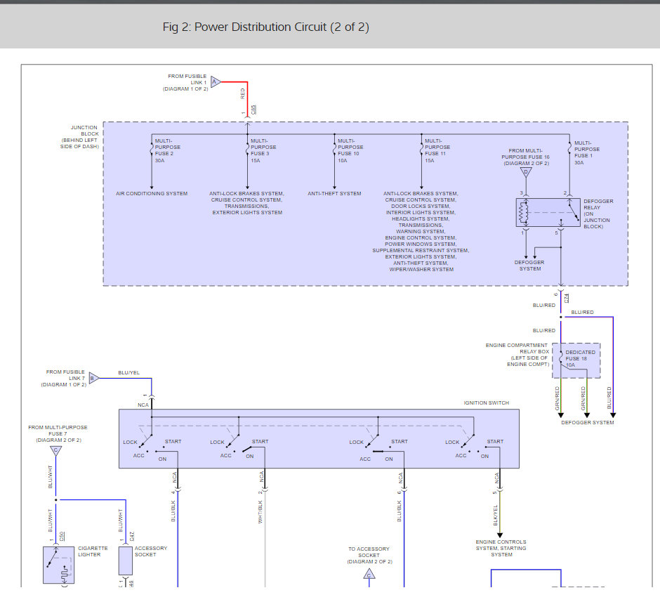

It sounds like some fusible links are out. Here is a diagram to help you check those. (below)
Aug 7, 2017 at 3:50 AM
