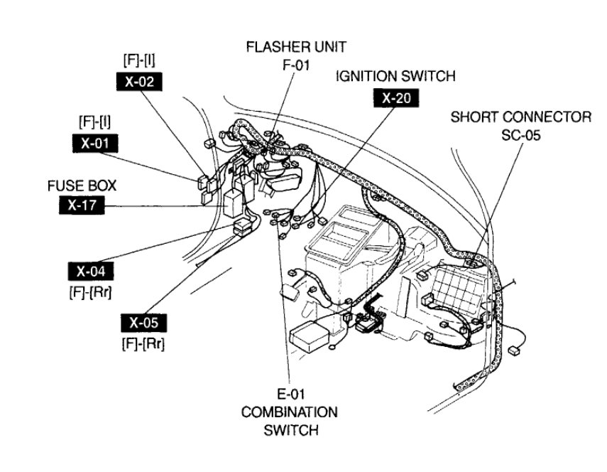

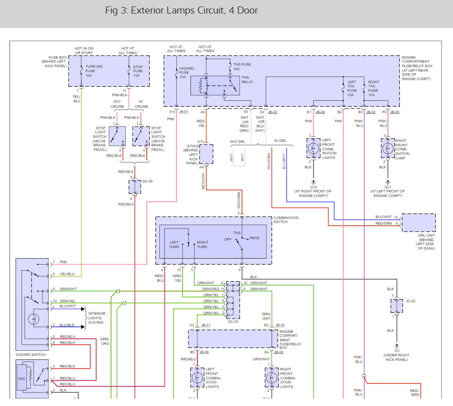

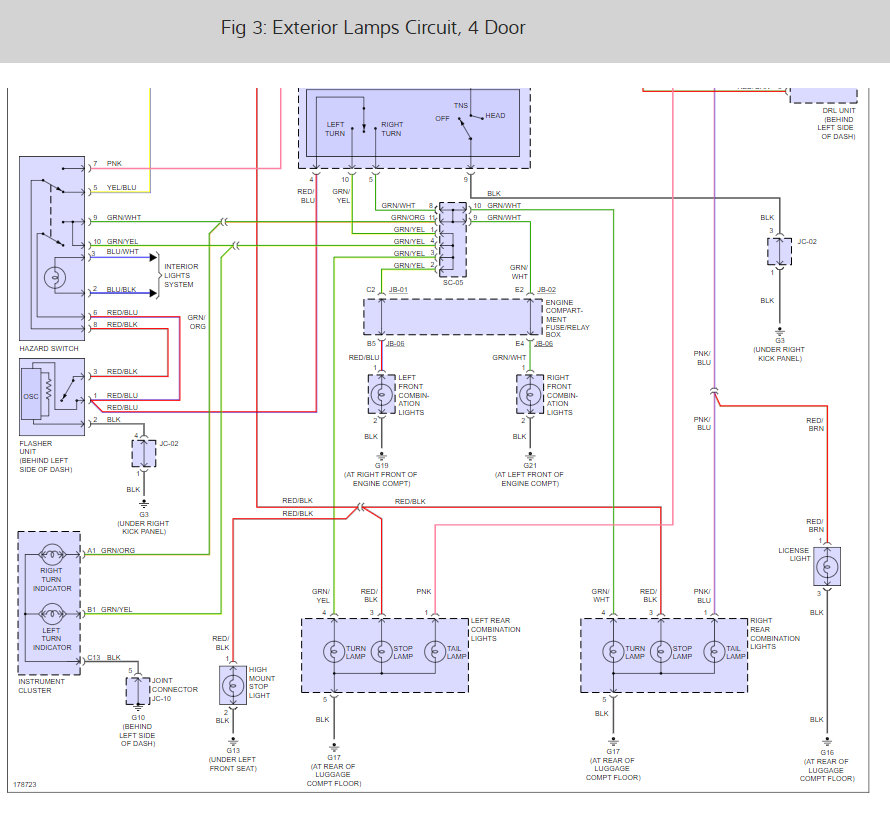

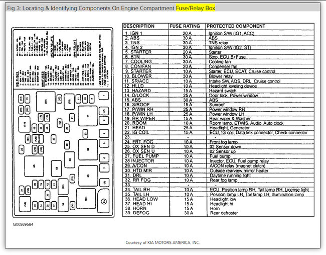

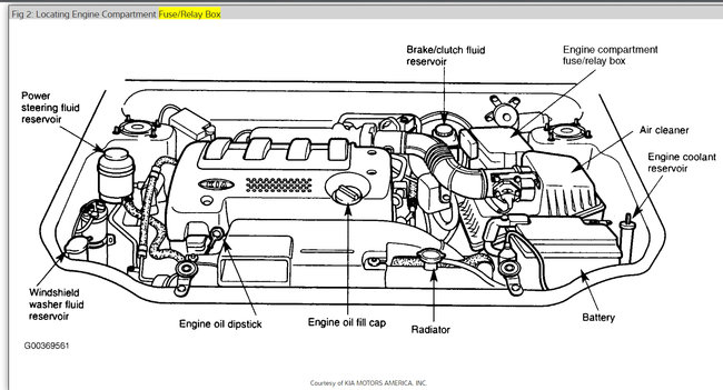

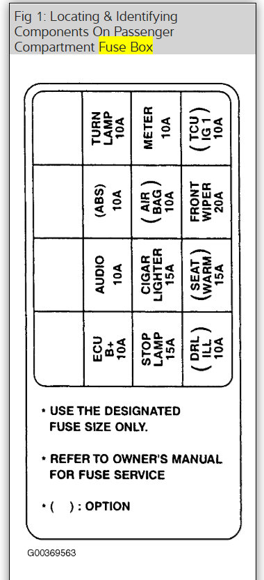

Turn signals will not work or the flashers.
Jun 18, 2018 at 7:59 PM
  • 55,808 POSTS
First check the fuse turn, stop and tail light fuses and flasher unit.
If the fuses are okay here is the wiring diagram and a guide to help you see where you are losing power.
