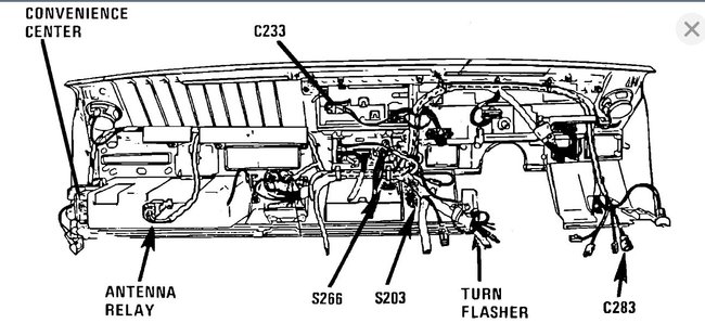

Bulbs are not burnt, I have replaced the fuse and still nothing. Hazards and everything else work.

Good morning.
The older cars have a separate flasher for the turn signals and hazards. I attached a picture of the location for you. Try replacing this flasher. You should be able to reach under the dash and remove it.
The turn flasher is located behind I/P, right of steering column.
