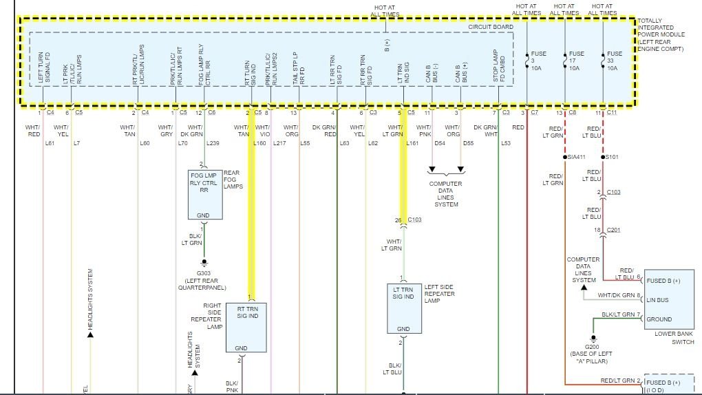

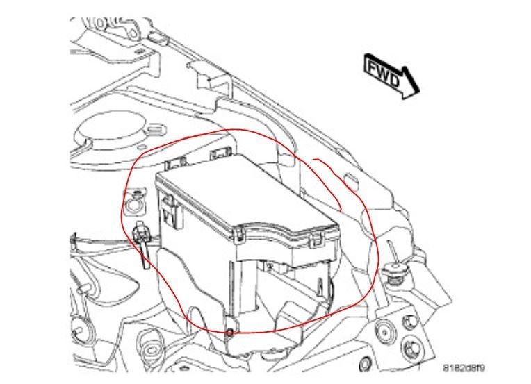

All of a sudden my turn signal stopped working, my windshield wipers stopped working and when I start my car my headlights automatically turn on.
Feb 23, 2020 at 8:28 AM
Good morning,

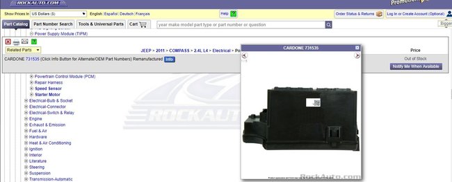

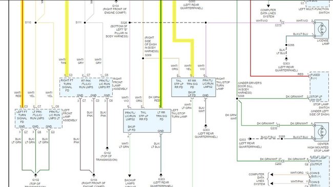

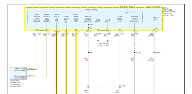

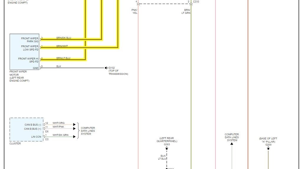

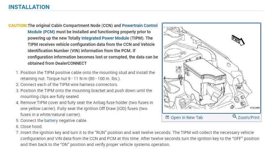

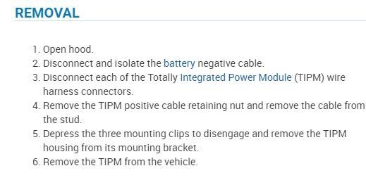

The functions that are not working are controlled by the totally integrated power module. It is the fuse box under the hood. That is like a body control module in other cars.
This is a very common failure. You can get this at any parts store and the nice thing is that does not have to be programmed. It is a plug and play module.
