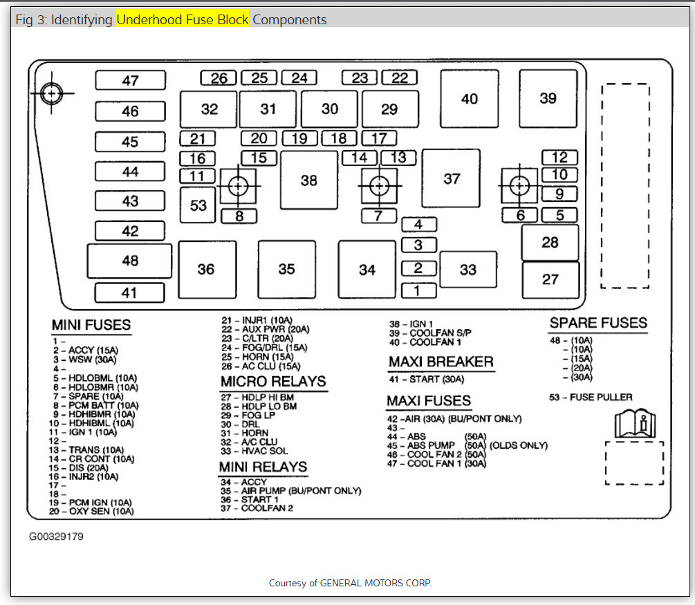

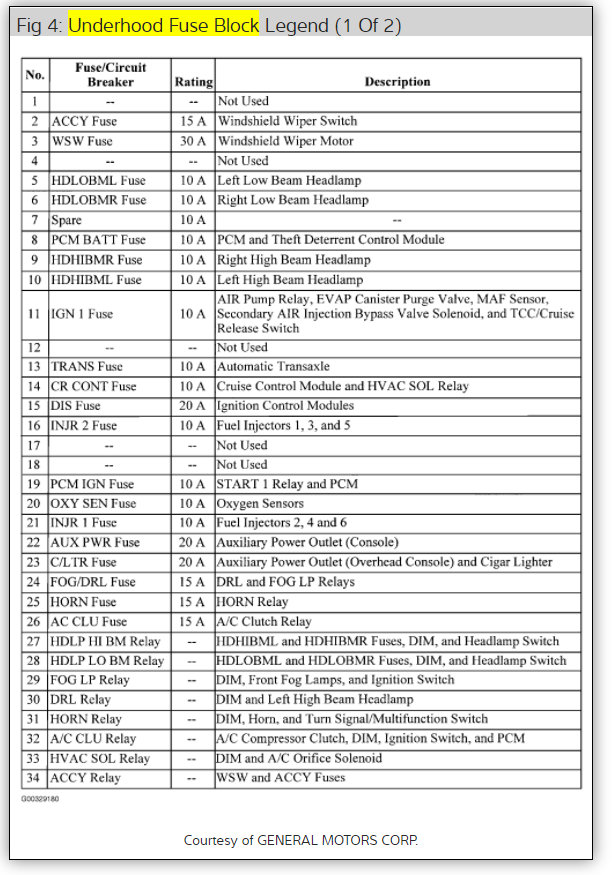

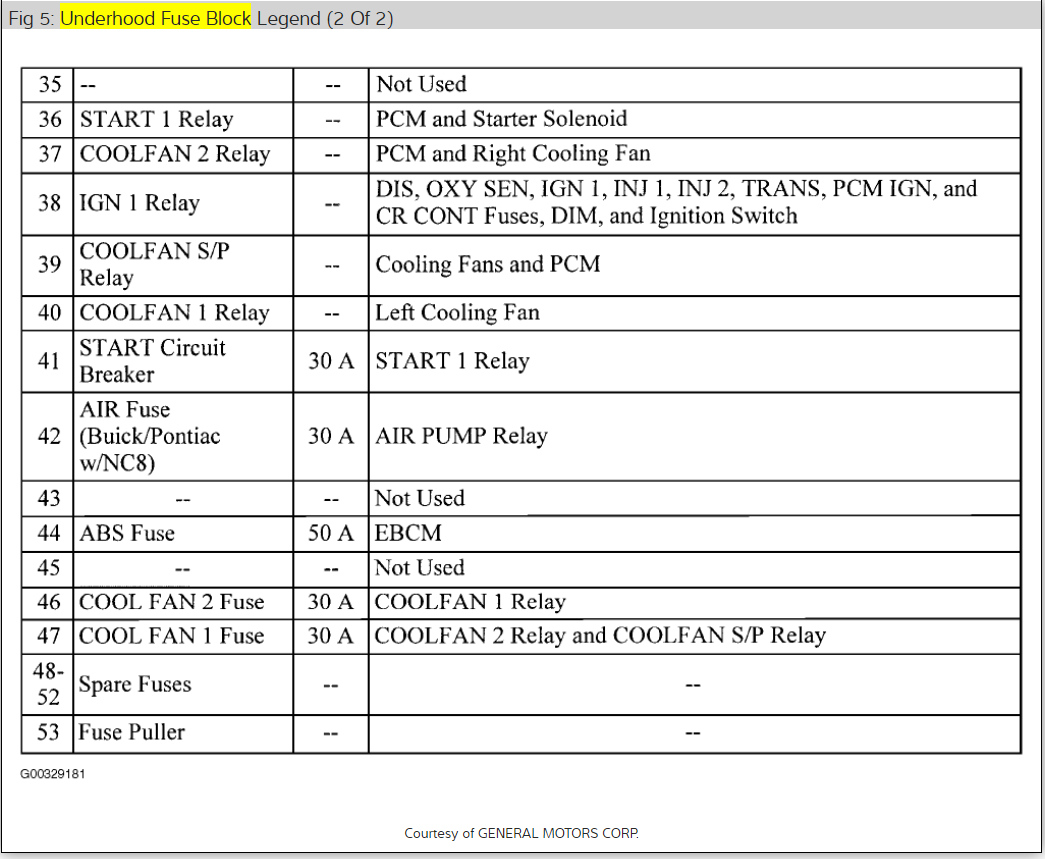

I've replaced the turn signal bulbs, the bulb sockets, the turn signal flasher/hazard flasher all in one. I've even checked fuses. Still no hazards or turn signal. Am I missing something?
Dec 11, 2019 at 1:51 AM
  • 55,433 POSTS
There is a turn signal hazard fuse we need to check for power. here is a guide to help and the fuse location with the blinker wiring diagrams so you can see how the system works:
Dec 11, 2019 at 1:59 AM
TSLOAN88
Thanks for the reply. I had to replace fuses and both bulb sockets up front. But they are working now.
Dec 11, 2019 at 2:45 AM
  • 55,433 POSTS
Glad you could get it fixed, that kind of problem can be tough. Please use 2CarPros anytime we are here to help.
Dec 11, 2019 at 2:46 AM

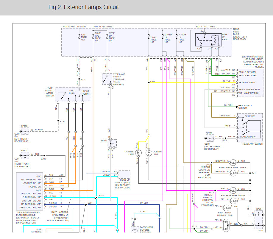

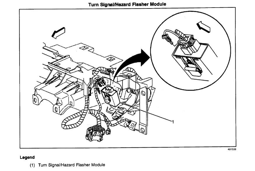

When you turn the left signal on, does anything happen? For example, does the indicator come on in the vehicle or flash rapidly? Also, when you turn the hazard lights on, do they work?

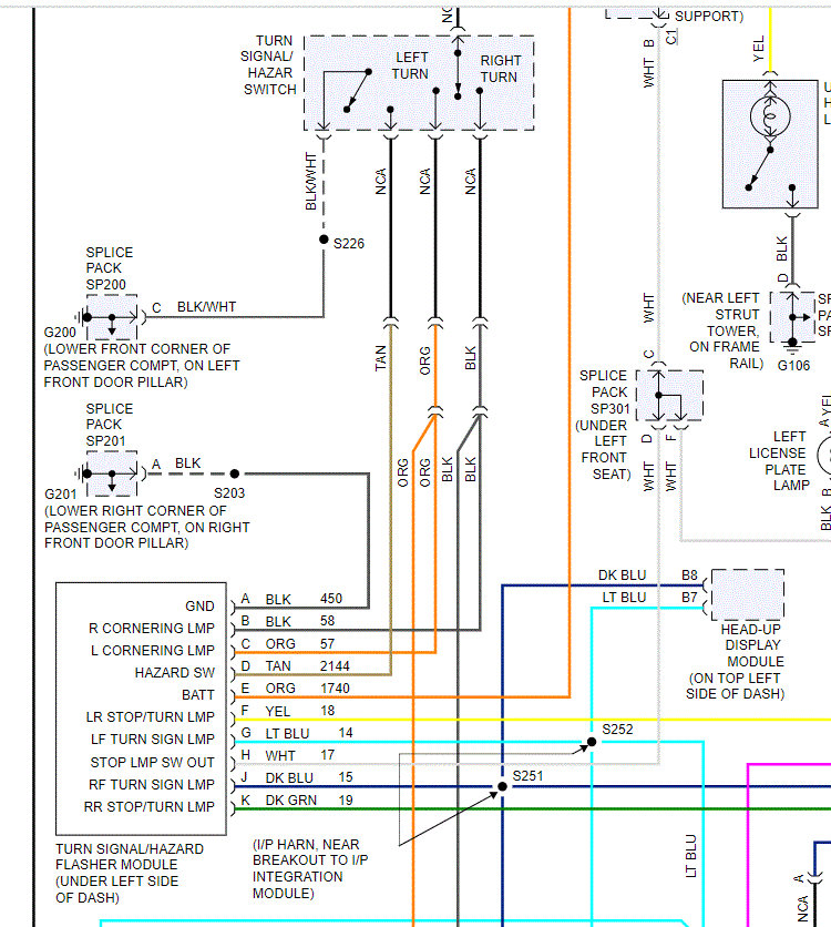

I'm looking through the wiring schematic, and I notice that power goes through the hazard /signal switch before going to the flasher module. See pic 1. Let me know if anything is happening when the signal is turned on or when the hazards are turned on. If it still doesn't work, I will need you to check for power at the module's light blue wire when the left signals are selected. Here is a link you may find helpful:
Let me know. If you have other questions, let me know that as well.
Feb 12, 2021 at 3:29 AM (Merged)

AEW
The signal lights are not working, however the hazard lights do flash when turned on. I have checked the fuses I know to check and all the bulbs are working. However, when the turn signal switch on the steering column is pushed up or down to activate the turn signals they do not blink. Can you tell me how to go about fixing this problem?
JDL
  • 16,098 POSTS
This sounds like the turn signal flasher is not working right. Here is the location so you can see how to replace it.
Cheers
PPNJ4
This fixed my car. Thanks for the post.

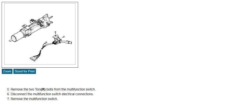

DRICE17
Right turn signal does not work. The dash light for the right turn signal also does not light. I replaced the flasher and that made no difference. The outside turn light for the right also does not work. All other functions work properly (emergency flasher, left turn signal etc.). Please advise.

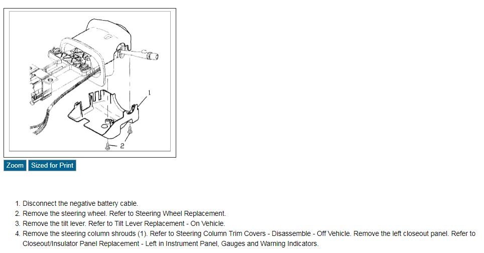

HARRY P
  • 2,292 POSTS
I would bet on a bad switch. Fairly common in GM's from that year range. The only test that I can think of would be to probe the connector to the flasher with your multi-meter and see if power gets there when you have that switch turned on. I suspect you will find no power there.
Feb 12, 2021 at 3:30 AM (Merged)
DRICE17
Thank you. Where is the switch located?
HARRY P
  • 2,292 POSTS
I am talking about the one on the steering column that you flip up for right and down for left.

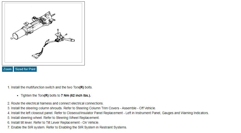

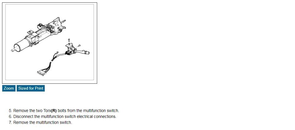

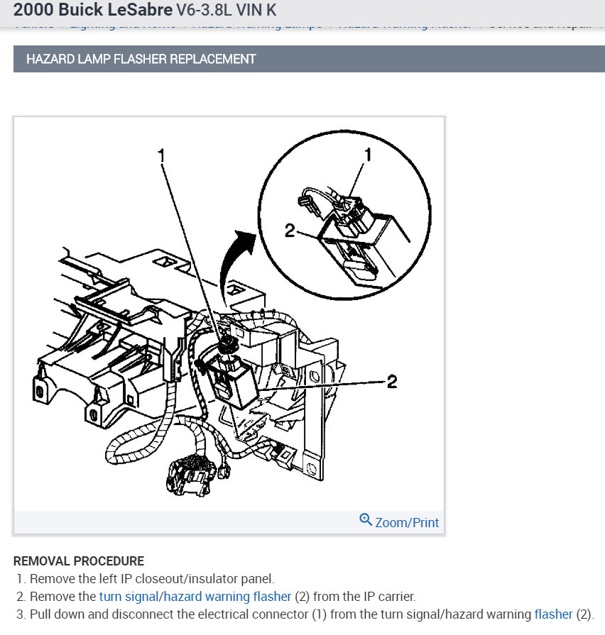

HARRY P
  • 2,292 POSTS
It is actually a fairly involved job, as it requires you to pull the steering wheel off to do it. And it is possible that if you make a mistake, the airbag can go off and hit you in the face. But I am posting the basics of removing (images 1 and 2) and reinstalling the switch (image 3) below. And here is our guide on removing and reinstalling the wheel: https://www.2carpros.com/articles/steering-wheel-removal
You will need to borrow a steering wheel puller from AutoZone for your car though.

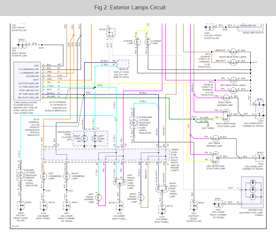

DR LOOT
  • 2,311 POSTS
I have looked at the wiring schematics on your vehicle and noticed that the hazard flasher and the turn signal flasher on the same circuit therefore it is a hazard flasher's work. There should be power going to the turn signal flasher and if that is the case in the turn signals do not work replace the flasher of the turn signal. I have given you below the location of both flashers so you do not confuse them and replace the correct one.
Turn signal flasher under left side of dash.
Hazard flasher under left side of dash, on right side of steering column brace.
