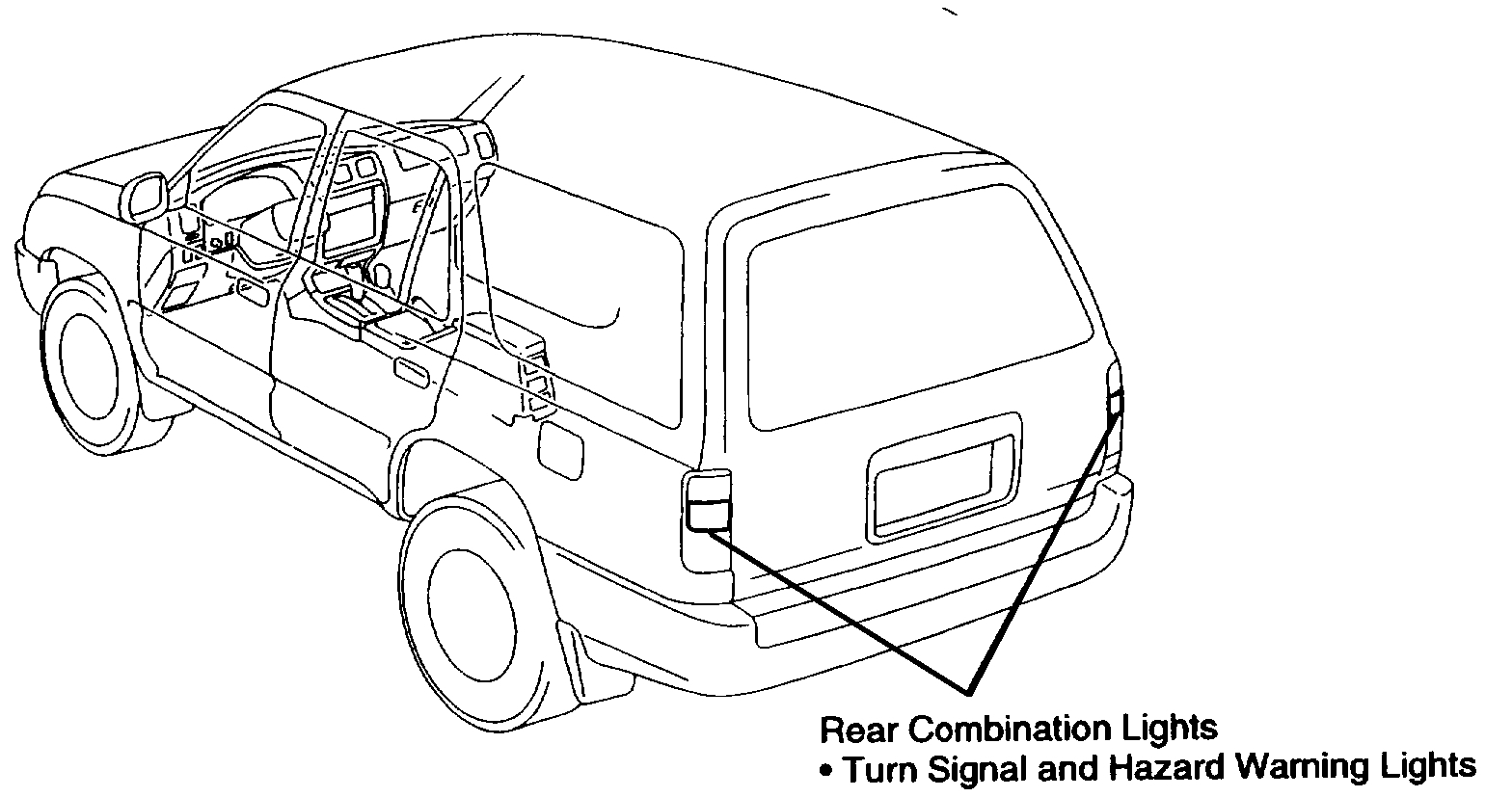

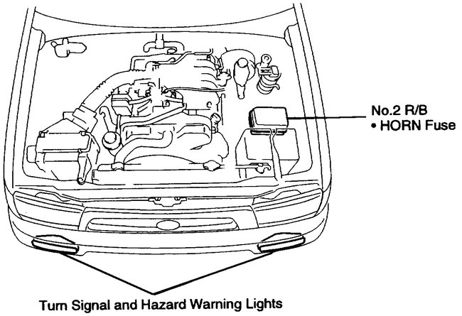

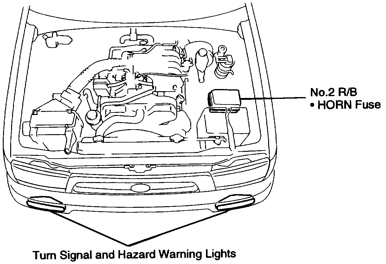

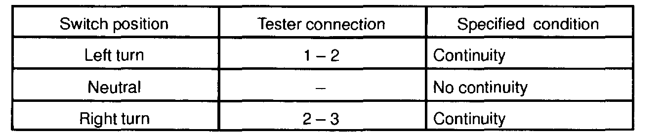

I turned the vehicle on to start. And as i put it in gear. I rolled down in drive to the stop light. I goto turn the signal on to left and it wouldnt work. So i got back to my house. Checked the fuses. And bulbs. I changed bulbs. And i changed the turn signal flasher unit. But it will not work. Help me find a solution to fix it. The switch is okay.

First, although the fuses look good, they can still be bad or there may not be power to them. Follow this link for checking fuses. You will need a multi meter or a test light. I will provide links showing how they are used.
If you confirm that power is getting to the fuse and through it, the next thing you need to do is follow this diagnostic test. The attached pictures correlate with the directions,
COMPONENT TESTS AND GENERAL DIAGNOSTICS
Turn Signal & Hazard Warning System Location
See Pic 1
See Pic 2
See Pic 3

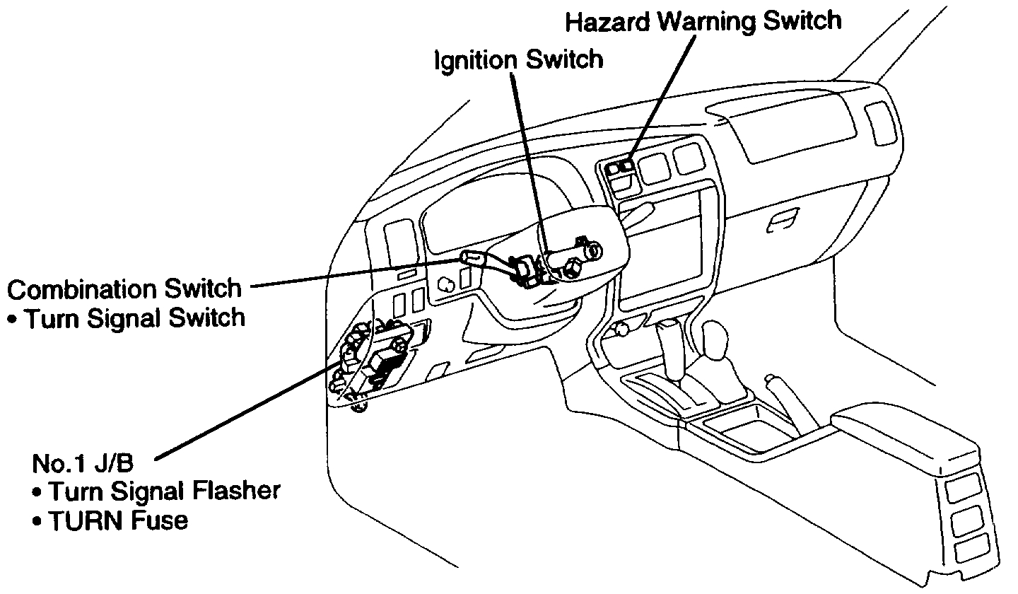

Turn Signal
See Pic 4

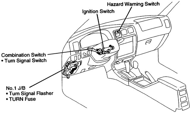

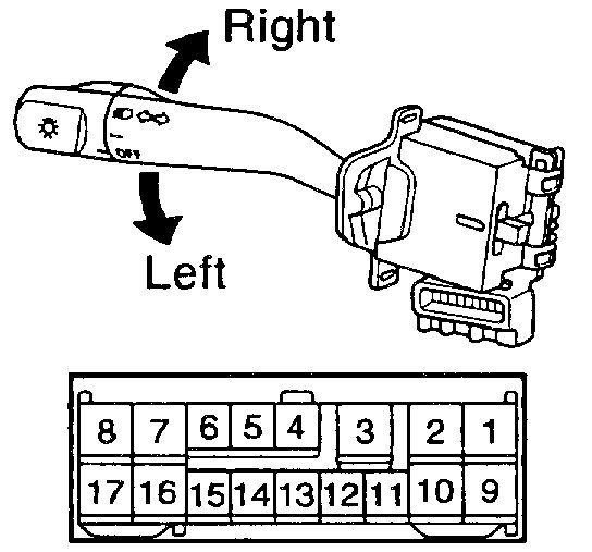

See Pic 5 Continuity pin locations
INSPECT TURN SIGNAL SWITCH CONTINUITY
If continuity is not as specified, replace the switch.
