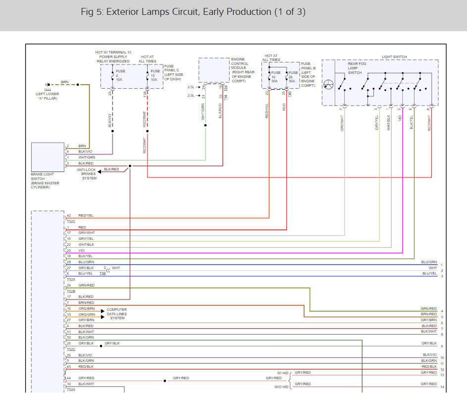

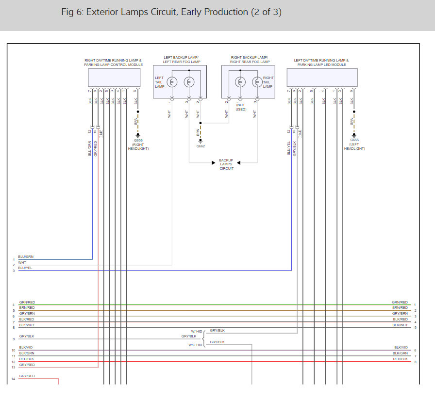

Turn signal indicators are not working, but they are blinking in the instrument cluster. all four sides are not working, bulbs checked and they are working fine. So I'm thinking it's wiring issues since the car has got after market headlamps and taillights.
Sep 2, 2019 at 7:11 PM
  • 55,663 POSTS

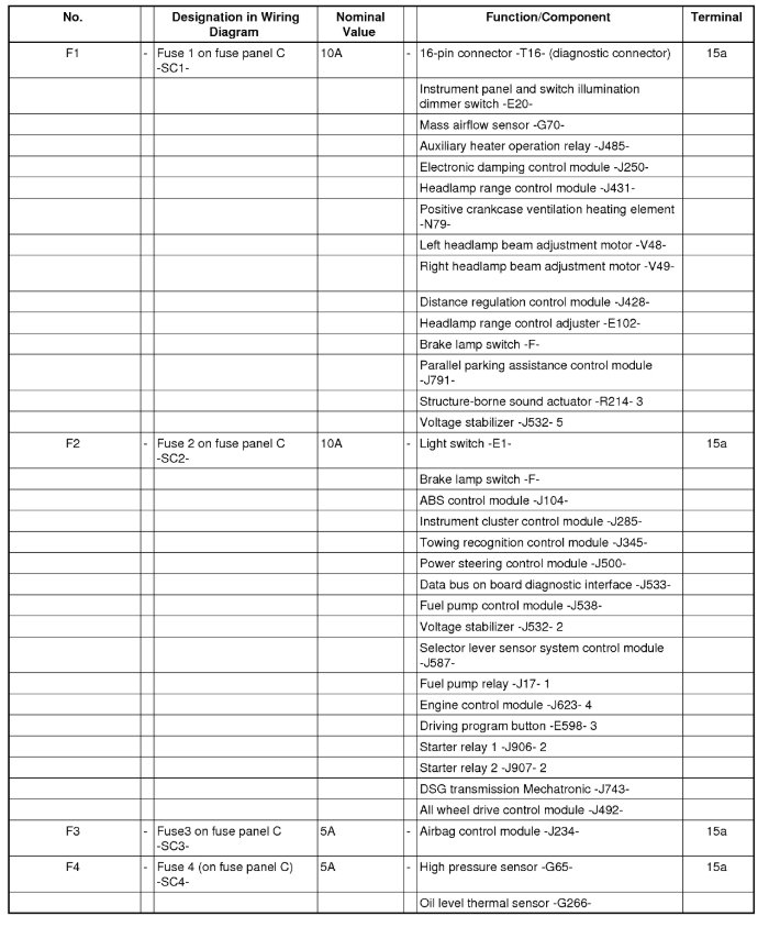

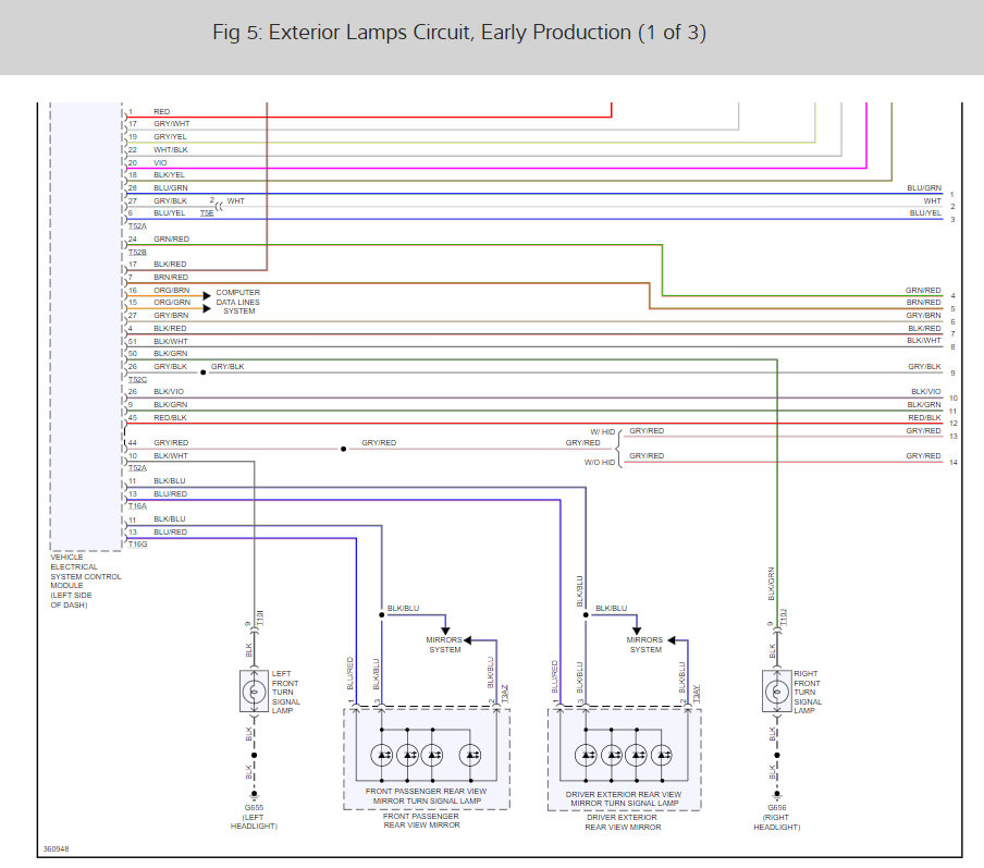

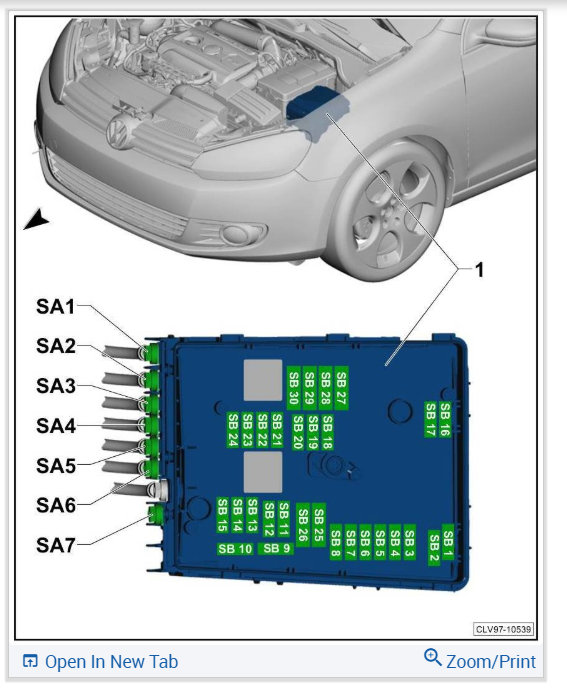

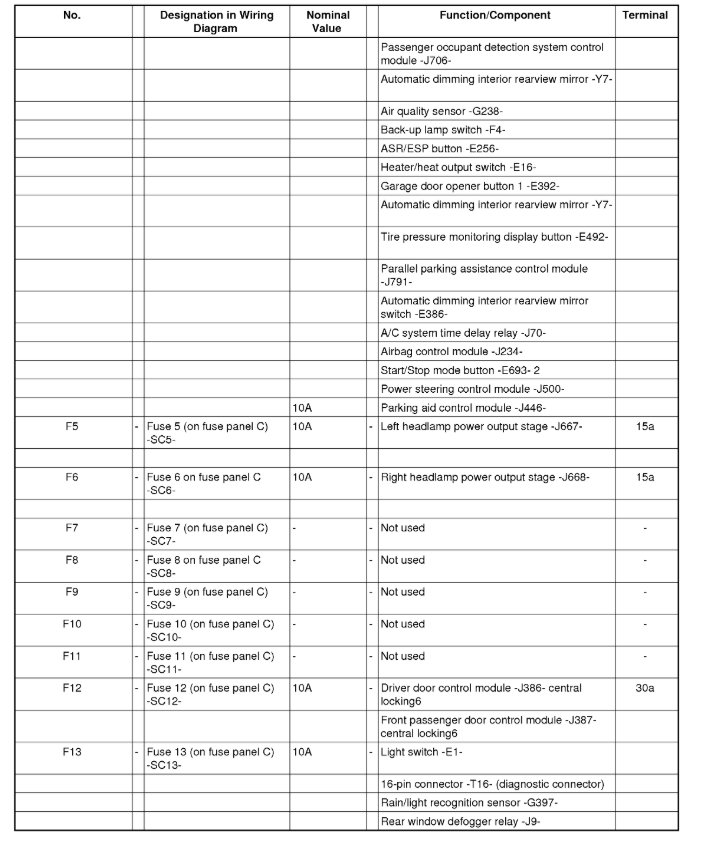

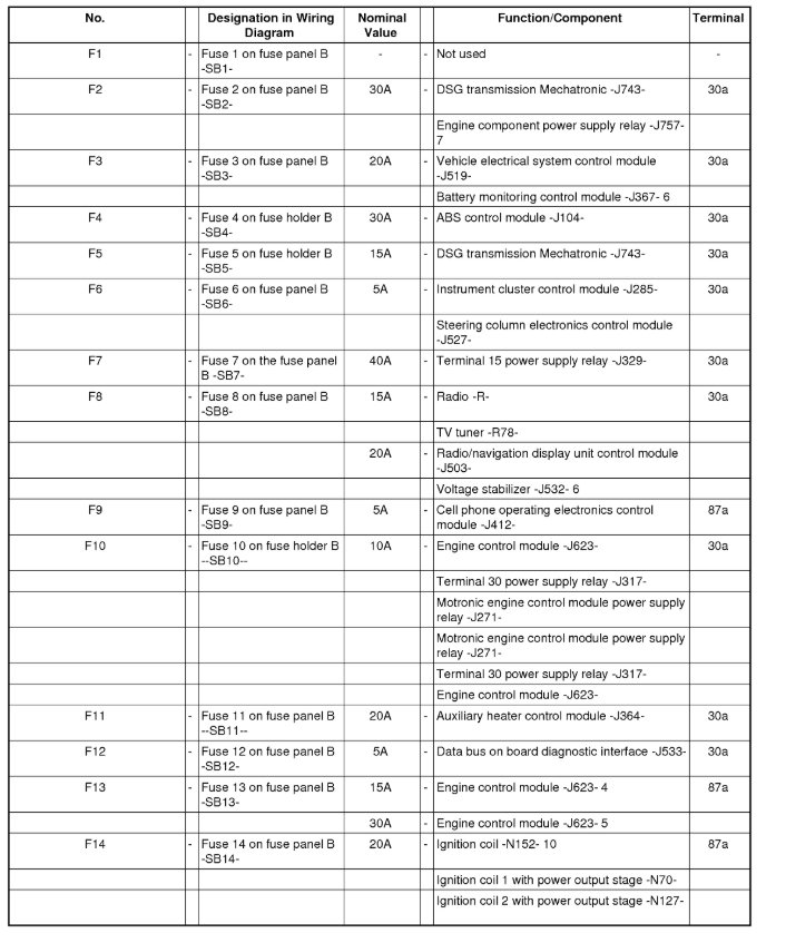

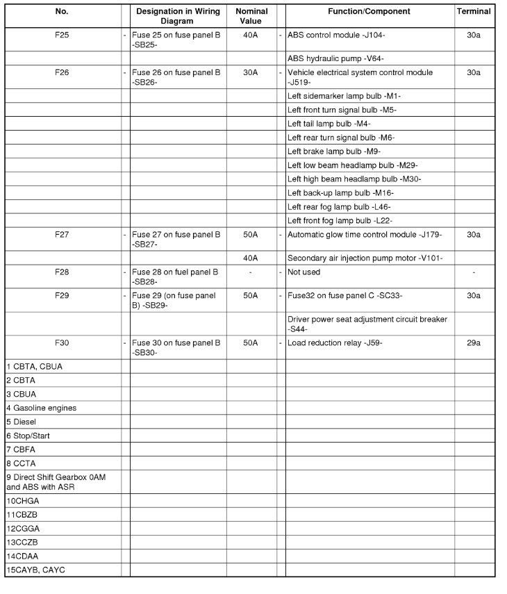

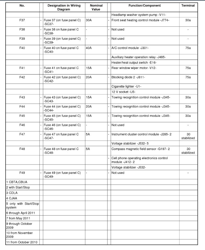

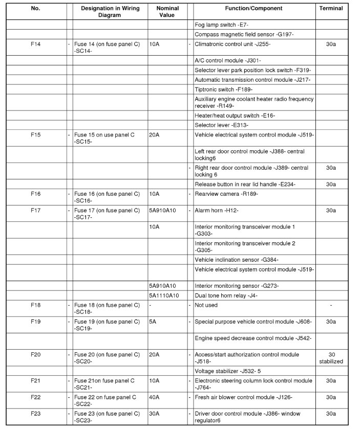

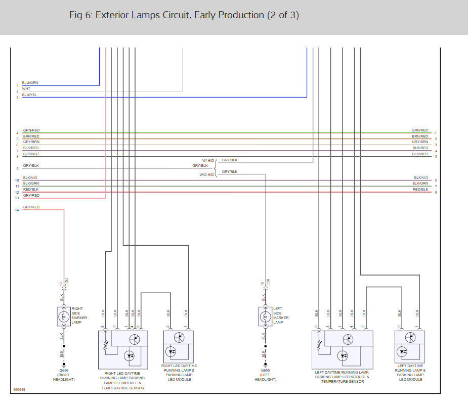

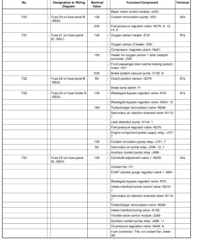

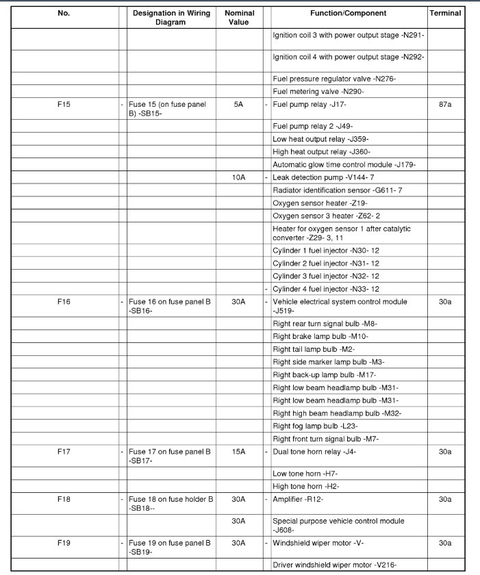

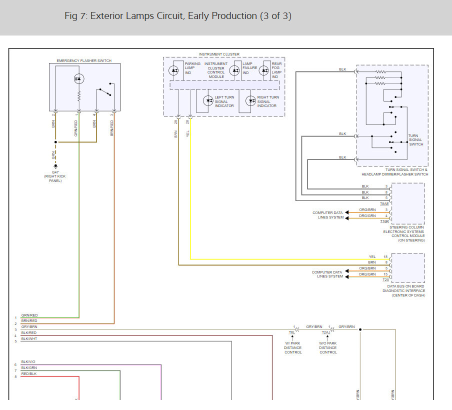

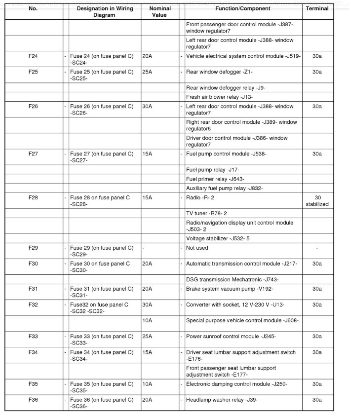

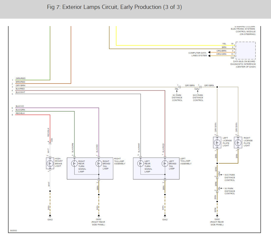

There are four fuses (2, 13, 26 and 16) that run the system. we need to check those first. here is a guide to help test for power and the blinker wiring diagrams so you can see how it works with the fuse location as well:
