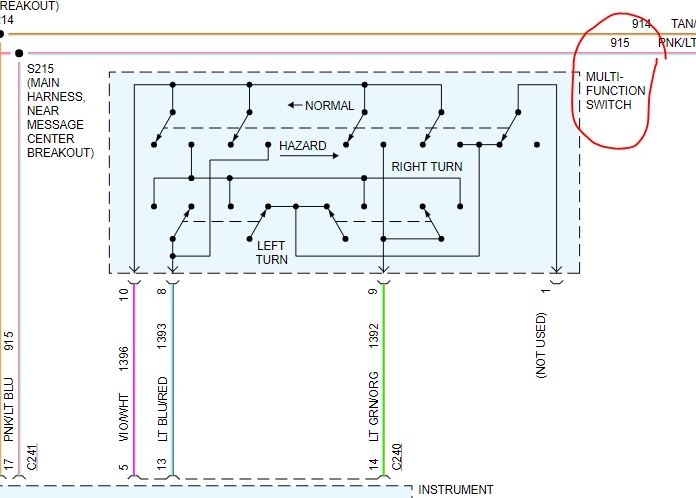

Front and back signals and hazard lights not working. checked fuses, bulb, both good.. replaced flasher relay.. still not working.

There is a change it is the multi function switch on the steering column. If you look at the attached pic, you'll see that both the flashers and signals are powered through that switch. However, I need to know something. Do the light turn on and not flash or is there nothing?

Inside/outside- left turn comes on steady light..not flashing.
Right side does nothing.
Hazards inside come on steady. not flashing.
Wipers work, high beams work.

You indicate the flashers stay on steady. Do both sides of the exterior light come on? If not and only one side, I suspect the switch has failed. I have a flow chart if you want to check the multi function switch operation. It is somewhat involved, but I'm happy to provide it if you feel it will help.
