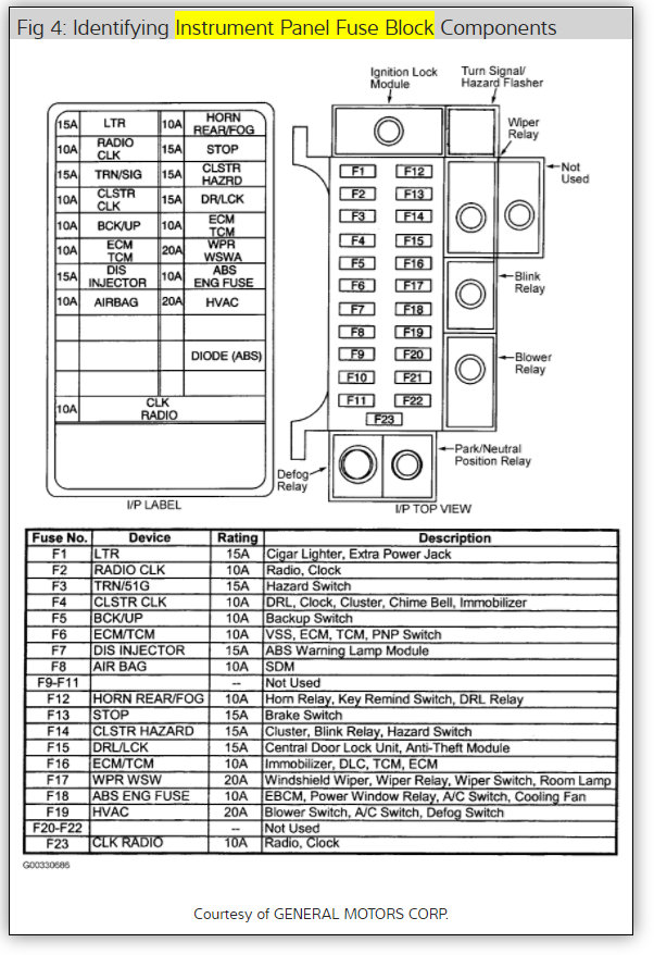

I am new to the site. As described in the title, my turn signals, hazard and intermittent wipers (first speed) are not working. Here is what i tried:
I checked the fuses, all in good condition.
I checked the flasher relay (driver side) and replaced it, fixed nothing.

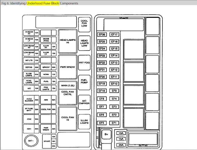

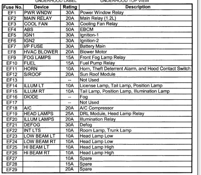

I replaced the main fuse collector (down the fuse box under hood) just in case plastic melted. Still nothing.
Of course checked all the bulbs and are all in good condition and working when i use my remote key to open or close the car.
I checked around the bulbs, connectors and wires to see if there is a short somewhere, nothing seems bad.
I do not know what to do next, any helping suggestions would be appreciated!
Thanks

Let start by checking for power at fuse #17 20 amp this should tell us which way to go. I know you checked the fuse but I need to know if there is power there.
Here is a guide:
Check out the fuse panel diagrams (below).
