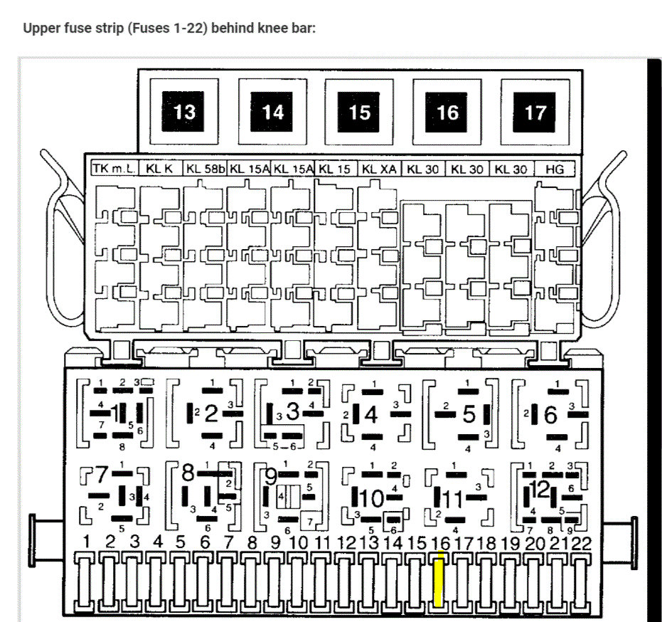

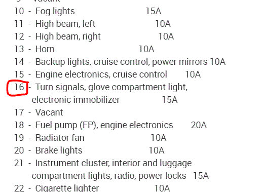

So my turn signals failed after starting the car and driving for about 5-10 minutes. I’ve replaced the hazard switch and what I think is the fuses. However I’m not completely sure they are the correct fuses. Can you tell me exactly where the fuses are for the turn signals? The vehicle listed above is a camper. Thanks!

I attached two pics below. One is from the fuse legend and the other shows fuse (highlighted). Now keep in mind, if this vehicle went through a body company for the camper upgrade, they all have different ways of doing things.
