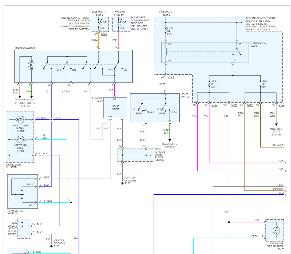

My turn signals don't work but my flashers do, so the bulbs are good.
I've replaced the multi switch on the column, the green flasher relay under the dash, and the fuses are good.
What next? Isn't that everything?
Thank you in advance for any information!
May 29, 2023 at 6:19 AM
  • 55,758 POSTS

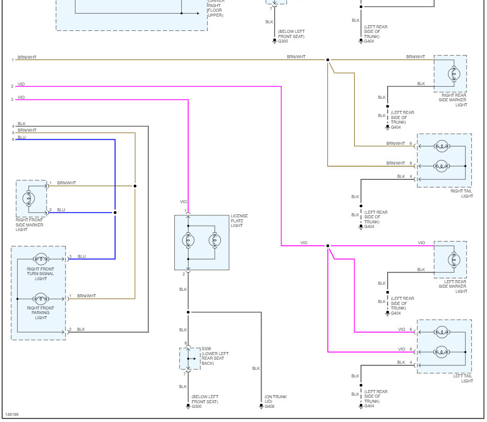

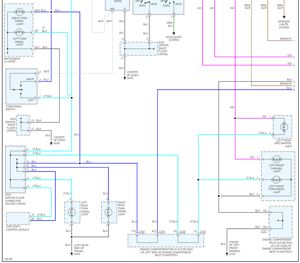

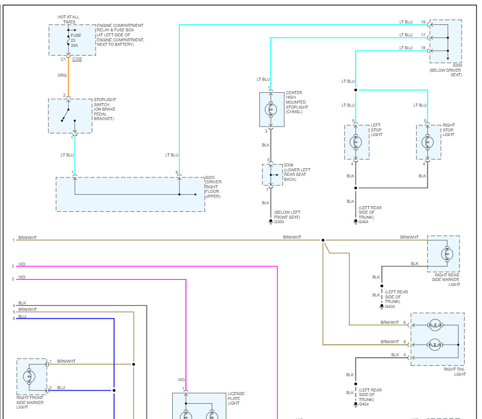

I would make sure there is power at the fuses # 12 (engine bay) and #11 (interior fuse panel) here is a guide that can help, and I have included the blinker wiring diagrams so you can see how the system works and where you might be losing power.
