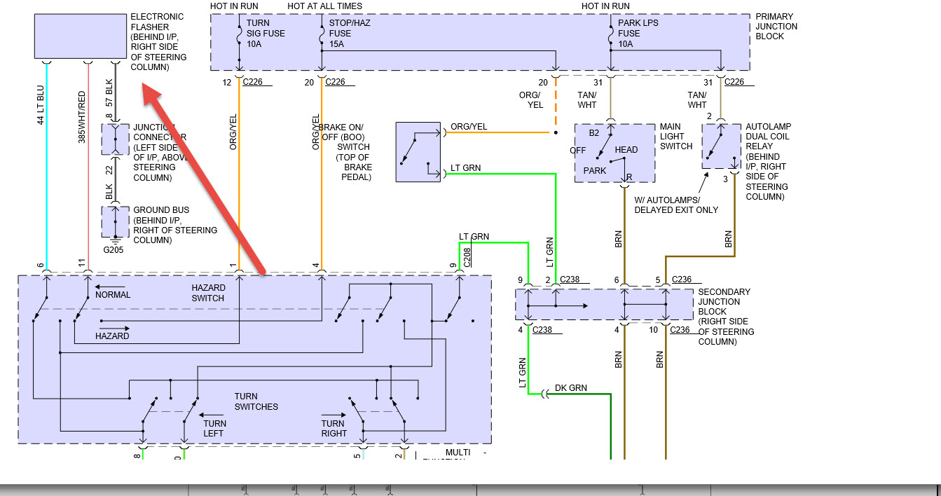

Turn signals, brake lights and the hazard lights have stopped working. All of the fuses are good.

check flasher first then check multi function switch it may not be carrying the current from flasher or stop light switch to bulbs. I am assuming bulbs are good as well. see picture.
