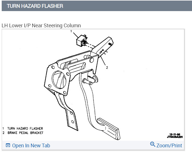

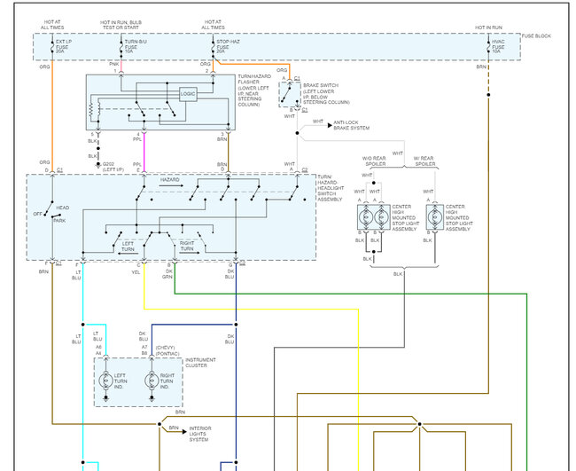

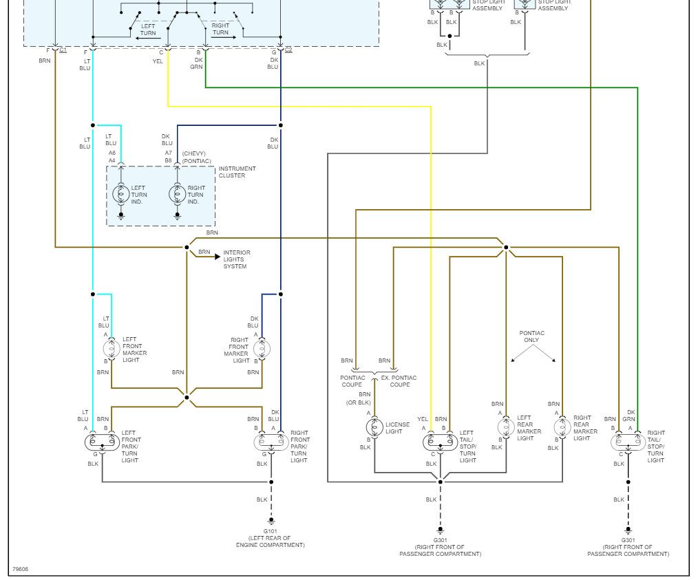

Okay here is a guide to help you test the short to ground and the blinker wiring diagrams so you can see which wires to test and how the system works, I had a thought it might be the turn signal flasher so I would swap that out as well.
