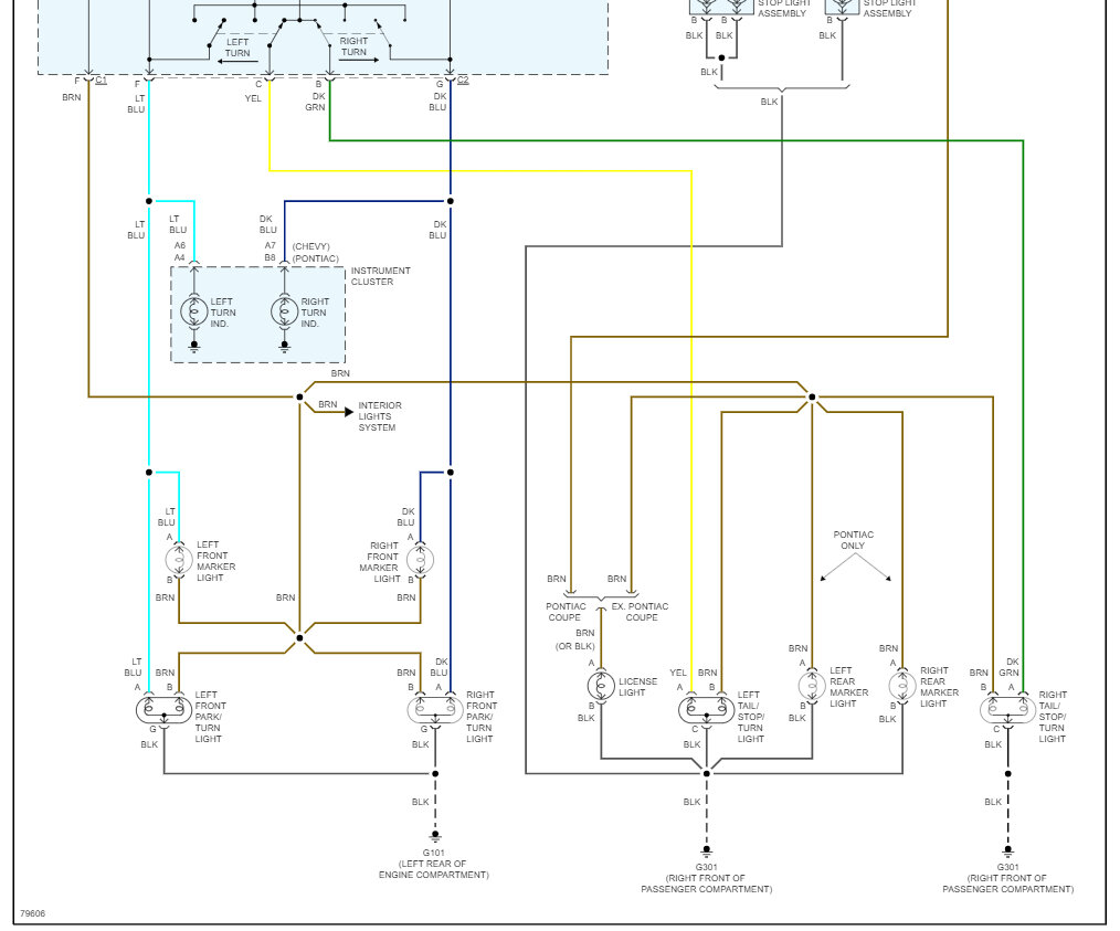

Car keeps blowing fuses, have replaced everything on this car associated with the issue (relay, fuses, switch, wires, etc.,). Mechanic now thinks Alternator is over charging blowing the fuses, is this a possibility?

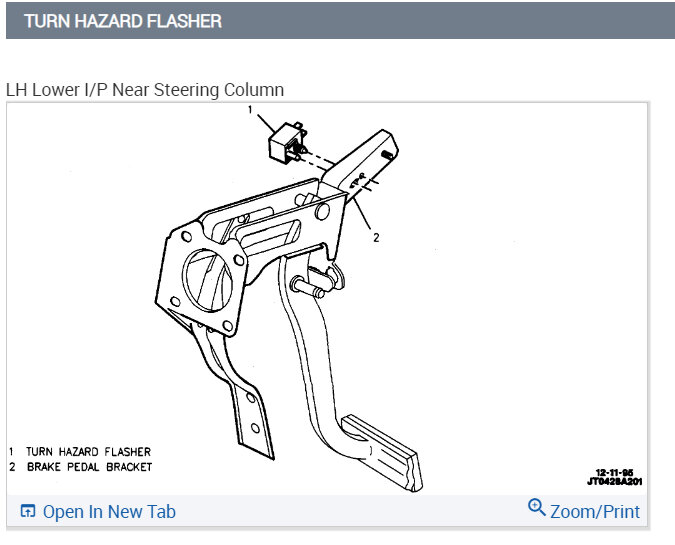

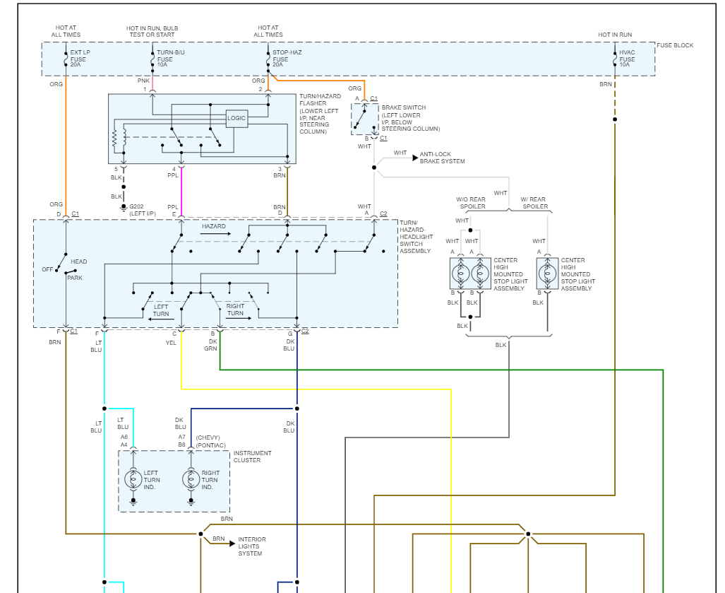

Okay here is a guide to help you test the short to ground and the blinker wiring diagrams so you can see which wires to test and how the system works, I had a thought it might be the turn signal flasher so I would swap that out as well.
