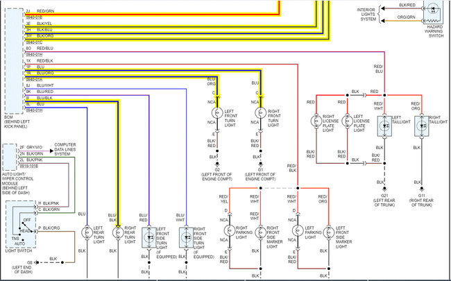

Turn signals and hazards went out and I’m trying to fix them. so, I brought a multimeter to try to test it and I’m unsure on how to use it.
Sep 28, 2021 at 11:02 AM
  • 110,194 POSTS
As far as the multimeter, here is a link that will explain how one is used. Take a look through it and let me know if it helps.

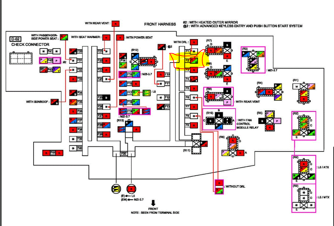

Now, if they all stopped at the same time, the first thing to check is the fuse. If you look at pic 1 below, I provided the legend of the under-hood fuse box. Check fuse 2. Highlighted it in the pic.
In addition to checking the fuse, confirm there is power to and from it. Here is a link that you may find helpful:
You can use a test light or the multimeter you now have.

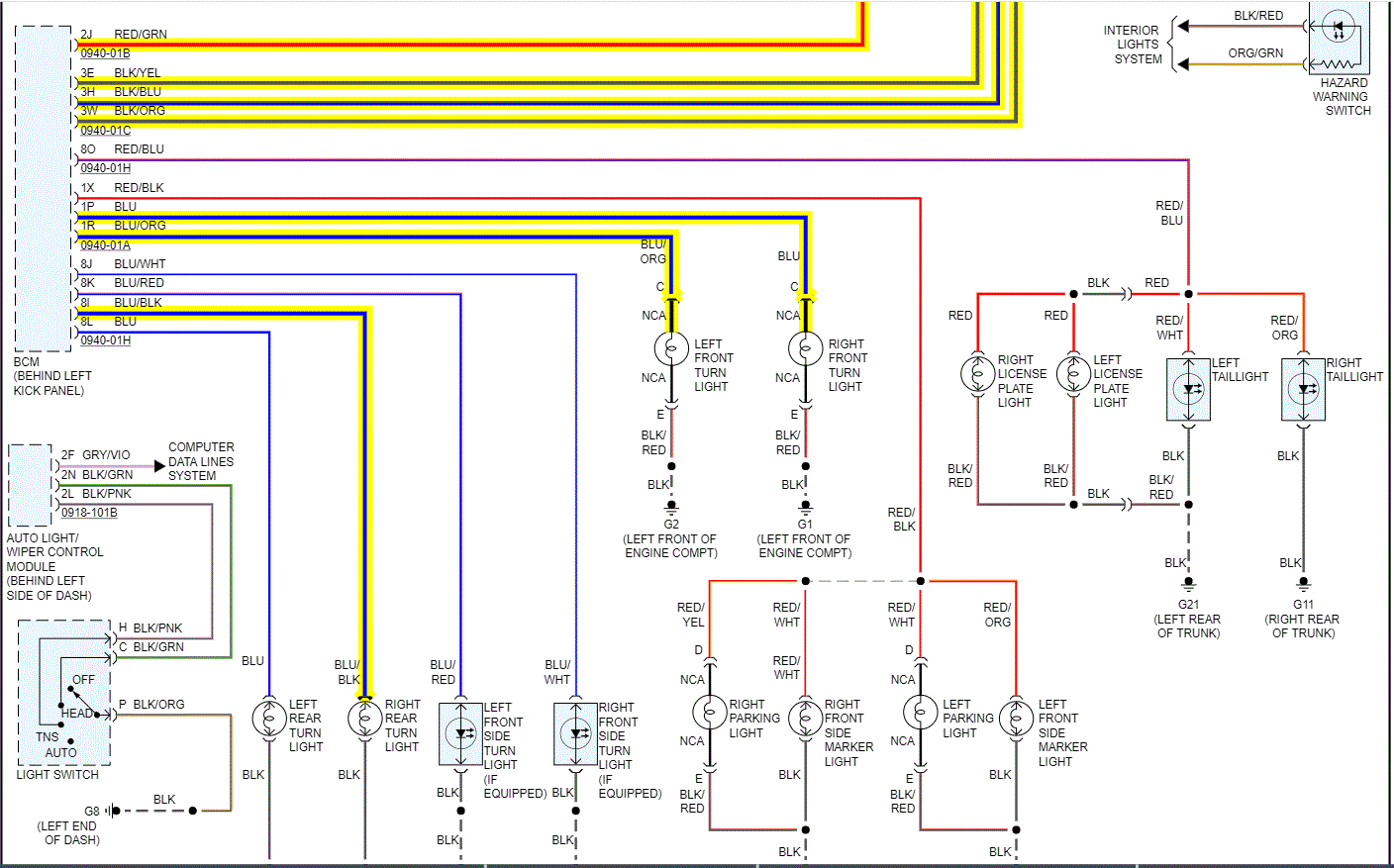

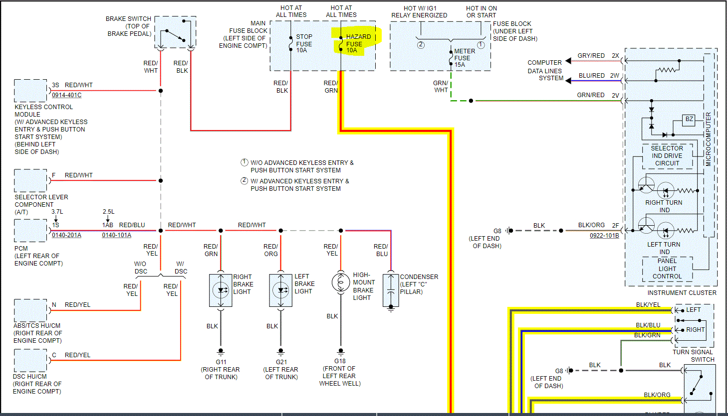

The remaining pics are of the exterior lighting system. Highlighted the fuse. Power from the fuse goes to the body control module and then to the signal/hazard switch. If the fuse is good, then we will need to confirm if there is power to the switch. However, let's focus on the fuse first. I did highlight the wires involved.
Let me know what you find or if you have questions.
See pics below. Note: The schematic was one page long. I had to cut it in half to make it readable for you. However, I did overlap them so you can follow from one to the next.

Hey, so I used the multimeter on my battery and it’s at about 7.9 volts. And I check all the fuses and they also look good.
Sep 30, 2021 at 12:01 PM
  • 110,194 POSTS
The battery needs to be recharged. It should be at 12v. If it is 7.9v, it can cause all kinds of different electrical issues.

Hey. so, I used the multimeter on the fuses, and they do have power so it must be the battery that needs to be charged.
Oct 1, 2021 at 8:42 AM
  • 110,194 POSTS
Were they showing battery voltage (7.9v)? If so, the battery is where I certainly would start. If you have a charger, you can do it yourself. If you don't, a parts store will likely do it for you. Once it's charged, also have them load test the battery to make sure it's good.
