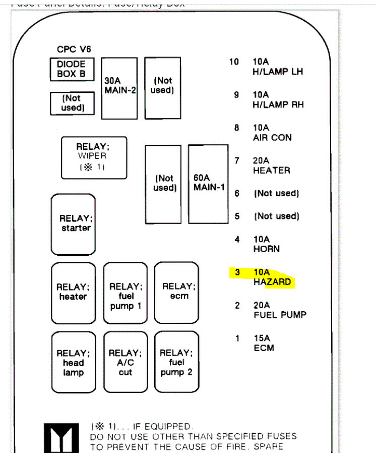

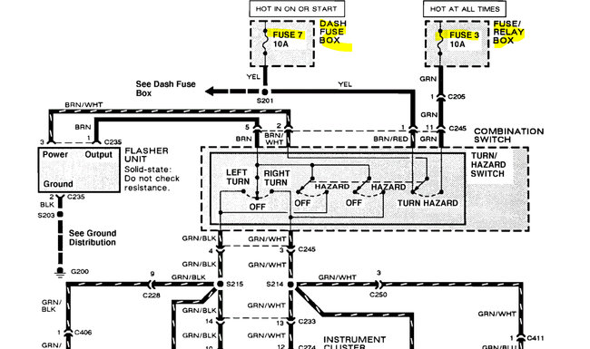

i turn on turn signal i hear the blinker working inside of the car but no lights flash inside dash or outside, both left and right flasher lights work.
Dec 17, 2021 at 12:23 PM
HPESAT
left side went out first then right side after a while few weeks maybe.
Dec 17, 2021 at 12:32 PM
  • 110,244 POSTS

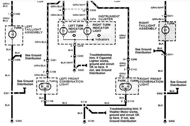

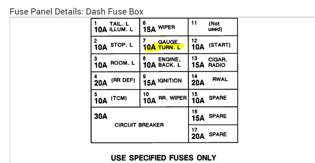

If you hear the relay, then power is getting to that point and no further. Can you tell me if the hazard lights work?
Also, I attached pics below of the wiring schematic for the signals/hazard lights. I need you to test the two fuses indicated. One is in the under-hood fuse box and the other in the interior fuse box. See pics 3 and 4 for fuse orientation.
Next, when testing a fuse, it is not only important to confirm the fuse is good, but also you need to make sure there is power to and from it. Here is a link that explains how that is done.
Let me know about the flashers and fuses.
