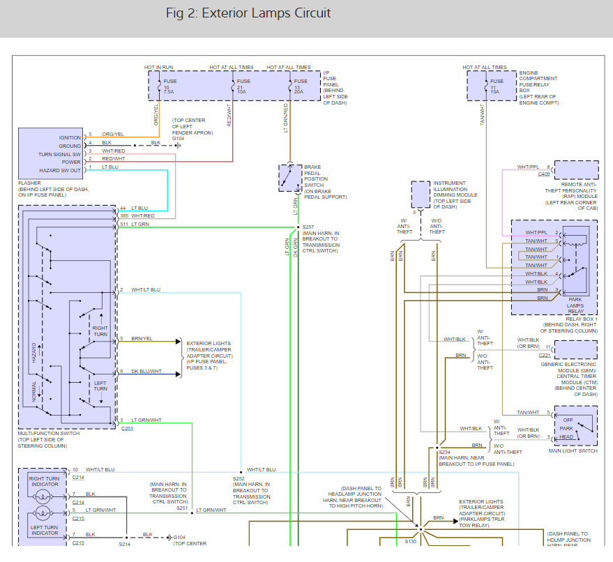

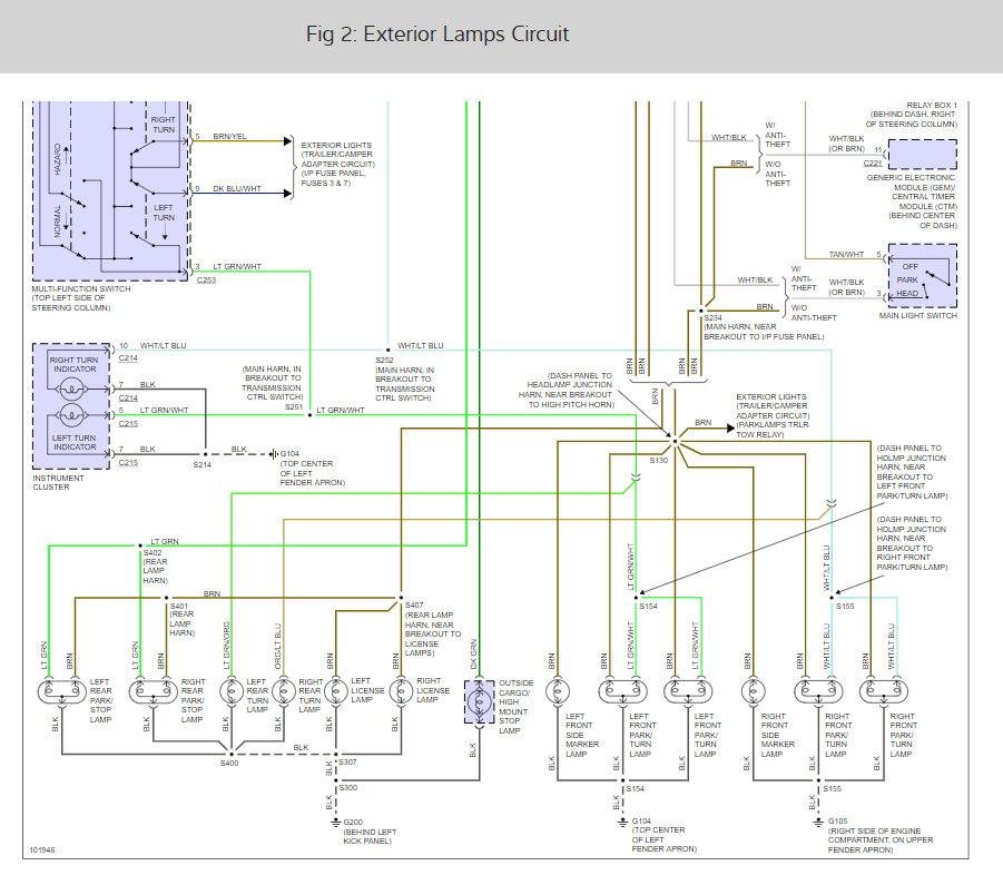

I recently replaced the wiper motor plug and multi-function switch. Before, the problem was wipers inoperable. Now the wipers work along with everything else, but the turn signals do not work.

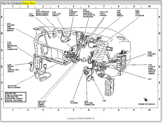

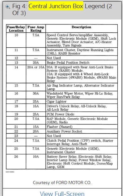

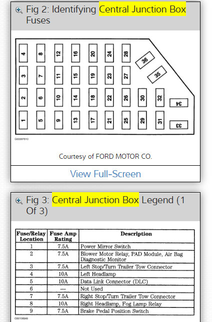

It sounds like a fuse (#10, 21,13,11) is out, but to be sure lets use this guide and the wiring diagrams so you can see how the system works and the fuse locations as well.

Hello Ken! Thank you for your prompt reply and the helpful schematic images. I checked all of the fuzes and they were good. I dug back into my installation of the new multifunction switch and found that one of the plugs in the module plug cluster was improperly seated. Once I reseated the plugs the turn signals worked fine. Thanks for your assistance.
