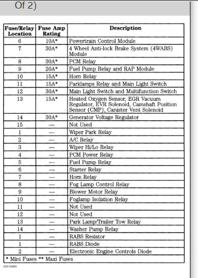

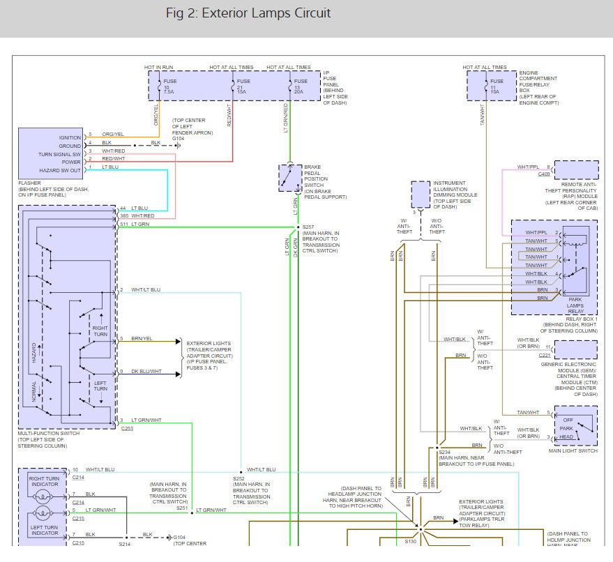

I recently replaced the wiper motor plug and multi-function switch. Before, the problem was wipers inoperable. Now the wipers work along with everything else, but the turn signals do not work.
Nov 27, 2018 at 3:00 AM
  • 55,423 POSTS

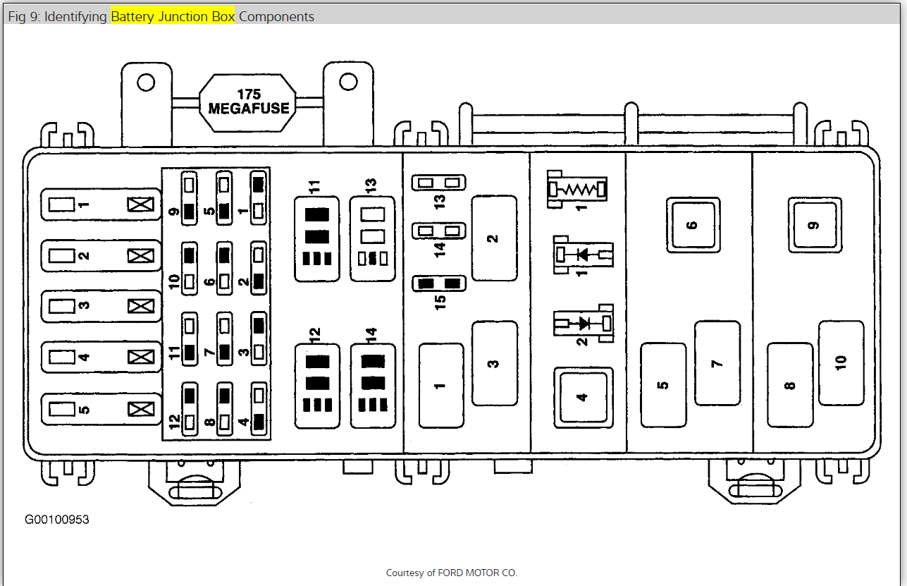

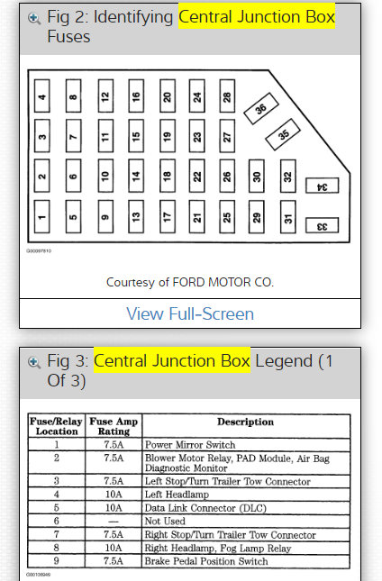

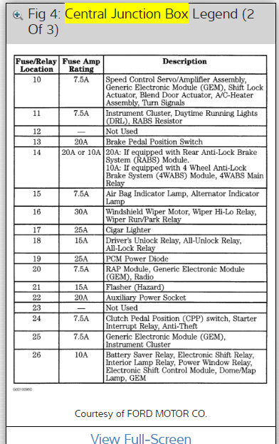

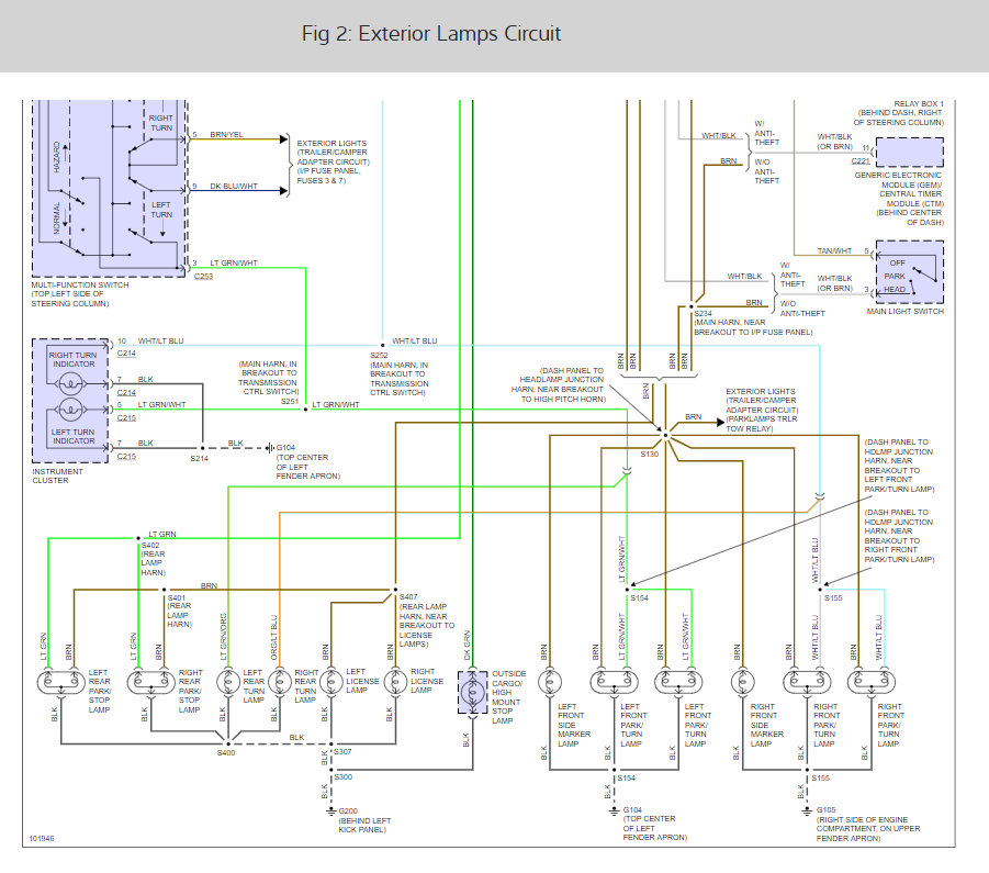

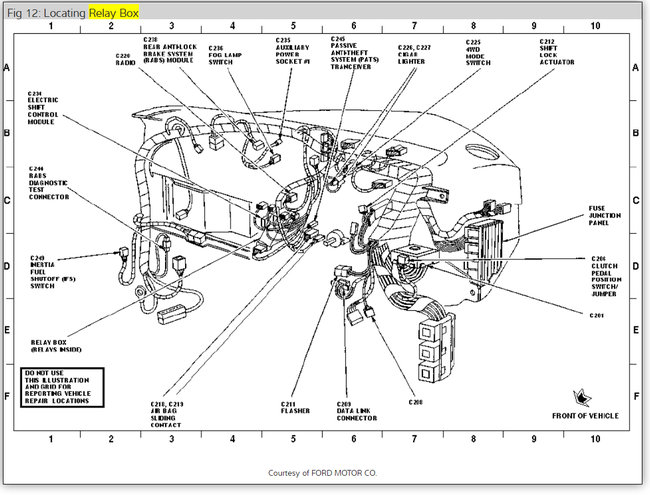

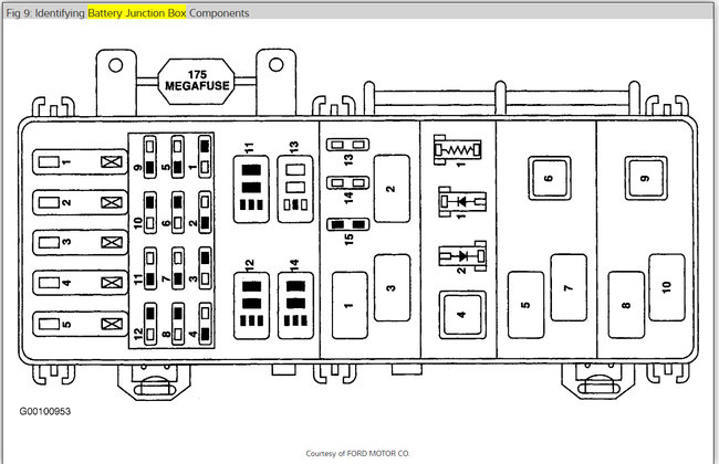

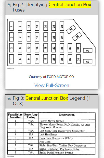

It sounds like a fuse (#10, 21,13,11) is out, but to be sure lets use this guide and the wiring diagrams so you can see how the system works and the fuse locations as well.
Jun 2, 2021 at 6:51 AM
FRANKJAMES
Hello Ken! Thank you for your prompt reply and the helpful schematic images. I checked all of the fuzes and they were good. I dug back into my installation of the new multifunction switch and found that one of the plugs in the module plug cluster was improperly seated. Once I reseated the plugs the turn signals worked fine. Thanks for your assistance.
