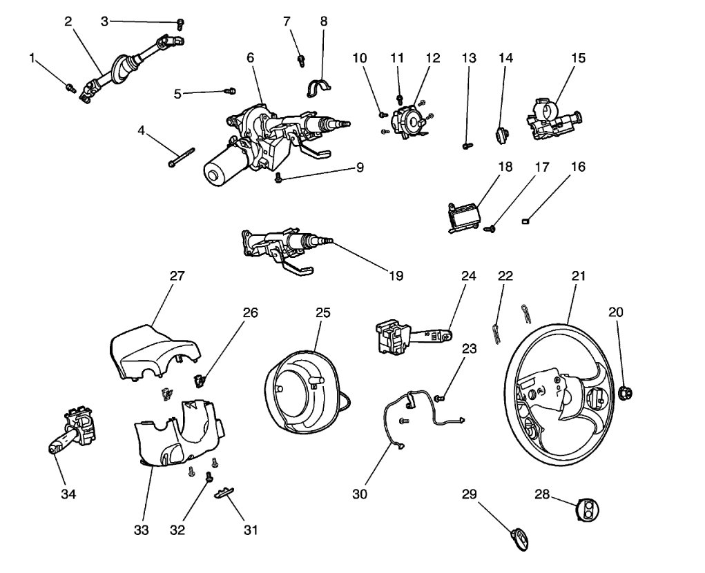

My turn signals stopped auto shut-off. They work but I have to turn them off manually.
How can this be resolved?

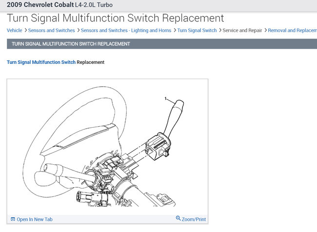

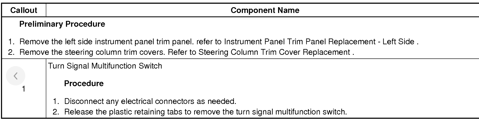

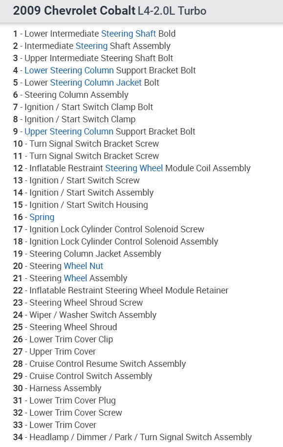

The return tang on the turn signal switch has broken which happens. Here are guides to help you get the switch replaced.
