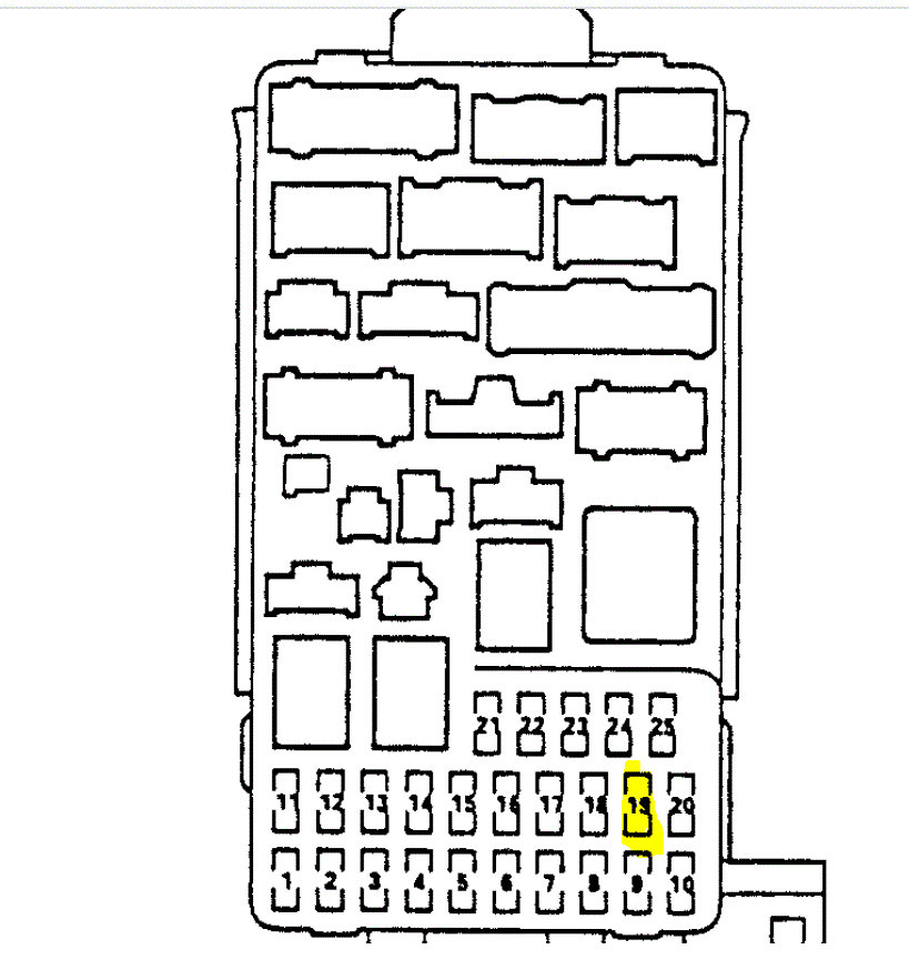

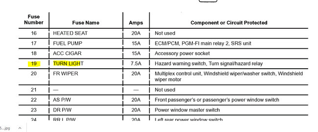

My turn signals don't work not even clicking or anything. I replaced the turn signal relay and nothing yet.
Mar 26, 2020 at 2:44 AM
  • 110,240 POSTS
The first thing I need you to check is fuse 19 in the under dash fuse box. I attached two pics to help locate it. In addition to just checking the fuse, confirm there is a good connection for the fuse and you need to confirm there is power available to it.
