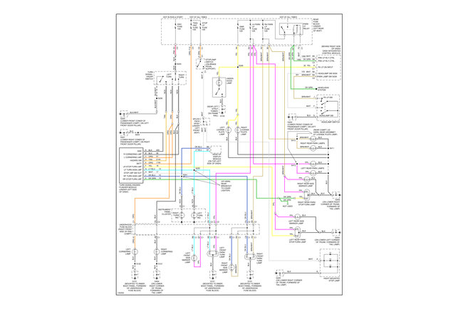

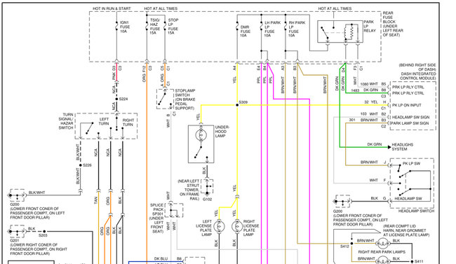

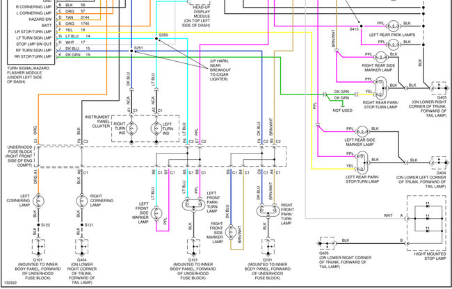

turn signals not working but lights blink when hazard lights are turned on. replaced hazard switch and replaced turn signal switch assembly. and turn signals still won't work, i have been trying to find a lighting wiring diagram to see if i can trouble shoot the problem.

Please see the images below. I had to split the diagram in two parts. Please let us know how you get along. Check out the diagrams (Below). Please let us know if you need anything else to get the problem fixed.
Cheers, Boris
