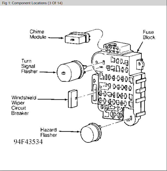

Turn signals not working
130,004 MILES • 4.0L • 6 CYL • 4WD • AUTOMATIC
DMOSE10
But everything thing else is. flashers bright, turn on wiper works, but no turn signals. replaced turn signal switch. checked fuses, everything good. but i do not know what’s going on. help please lol

Hi and welcome to 2CarPros.
I looked up the vehicle and it does not have a turn signal relay so my suggestion would be to check the circuit fuse and or change the flasher. You will find the flasher location in the diagram below.
Let me know what you find, Rich.
