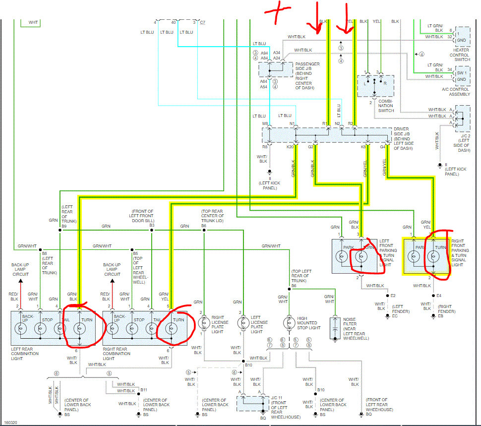

Turn signals quit working
2002 TOYOTA CAMRY
160,000 MILES • 6 CYL • 2WD • AUTOMATIC
PAULA.DOLL

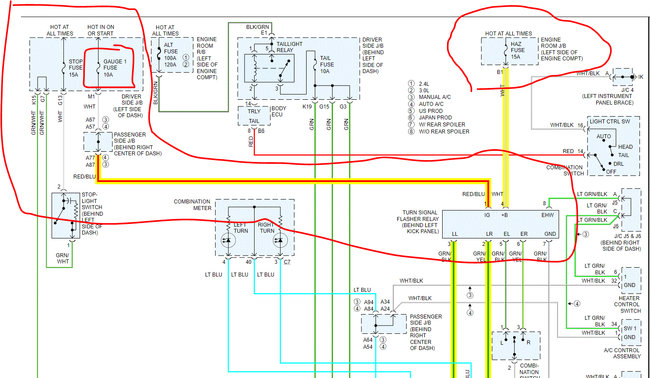

Hazard lights and all other lights work. Give me some ideas where to look. All fuses have been replaced also.
Feb 7, 2020 at 12:10 PM
  • 110,194 POSTS
Interestingly, the flashers have their own fuse, and the signals are a switch power from a different fuse. I attached two pics below. In the first pic shows the fuse I need you to confirm is good. If it checks good, then confirm there is power at the fuse.
The second pic simply shows how power then goes through the switch and to the lights.
