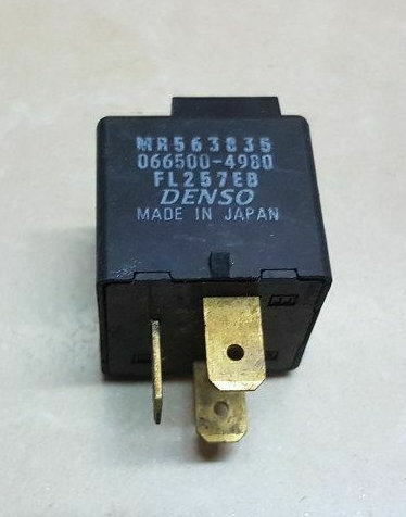

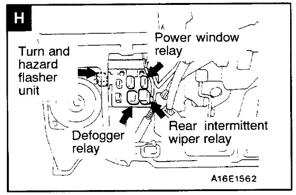

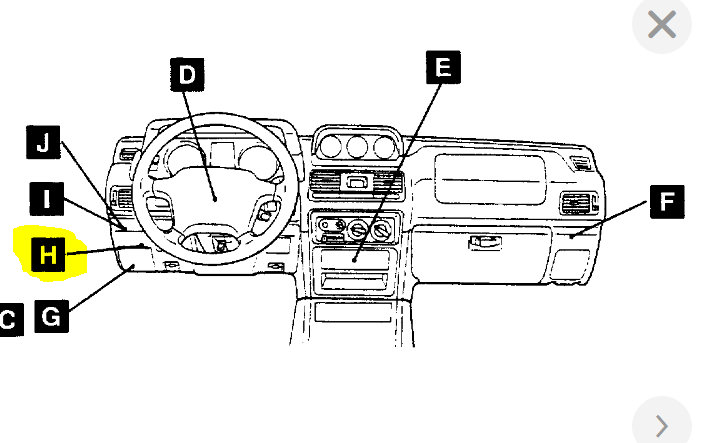

Cannot find flasher for turn signals.
Aug 4, 2022 at 2:27 PM
SQM
Experienced Mechanic
6,383 POSTS
The flasher relay is located next to the fuse panel located below the left side of the steering wheel.
I have attached diagrams below for your reference.
Let me know of any questions.
