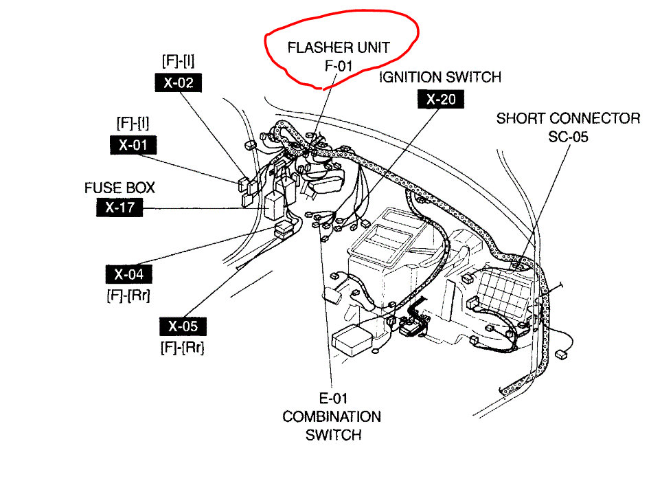

My turn signals occasionally. I'll get one blink, then nothing, or no blinking at all. Other times they blink normally for about 20-30 seconds. They light up properly when they actually blink, so it's not a burnt out bulb. And it's both sides. No other lights are effected.
Wednesday, April 22nd, 2020 AT 7:57 PM
  • 109,867 POSTS
I have a feeling it is a bad turn signal flasher. It is located under the dash on the driver's side. I attached a picture of location. A flasher isn't expensive. This is what I would try first.
Here is a link you should find helpful:
https://www.2carpros.com/articles/turn-signals-not-working-blinker
Let me know if this helps.
