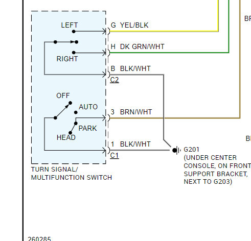

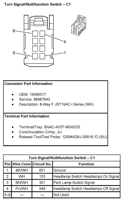

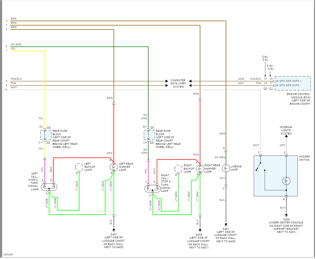

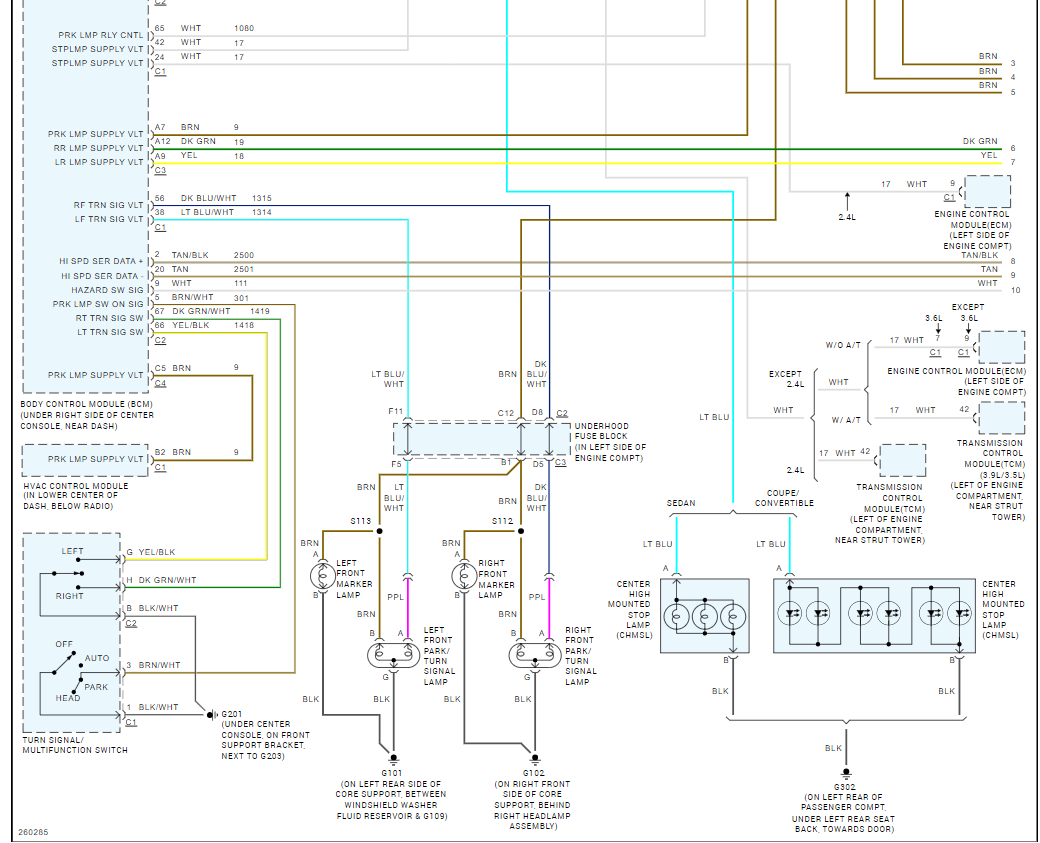

The 4 wires (yellow, brown, orange, and red) pulled out from the connection which has 1,2,3 and 4 on it. What color goes to what number connection?
Jul 13, 2024 at 5:52 AM
  • 55,649 POSTS

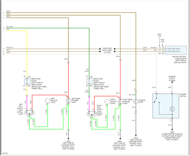

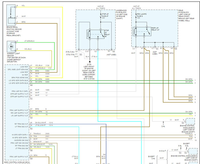

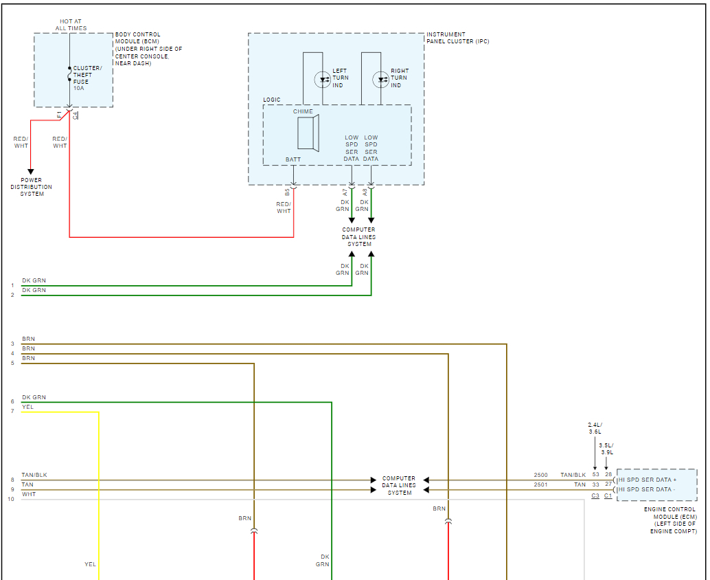

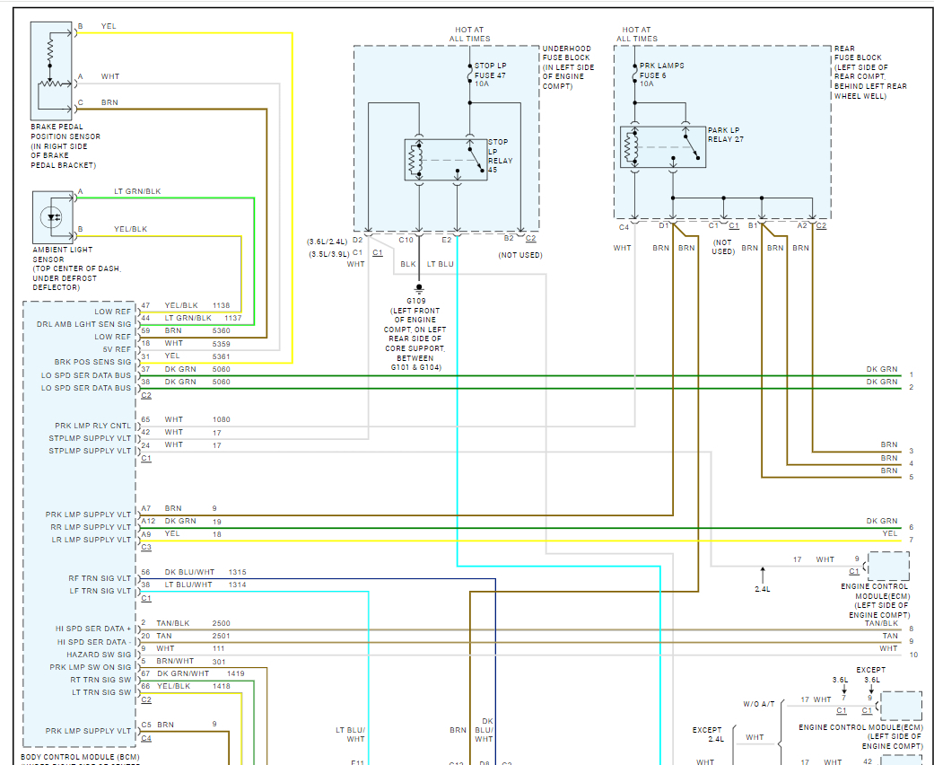

Sure, here are the wiring diagrams for the blinkers so you can see how the system works and the connector view for the turn signal switch. Check out the images (below). Please let us know what happens.
