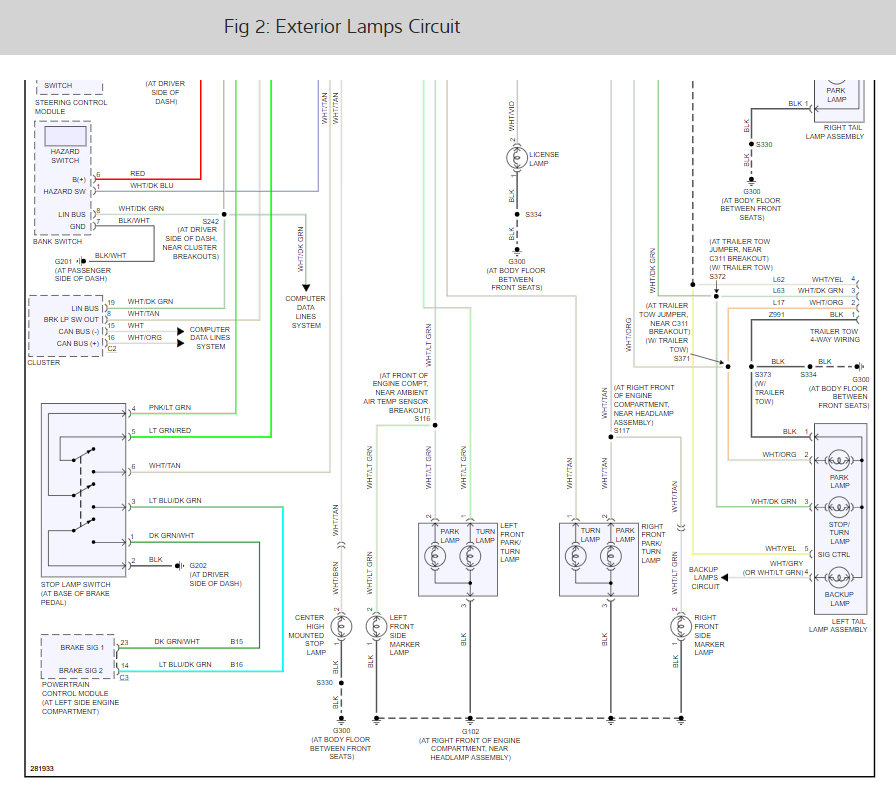

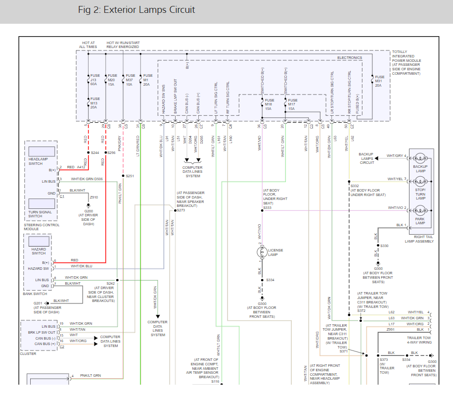

My turn signal flashes fast like the bulb is out, but replaced it and still flashes fast.It also does this at random The marker light also is always out.
Sep 28, 2019 at 6:36 AM
  • 55,770 POSTS

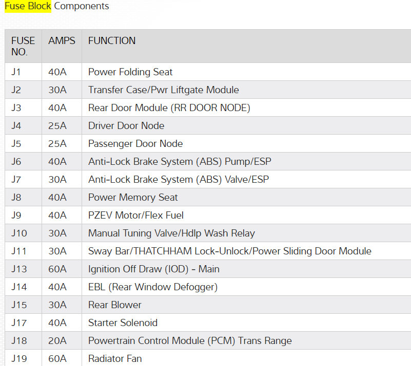

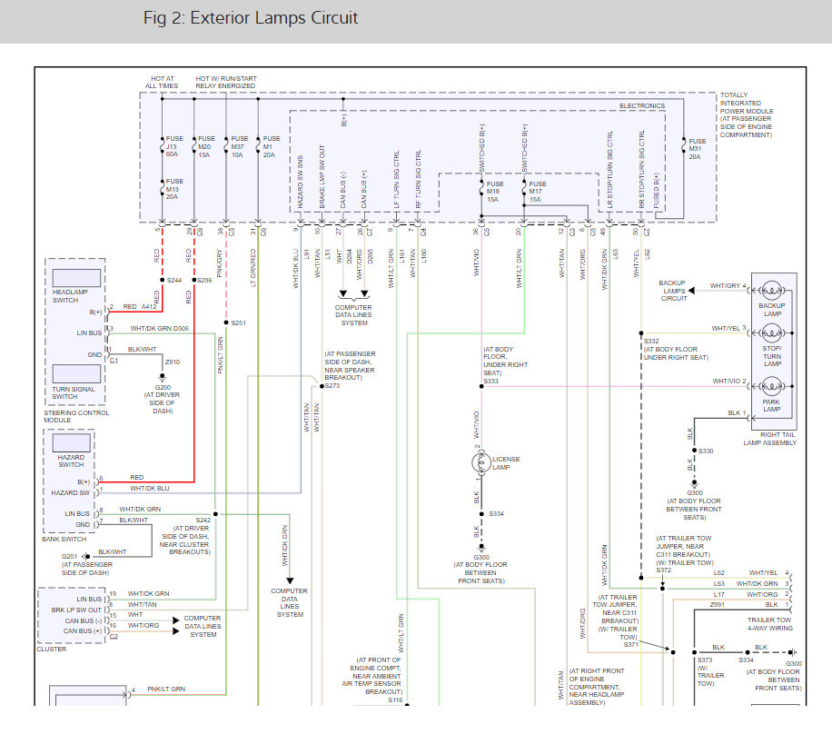

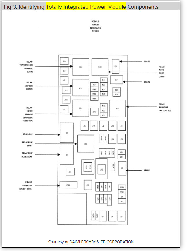

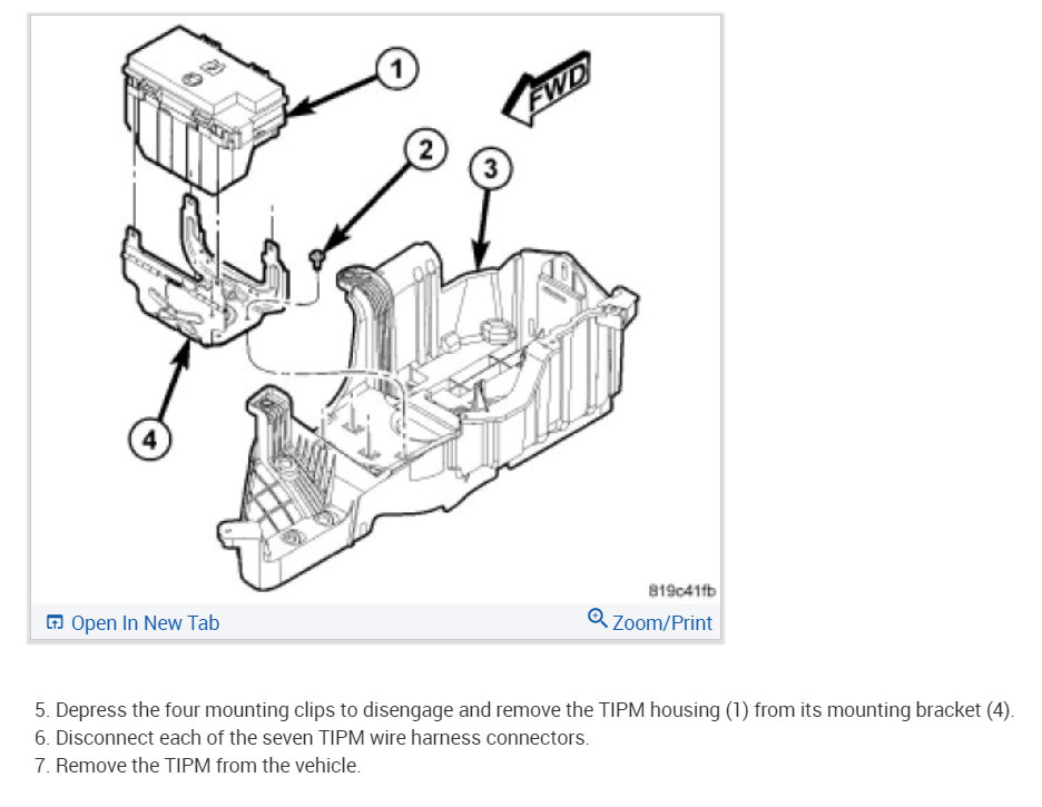

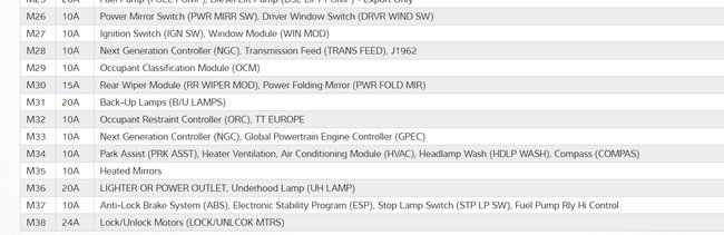

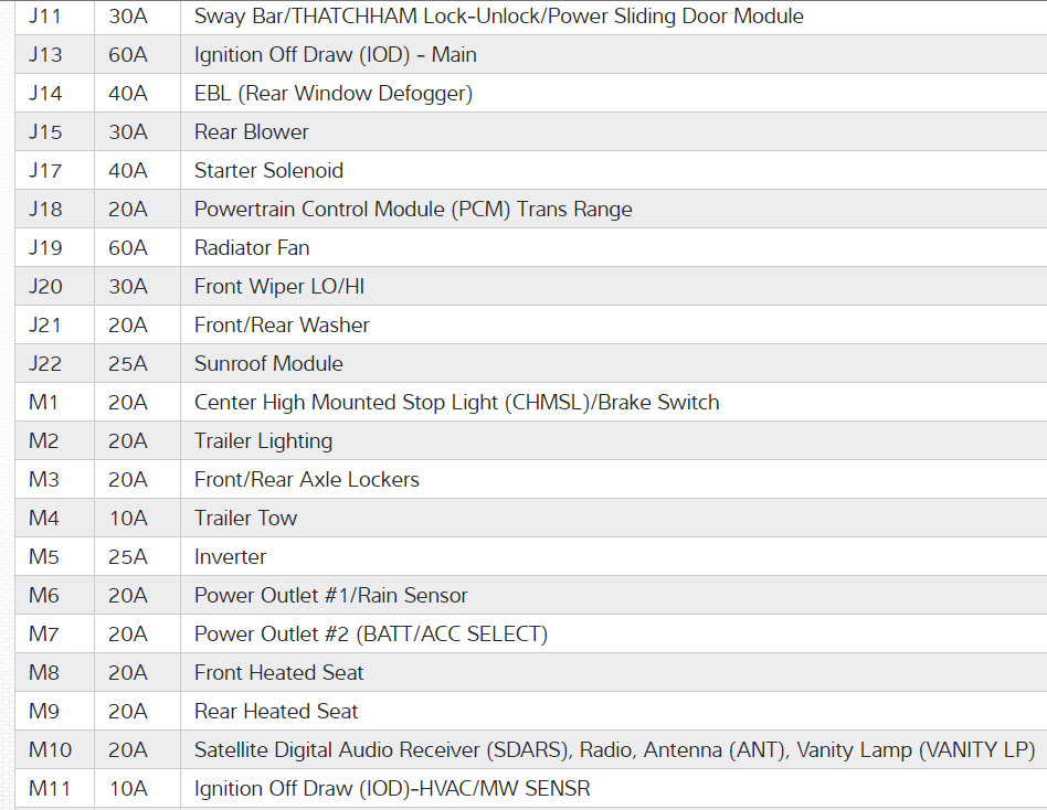

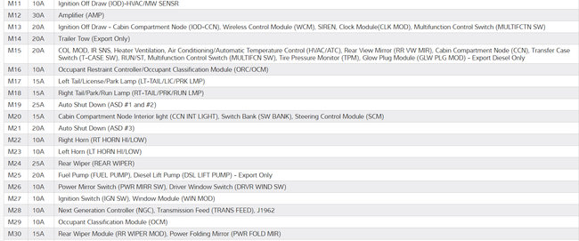

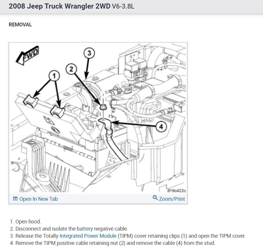

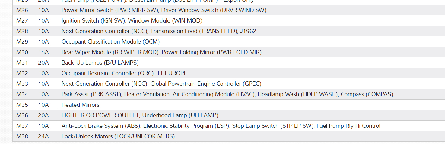

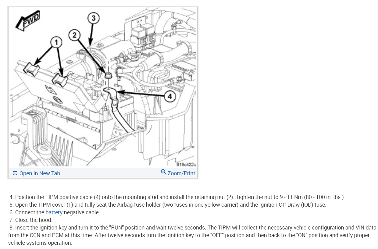

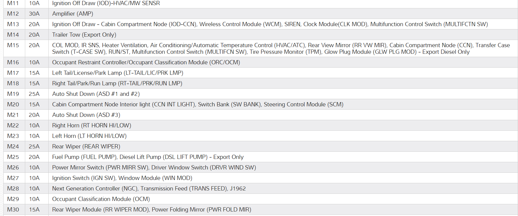

This lighting system is controlled by the TIPM which has 8 fuses that run the system. Lets check the fuses first here is a guide to help with the turn signal wiring diagrams with the fuse locations and to see how the system works as well, if everything looks okay the TIPM is out which is common but they are easy to replace because they self initialize.
