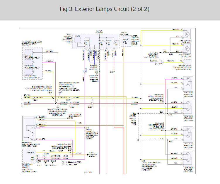

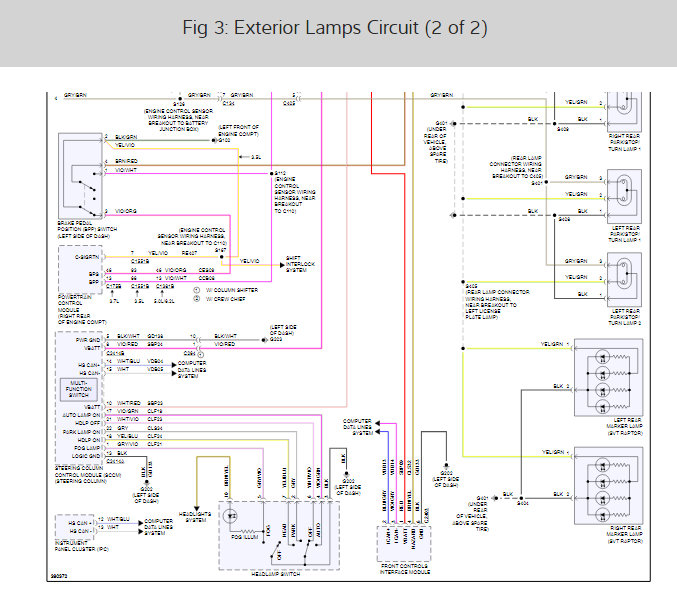

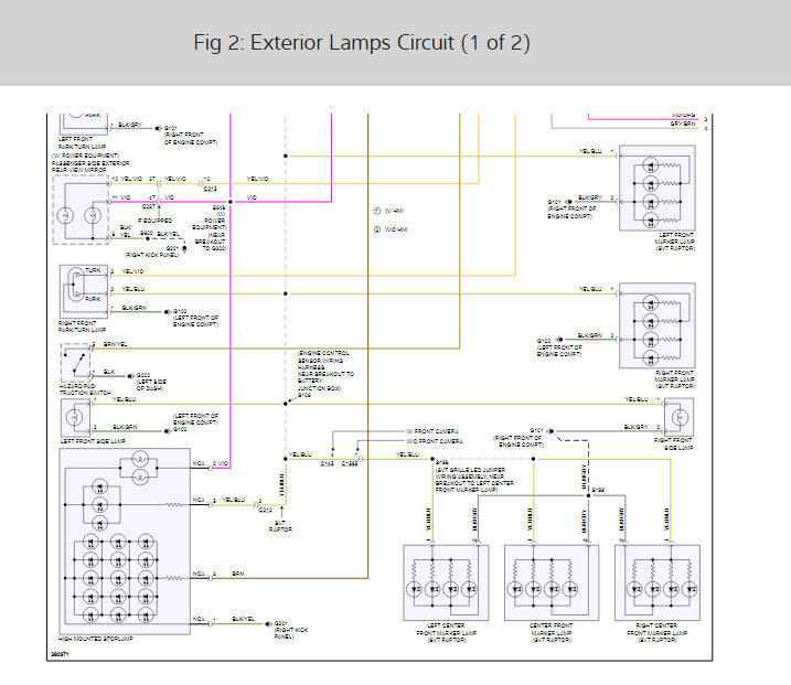

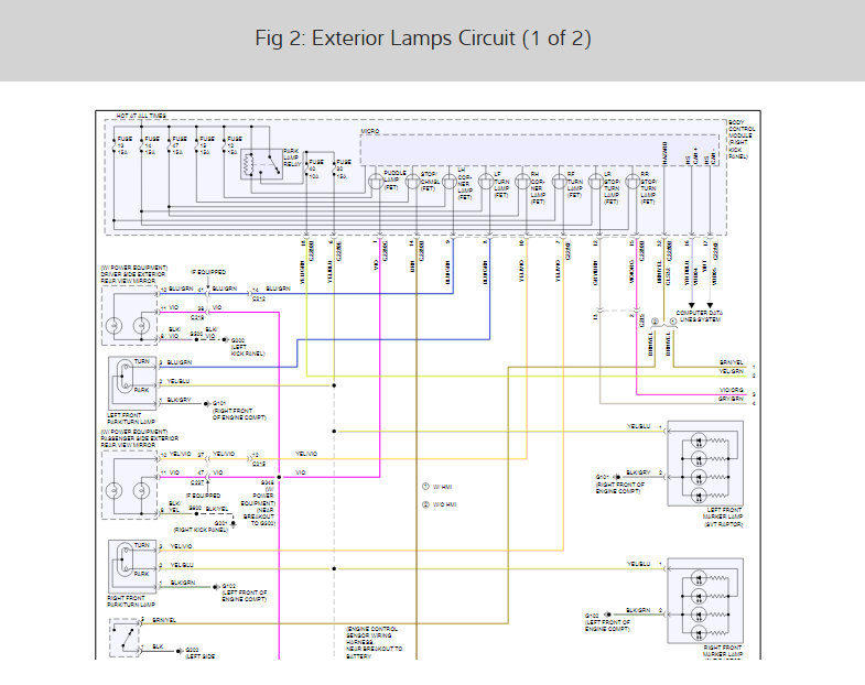

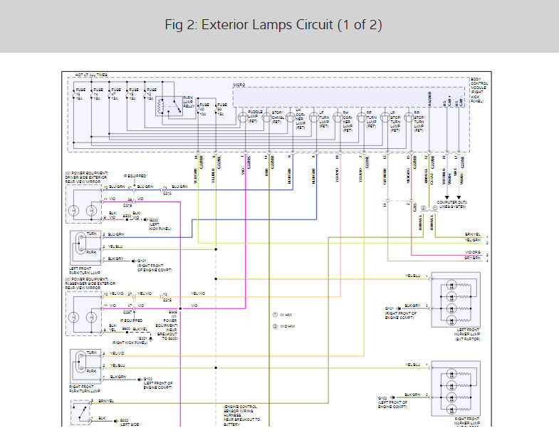

The left turn signal flashes twice as fast as right. All signal lamps flash as selected, brake lights work normally, multi-function switch replaced with new Motorcraft unit of same part number. Left signal takes approximately 3 seconds to hear relay operation although flashing starts immediately. Can not locate signal flasher. I am an aircraft mechanic and understand schematics if I have them.
Aug 3, 2019 at 8:38 AM
SCGRANTURISMO
  • 4,897 POSTS
You have no idea how refreshing that it is to hear. I have included the exterior lightning wiring diagrams in the diagrams down below for you. I also have the trailer towing package wiring diagram available for you if needed. Please keep us informed as to what you are able to find out, like a bad transistor or something like that.

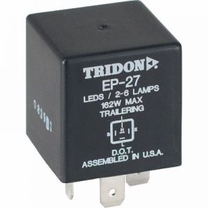

test to see if power is going to bulbs with a test light first. if it is check for a bad ground on frame. if no power it can be bad turn sig switch or shorted wire. Here is the flasher

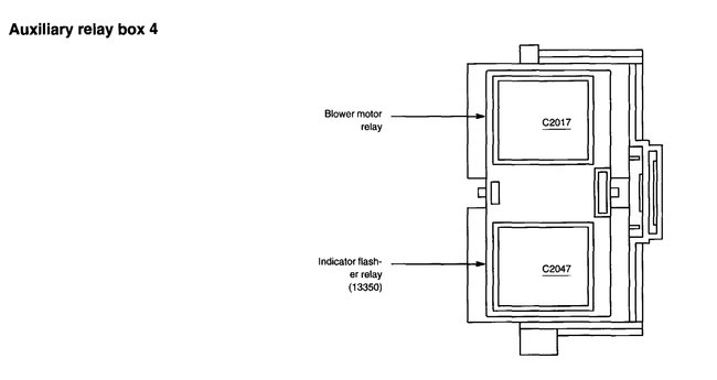

JOSELARES
where is the electronic flasher located on a 2003 ford f150
Oct 14, 2020 at 6:55 AM (Merged)
BLUELIGHTNIN6
  • 16,542 POSTS
In relay block to the right of the steering wheel column under the dash. The block is black with a black relay and flasher installed, could be covered in tape depending on the manufacturing plant your truck was built at.
You will need a flash light when you go looking for it.

It will either be under the dash in the fuse panel or under the hood in the power distribution box. Here is a picture of one.

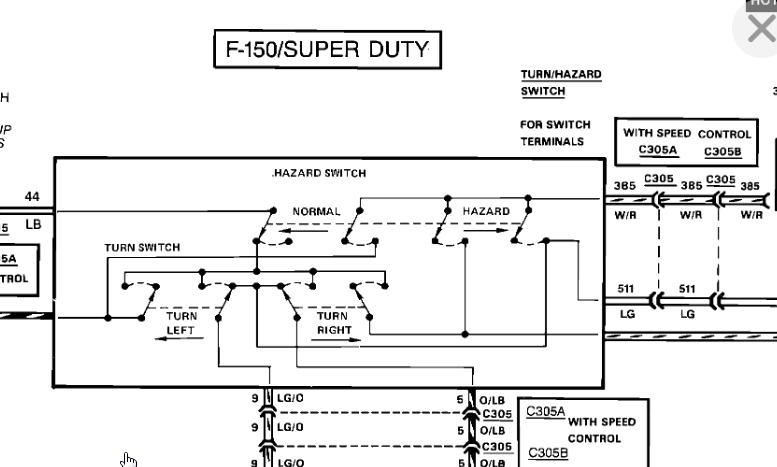

I am trying to find a picture of this but it should be part of the turn signal switch. Take a look at the wiring diagram. It shows the hazards are part of the turn signal switch. If I remember correctly, it is a small switch on the end of the turn signal switch.
I will try to find a picture and attach it here.
Oct 14, 2020 at 6:56 AM (Merged)

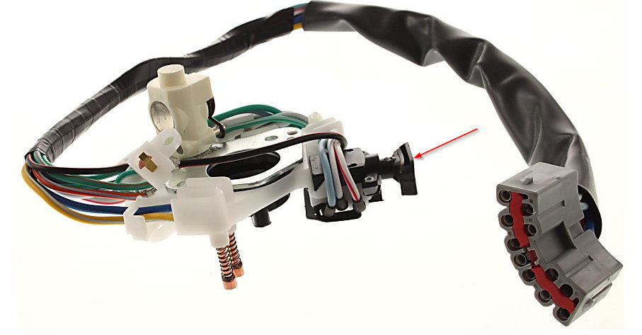

Look under the dash. I don't know why I forgot this but the switch should be under the dash by the brake pedal.
Take a look at the attachment and you will see the switch when you pull it out it turns the hazards on.
