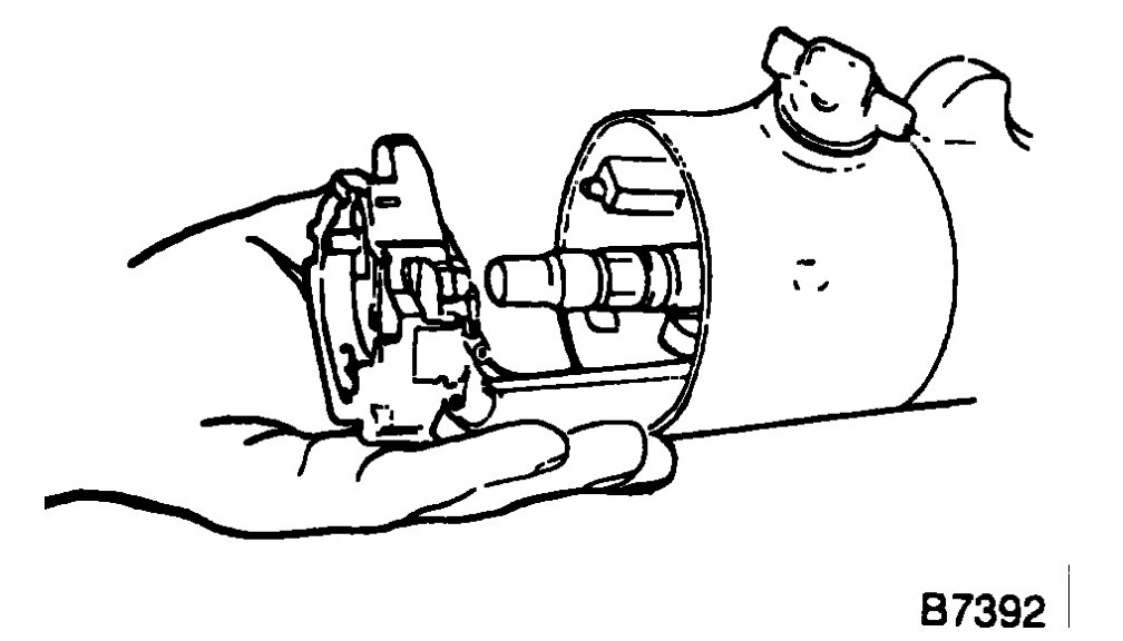

With key off it blows fuse in turn signal in fuse box.
Dec 23, 2018 at 10:17 PM
Good morning,
Try disconnecting the turn signal switch connector at the bottom of the steering column and see if the fuse still fails.
if it does, then it is a wiring harness issue.
if it does not, the the switch or wiring is bad in the column.

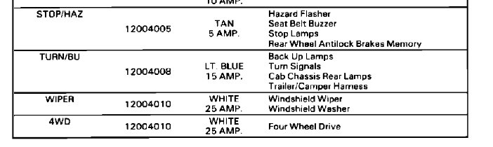

I attached a diagram of the fuse, which I think is the one you are referring to, and what it controls.
