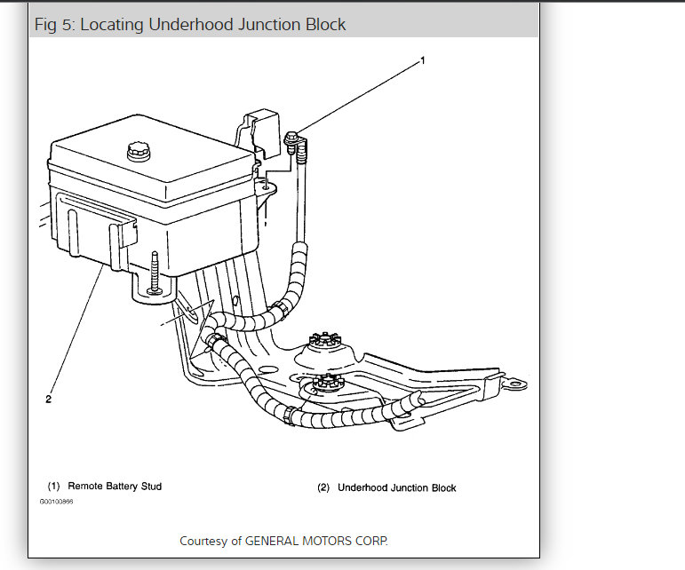

Where is the turn signal relay?
Aug 6, 2019 at 11:44 AM
SCGRANTURISMO
  • 4,897 POSTS

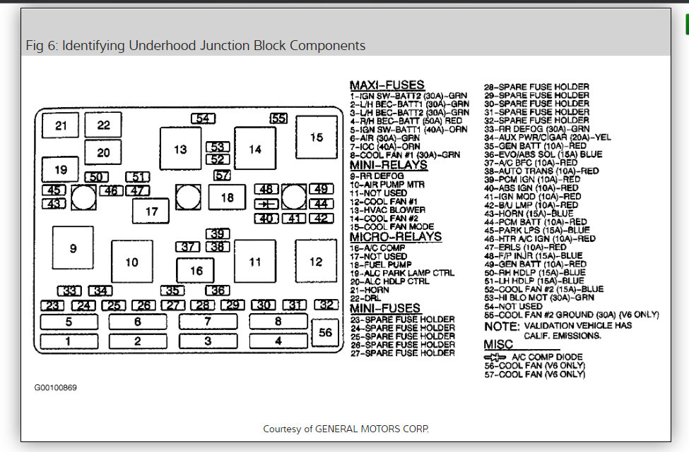

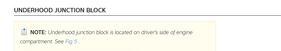

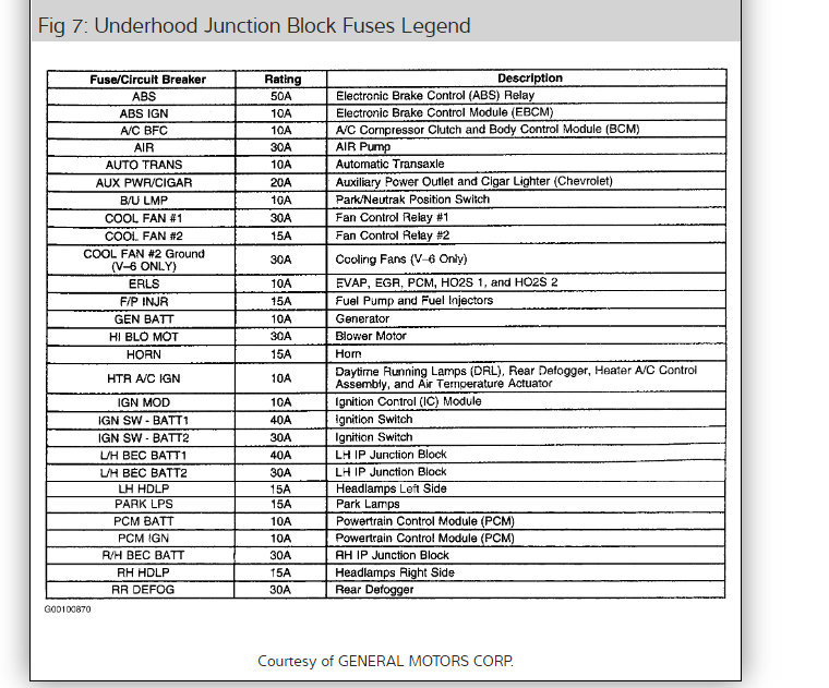

It is located in the Underhood Junction Box. I have included diagrams of the location, the Junction Box, as well as a callout for the Junction Box in the diagrams down below. Please go through these guides and get back to us with what you are able to find out.
Thanks,
Alex
