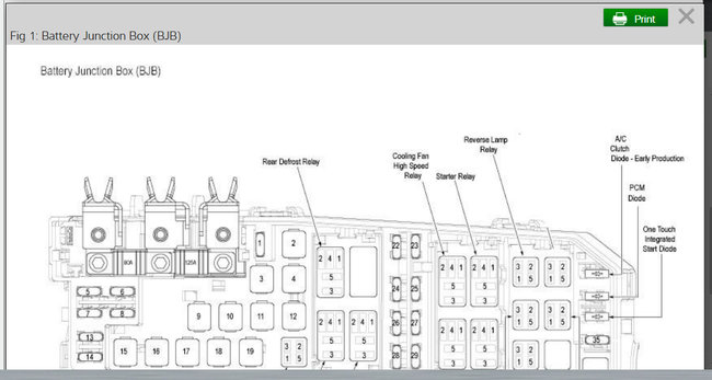

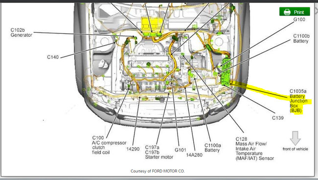

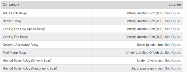

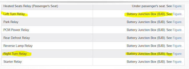

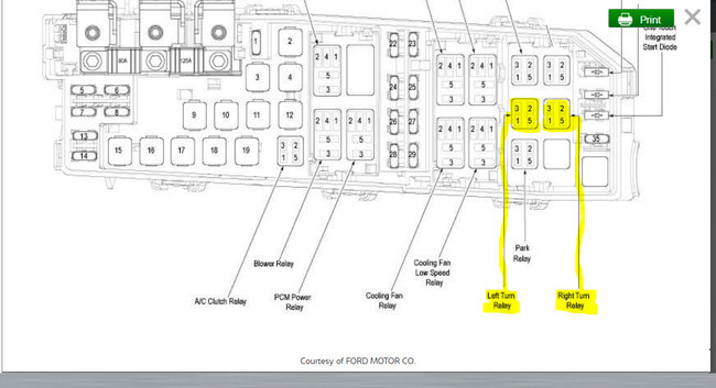

Where is the turn signal relay? I've looked in both fuse boxes and removed parts of my dash and looked in, but nothing. My rear running lights aren't working and the bulbs are fine.
Apr 25, 2019 at 6:32 PM
SCGRANTURISMO
  • 4,897 POSTS
I have included all the information that you requested in the diagrams down below. If you should have any other vehicle related questions, please feel free to ask them. It's what we do and why we are here.
