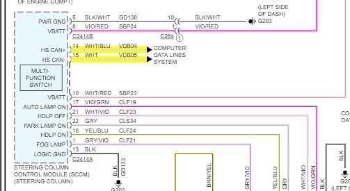

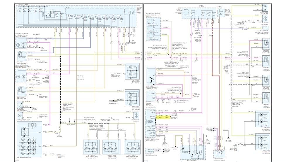

I put a new multi-function switch in because my wipers quit working properly. Now everything works properly except the turn signal. It works in lane change mode, flashes three times, but then stops. If I hold the handle it works, just not on its own. I thought it might be a bad switch so I got another one and same thing happens. Any suggestions?
Jun 6, 2019 at 7:11 AM
Good afternoon,
The signals are controlled by the Body Control Module.
The serial data line is what controls it. You command the lights to come on and a signal is sent to the module which activates the lights according to your command.
I attached a diagram for you to view.
You will need an advanced scan tool to monitor the BCM outputs.
