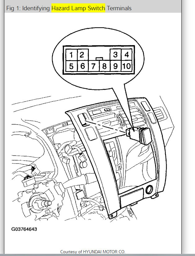

My turn signal has no activity when directed. I checked the T/Sig fuse and it is fine. The hazard light blinks every 2 to 4 minutes even when unmanned. So manually i have to press the hazard and it stopped. The next day my battery was drained maybe because of this intermittent lighting of my hazard light. I want to change the flasher what can you advise me?

Yep, it sounds like the flasher needs replacement which is the hazard switch itself. here is diagram to help you replace it. Check out the diagrams (below). Please let us know what happens.
