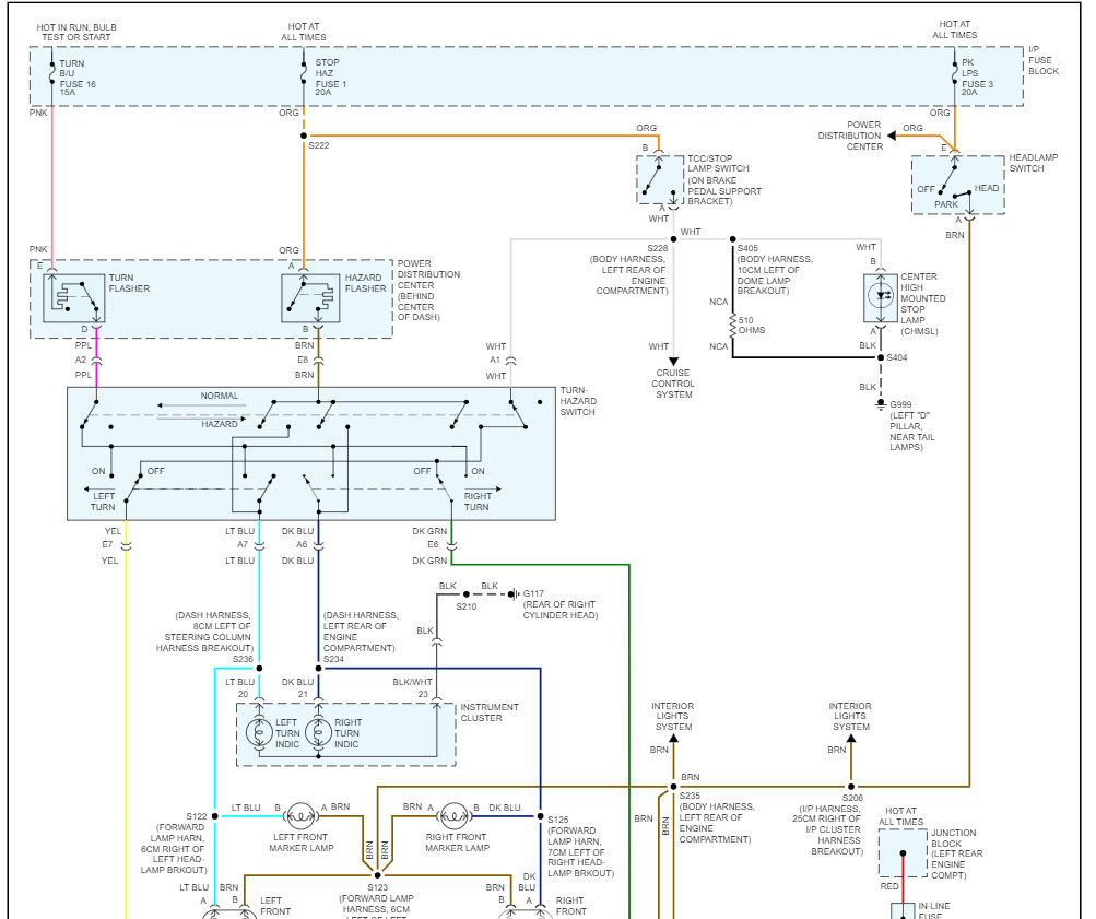

My turn signals stopped working but my hazards do so the bulbs of course are fine. Turn signal lights don't pop up on dash and the stick is staying where it should be when I move it. Checked the fuse box by my door in cab and saw volts coming through on both ends of the fuse.

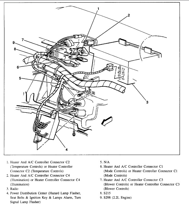

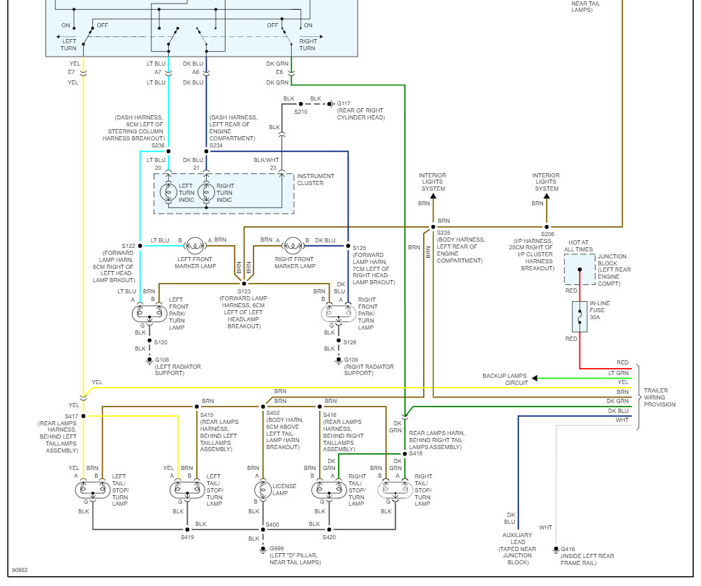

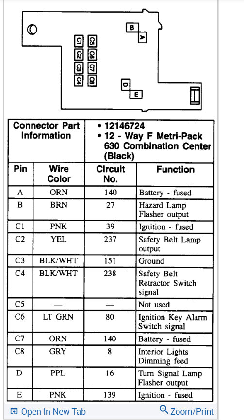

Sorry, we only handle one problem per thread, we will fix the turn signal issue on this post. It sound sliek the turn signal flasher is not working here is the location so you can check it out and I have included the blinker wiring diagrams so you can see how the system works.
The Turn Signal Flasher is located in the Power Distribution Center. The Power Distribution Center is located behind the lower center of Instrument Panel.
Please go over this guide as well
https://www.2carpros.com/articles/turn-signals-not-working-blinker
Check out the images (Below). Let us know what happens and please upload pictures or videos of the problem so we can see what's going on.
