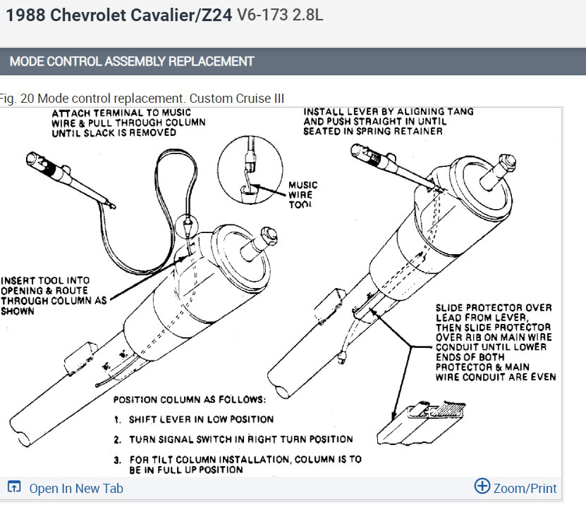

Hey, I was just wondering if anyone knows how to replace the turn signal lever on the car listed above?
Oct 21, 2024 at 2:34 AM
  • 55,433 POSTS

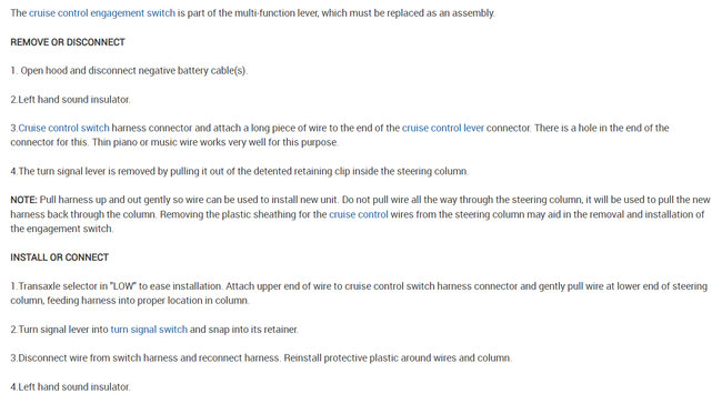

Sure, here are the instructions on how to replace the turn signal switch lever. I would use a string to attach to the wiring so you can pull the new wiring through using the string you attached to the old wiring before you pull the old wiring through the steering column. Check out the images (below). Let us know if you need anything else.
