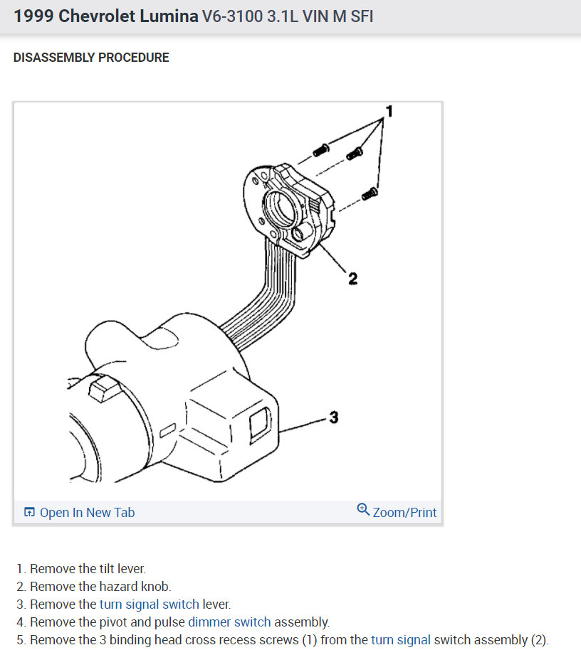

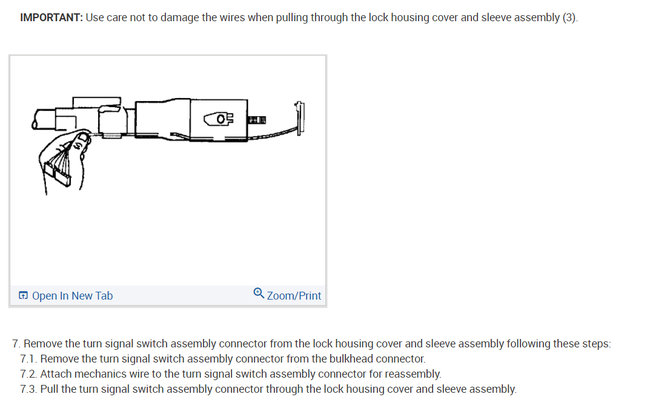

The turn signal lever won't move to make the turn lights work. What part do I need to replace. Is it the piece in the middle of the steering column.
Feb 27, 2021 at 11:18 PM
  • 55,816 POSTS
You will need to remove the steering wheel before you can get at the turn signal switch. here is a guide to help with instructions for our car below. Check out the diagrams (below). Let us know what happens and please upload pictures or videos of the problem.
