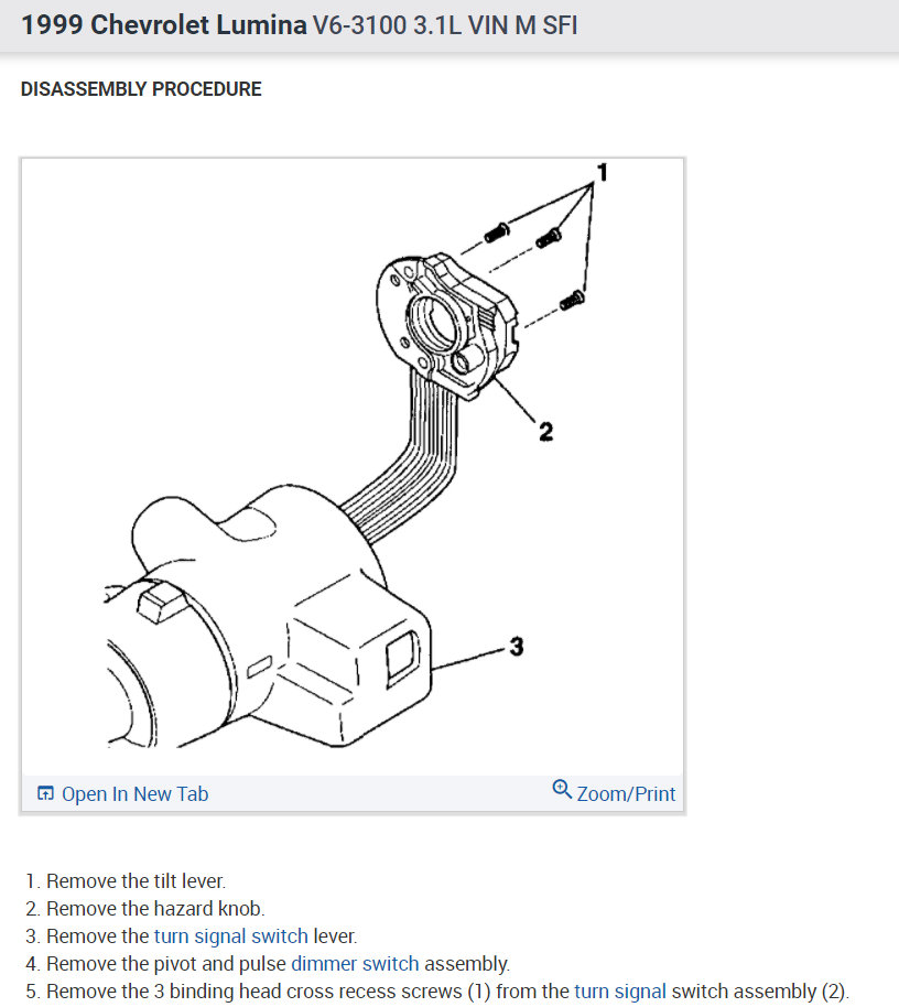

The turn signal lever won't move to make the turn lights work. What part do I need to replace. Is it the piece in the middle of the steering column.

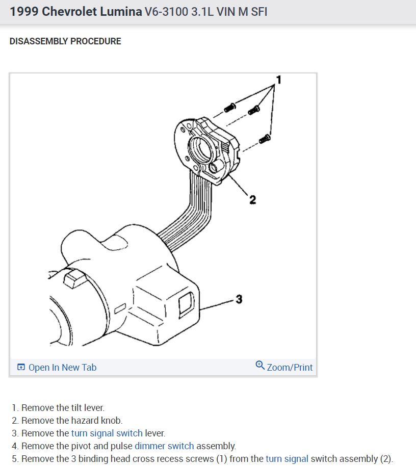

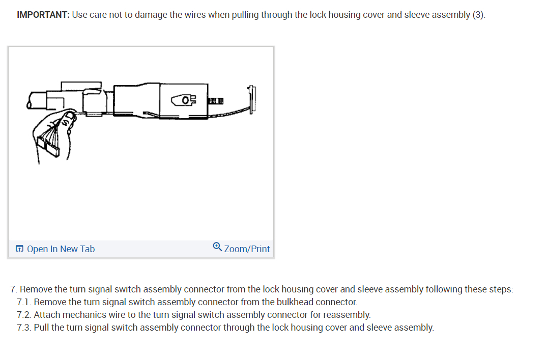

You will need to remove the steering wheel before you can get at the turn signal switch. here is a guide to help with instructions for our car below. Check out the diagrams (below). Let us know what happens and please upload pictures or videos of the problem.

Thank you so much men. it's much appreciated, but I won't be doing too much work for a few more days my disability is kicking my butt. But yes I'll take pics and a video to help out others too.
Mar 1, 2021 at 11:05 AM
  • 55,297 POSTS
I hear ya, let us know if you get stuck, we can walk you through it.
