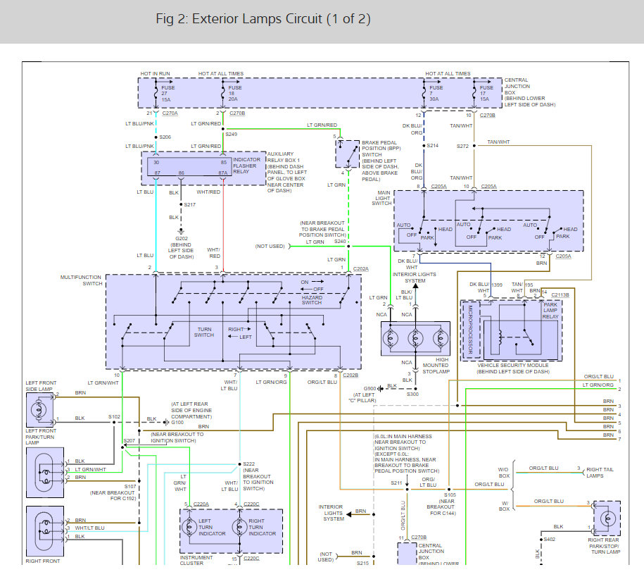

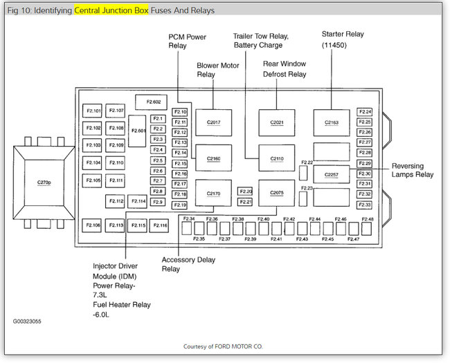

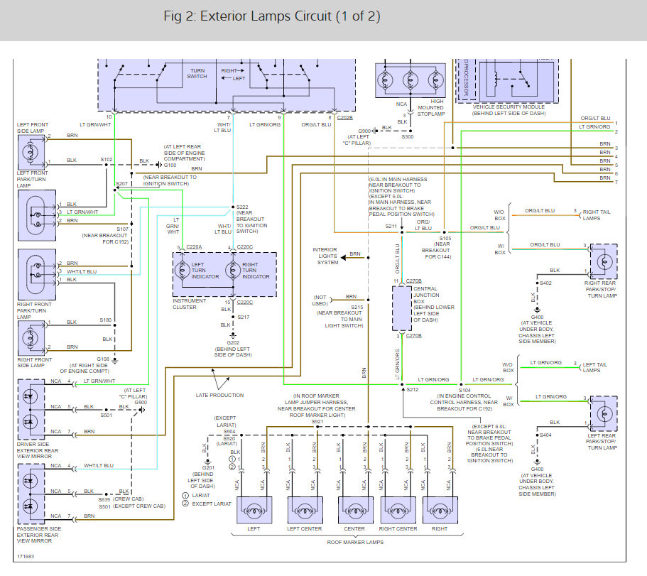

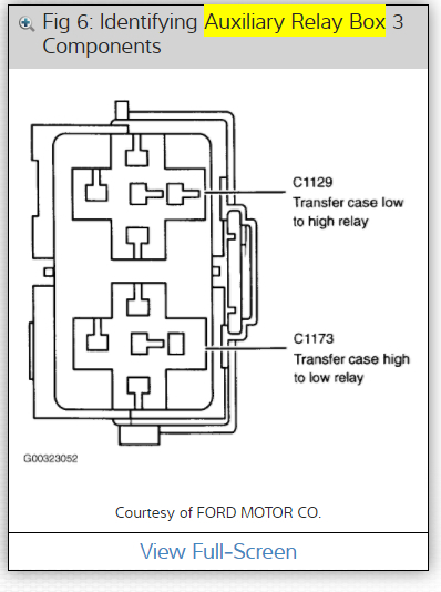

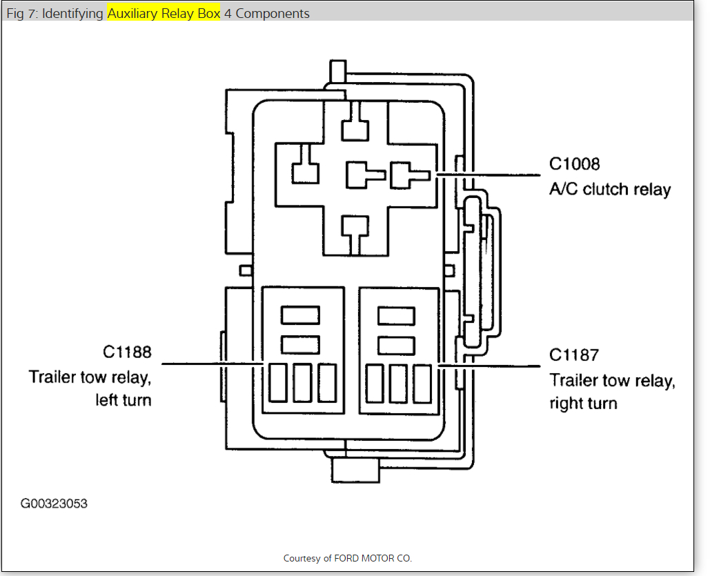

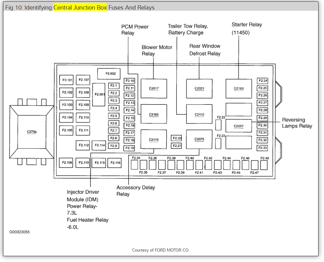

I replaced the turn signal switch, relays and verified fuses are good. No turn signal. When the turn signal is activated, the rear right on the side that should flash, goes out.
Advice please
Jan 9, 2018 at 11:45 PM
  • 55,433 POSTS

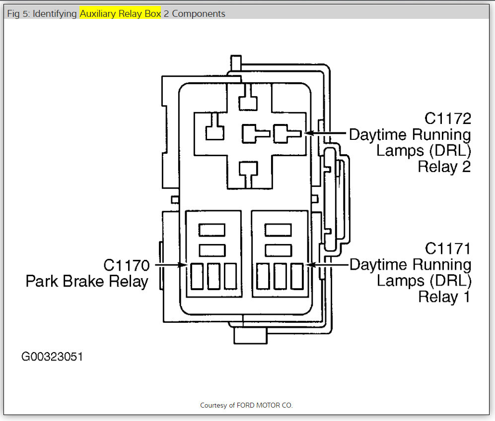

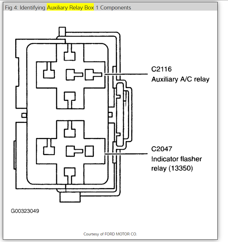

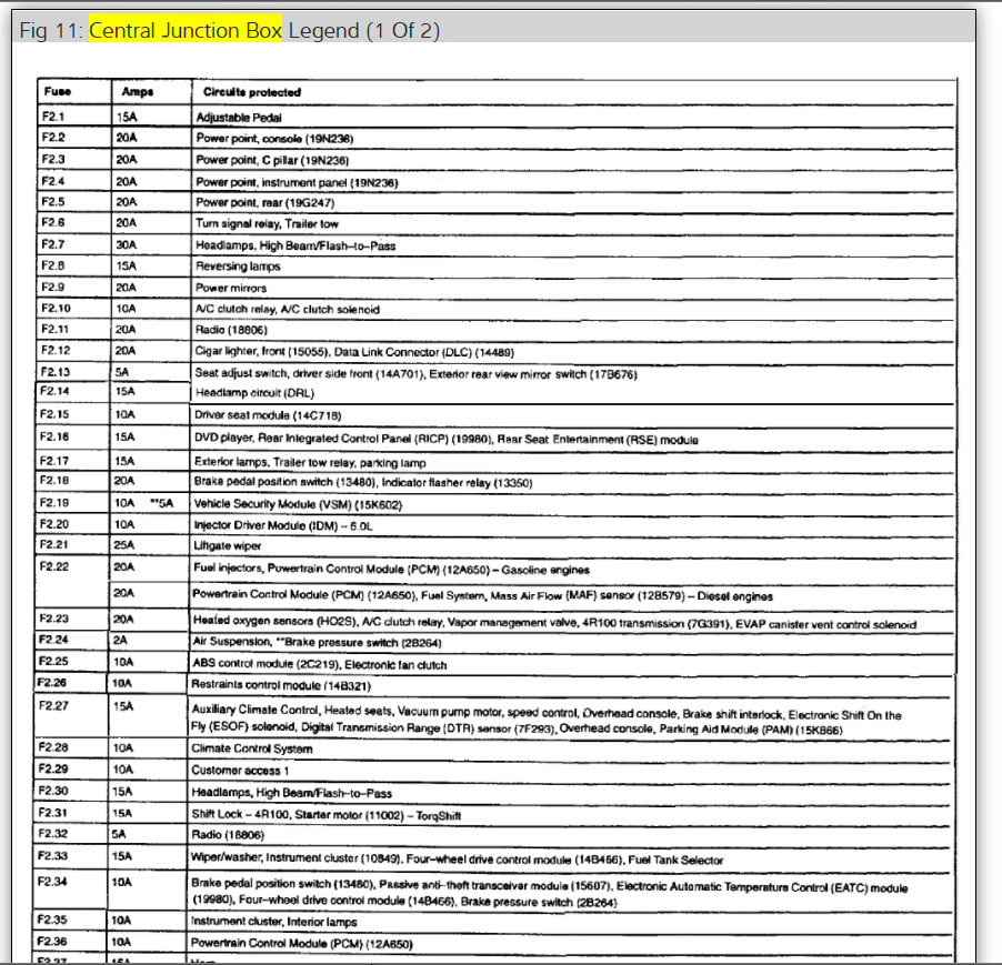

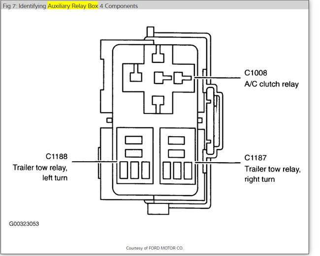

This sounds like you have a bad ground somewhere. Here is a guide and the blinker wiring diagram for your F450. Also, check the indicator flasher relay.
and
Please run this test and get back to us.
